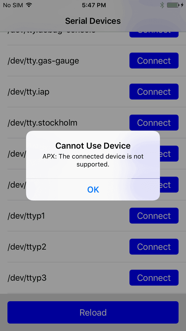

Sorry for late reply.. was coding and reading: https://www.theiphonewiki.com/wiki//dev.. I jailbroke an old device I had lying around to see if it'd make a difference.. I can connect to other devices but again, I can't seem to find the "Nintendo Switch" (connected via USB-C-to-Lightning)..
The code is below (Languages are C++ & Objective-C++ for Serial.mm, Objective-C for Serial.h, Swift for ViewController.swift):

Screenshots:
https://i.imgur.com/GgTFV3f.png
https://i.imgur.com/PzM5v9U.png
https://i.imgur.com/Wy32uW5.png
https://i.imgur.com/4coSFep.png
If someone knows which of the above ports the switch would be on, I'd gladly connect and write something to upload the payload as I can communicate with any device.. I just don't know enough to continue atm (yet)..

Sorry for late reply.. was coding.. I jailbroke an old device I had lying around to see if it'd make a difference.. I can connect to other devices but again, I can't seem to find the "Nintendo Switch" (connected via USB-C-to-Lightning)..

Screenshots:

So I got it to detect the device:
APX is the Nintendo Switch.. Shows up as unsupported accessory atm.. Now that it's detected, I might be able to connect via EASession (so far no luck but I think I'm missing something)..
I am literally getting no love with TTY connection though (Serial Port).
