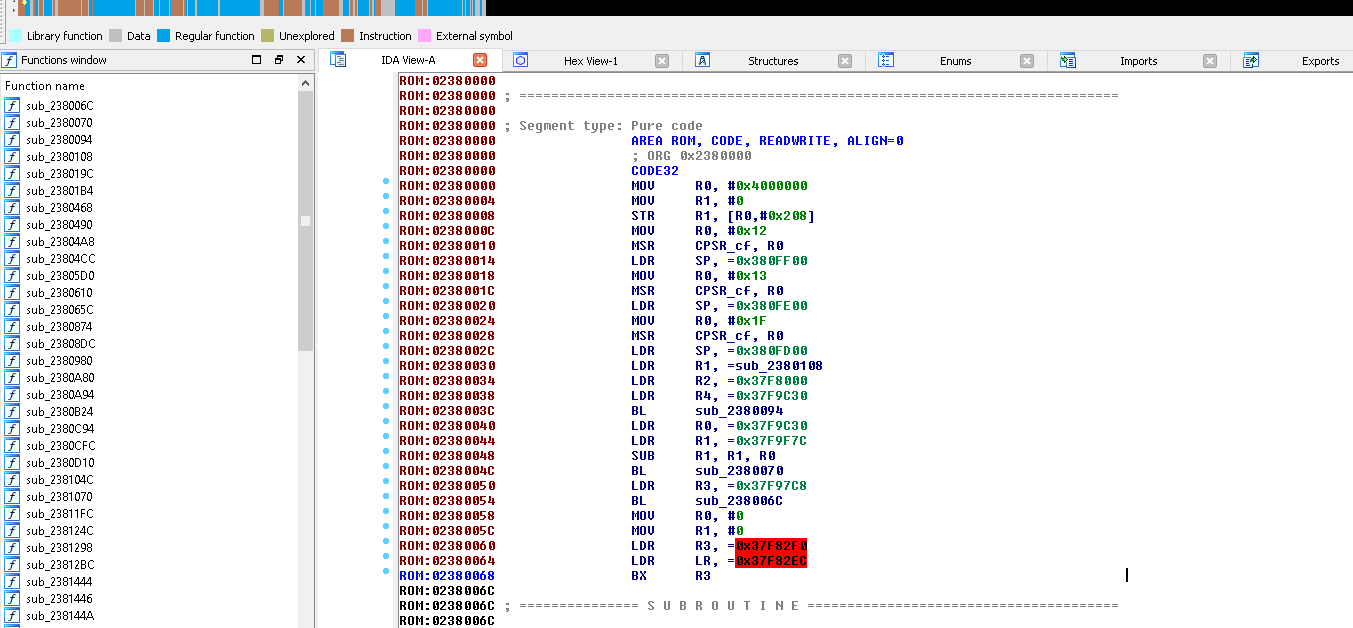

I am researching some stuff, and I updated this tool:
https://bitbucket.org/Coto88/ToolchainGenericDS-ndstools/get/HEAD.zip
/release folder has a binary precompiled so you can run it in the DS through SLOT-1 cards.
From readme:
Button (Start): Basic file browser. -> Supports compressing(slow)/decompressing LZSS files. (NDS Bios native compressor/decompressor) -> Allows to extract a (homebrew) NDS Binary, and a logfile with specific details around these binaries (you can rebuild a NDS Binary with these)
So basically you copy your NDS Binary, execute this little tool and you'll extract an ARM7.bin, ARM9.bin and a logfile pertaining details of each ARM settings out of such NDS Binary (of which you can re-use to reassemble it again).
This will export the addresses (and other stuff), required by each binary, required by the homebrew header.
Log of r4igold.cc's _DS_MENU.DAT
0://_DS_MENU.DAT Sections:
[arm7.bin]:arm7BootCodeOffsetInFile: 0x5f400 -- arm7BootCodeSize: -> 7480 bytes [@ EntryAddress: 0x2380000]
[arm9.bin]:arm9BootCodeOffsetInFile: 0x200 -- arm9BootCodeSize: -> 389408 bytes [@ EntryAddress: 0x2000450]
And by following ARM7 Binary EntryAddress I could open the crt0 section disassembled:
Which makes sense.
