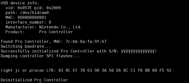

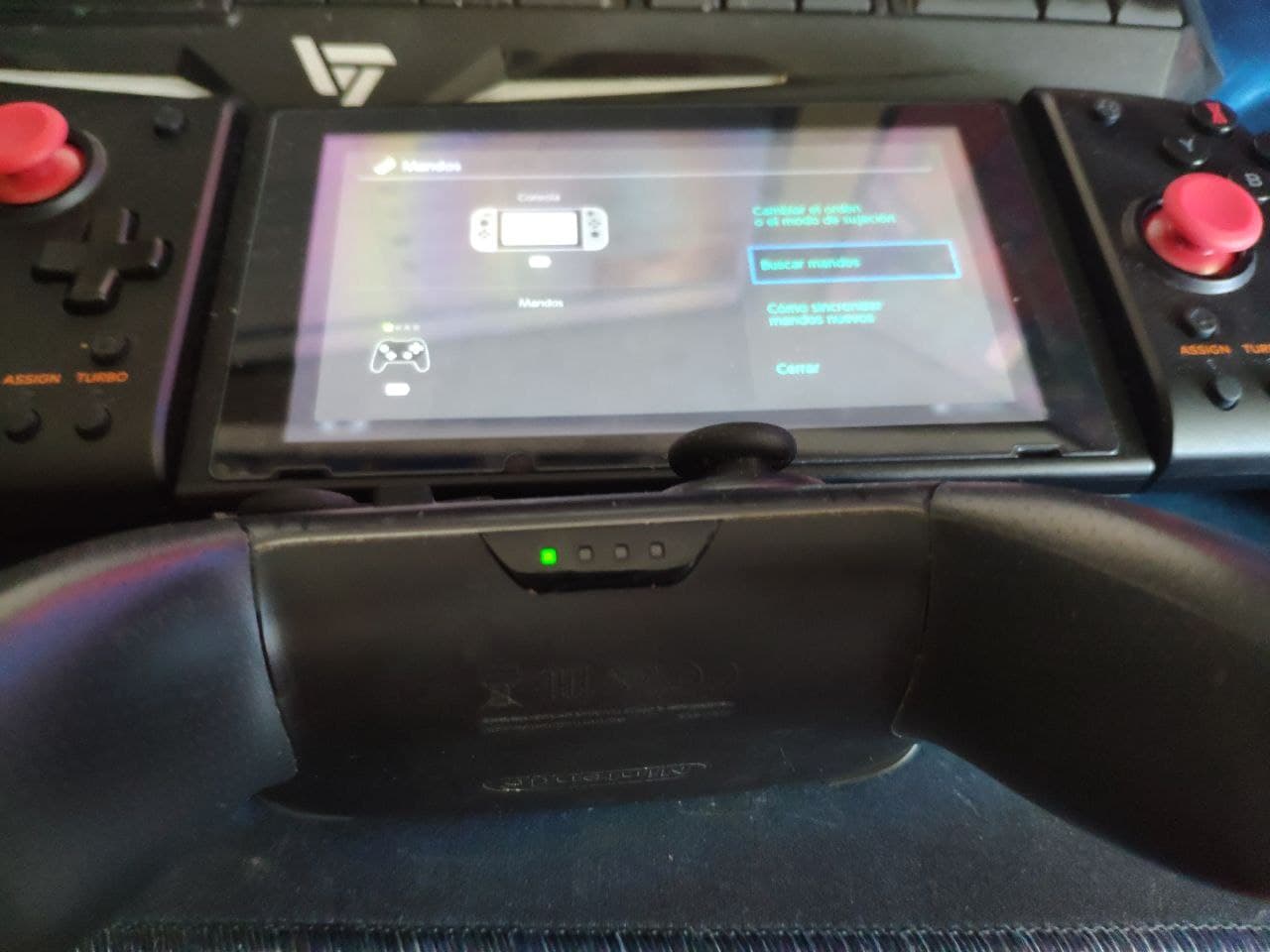

1. The Pro Controller connects with HOS without any problem.
2. Android settings and 'get_jc_procon_ltk' output

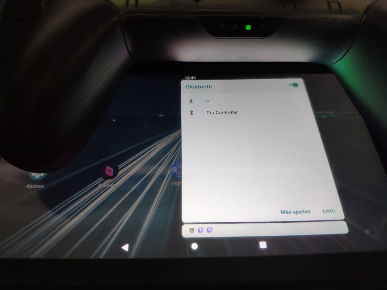

3. Pro Controller not connecting to android (led flashing)

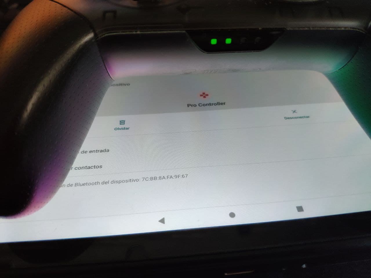

Ok, I think I've found the culprit, that's an incorrect MAC address, try running "get_jc_procon" multiple times, it'll give you incorrect mac on first attempt, but on second run it'd be different number, 98:b6... (hopefully(bc it does that on my machine)).
Other way to know MAC is pair controller to android and check device details in bluetooth settings. Mac address should never change, so you have to look it up only once. Don't forget to unpair it afterwards.

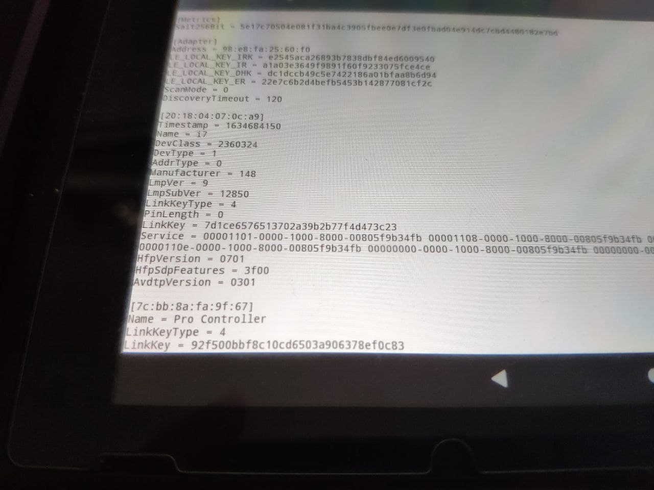

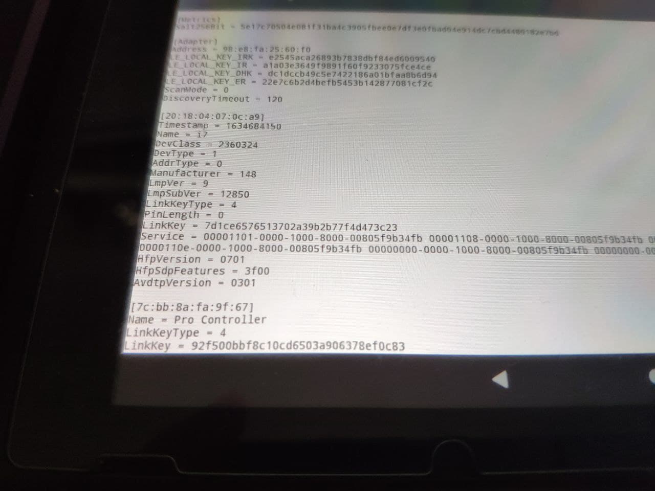

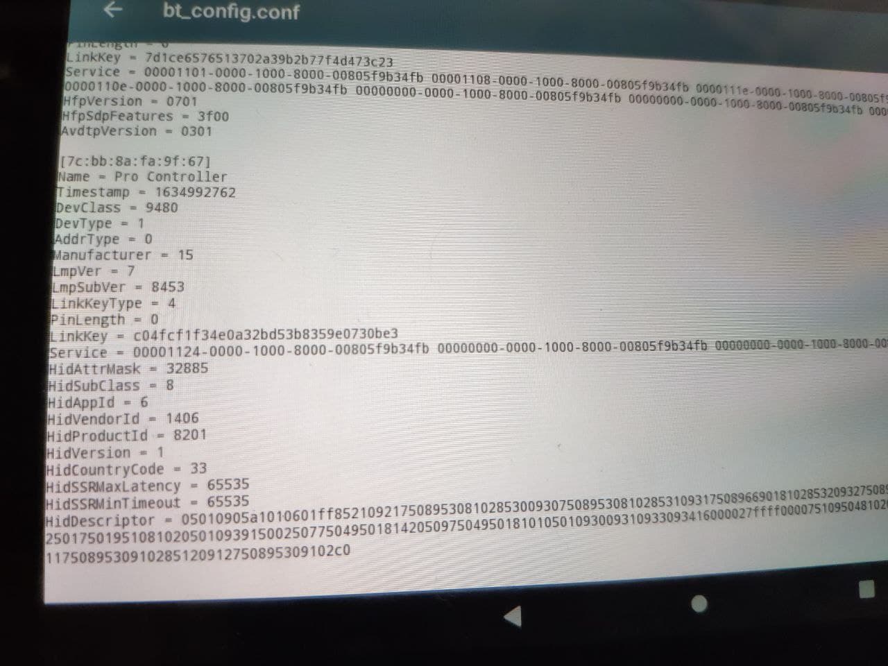

Think that's not the case. I've just paired it with Android, and the MAC is corrent, I let you see the config now autogenerated by Android pairing.
Tested whole tutorial once more. It does work. Only difference I see is your config lacking joycon lines generated by Hekate.
I really doubt it's the issue, but you might try dumping "joy-con bt" in Hekate nyx options (with (or without) official joycons attached).
Well, that did the trick :rofl:. I've dumped Joycons via Hekate -> NYX (never did), and right then it worked, so I guess there must be some kind of relation with what Joycons dumping does and this tutorial.
