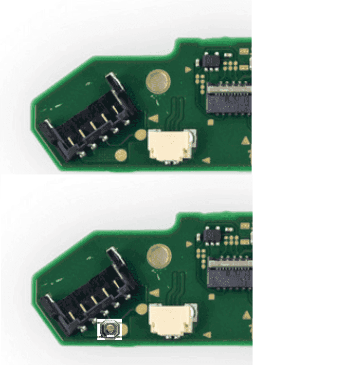

Doing this mod tomorrow...
1) Break negative trace on board going from battery
2) Solder PTB microswitch (push to break) across negative traces you broken in step 1
3) Drill 1mm hole in switch casing above the PTB microswitch...
4) Perfect reset hole simulating a battery pull when switch is pressed and negative connection broken. "reset with paperclip" type jobby
Nice and easy. Will do a write up tomorrow if I remember with pics if I get time.
Pic below gives you an idea. Need smallish soldering skills. I find it easy been doing it 30 years but if you are new to soldering you may fook it.

@t34p075
Not many people would be willing to do this method because they aren't experienced with this type of modding. In my opinion, I rather wait patiently for a software fix.
(Cool method though, thanks)

@t34p075
Thanks for the write up. With my luck I’ll screw it up, but that’s very clever.
