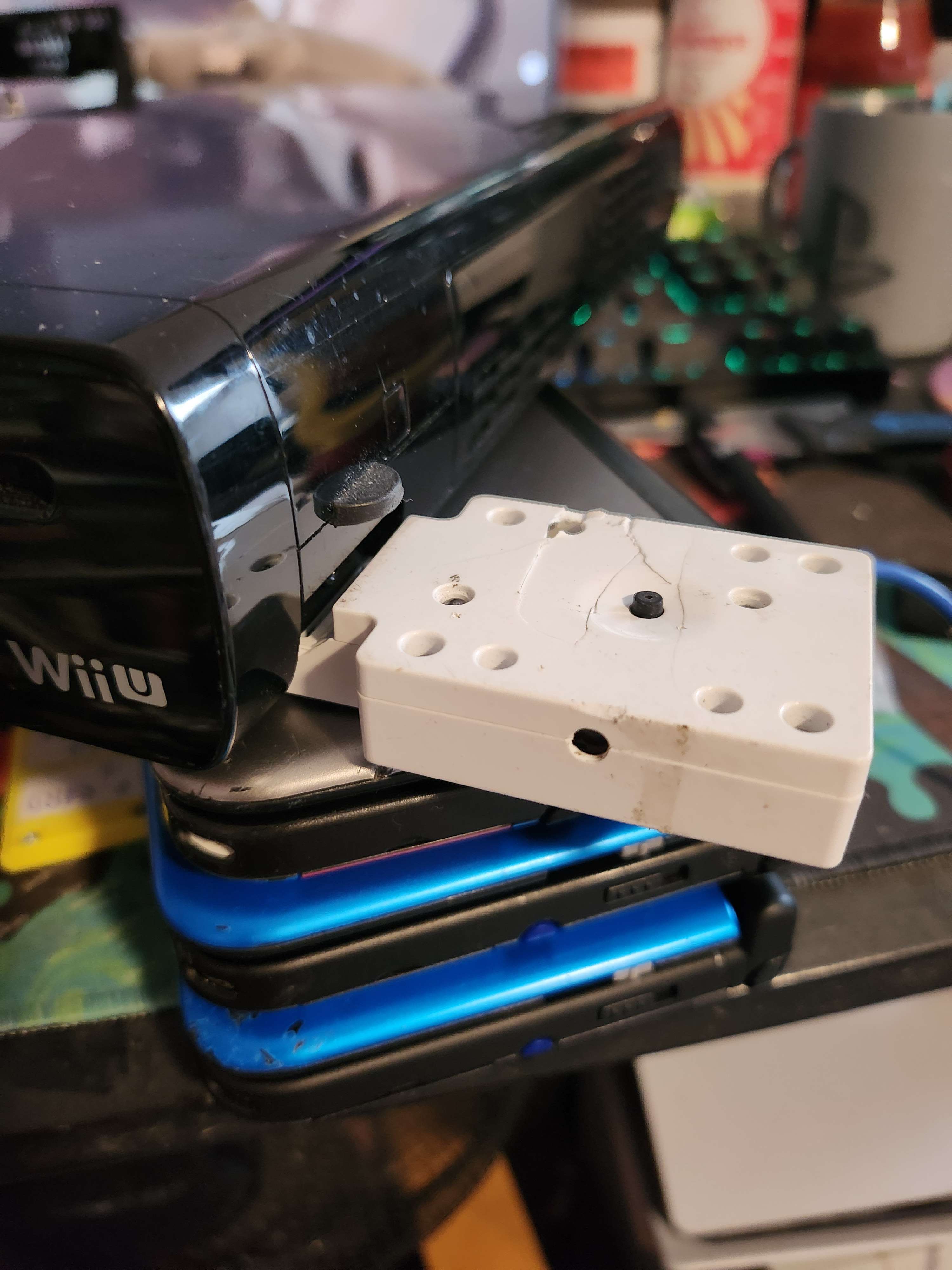

Recently, a bunch of Nintendo factory GCN memory cards, SD cards, and "battery jigs" were obtained from various sellers. The "battery jig" was the most interesting bit, since it plugs into the Wii U's clock battery slot and injects a signal into TP73. It turns out this signal is what sets the "UNSTBL_PWR" flag, which is most likely how Nintendo's authorized repair centers repaired broken Wii Us. But there's more to getting it to work than just setting the flag...
A Wii U with one of the original battery jigs inserted in the clock battery slot. Photo provided by Kelly.
