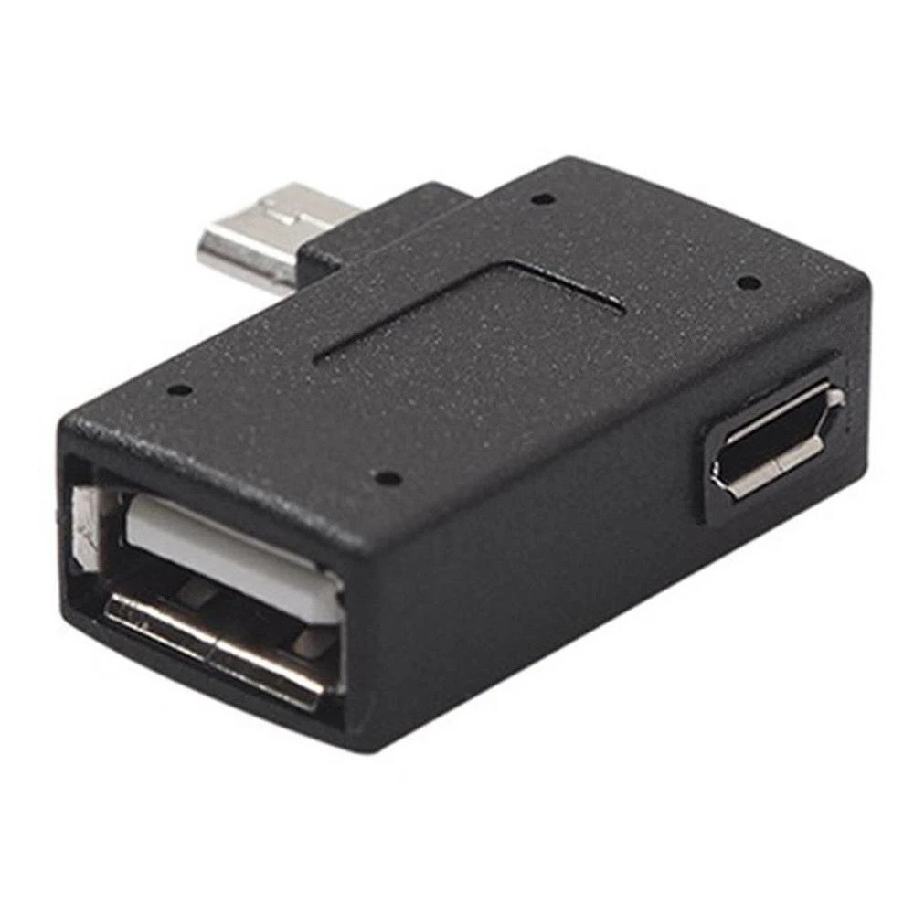

An Adapter like this, you can get them on aliexpress:
https://www.aliexpress.com/item/100...0!sea!DE!828381341&curPageLogUid=BaMiWvJSgeTc
Reactions: Windows_10_User
This Adapter is useful because you need to provide power to the PS Classic.
You could also use the front USB but then one of the ports can't be used for a second Controller and it looks neater with the OTG Adapter I showed you.
Of Course you need the correct angled one, there are 2 different once and only one of this is suitable, the other one would block the HDMI Port.
I think left Bend is the correct angled one.
I recommend checking the Connector on the PS Classic and compare it to the Pictures in the Reviews, there is also mentioned above the Picture which one the specific Customer Ordered.

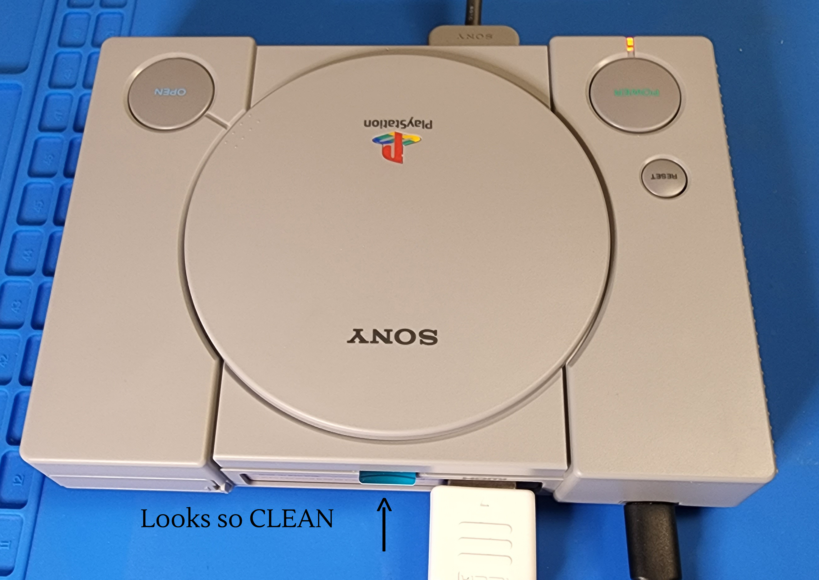

Honestly, if you want it to look clean and can live with having to swap SD cards or limiting yourself to the capacity of a single SD card you may prefer going a route similar to what I did... tho you COULD fit a 2.5" drive in here as well, it just wouldn't be easily removable.
Full picture guide

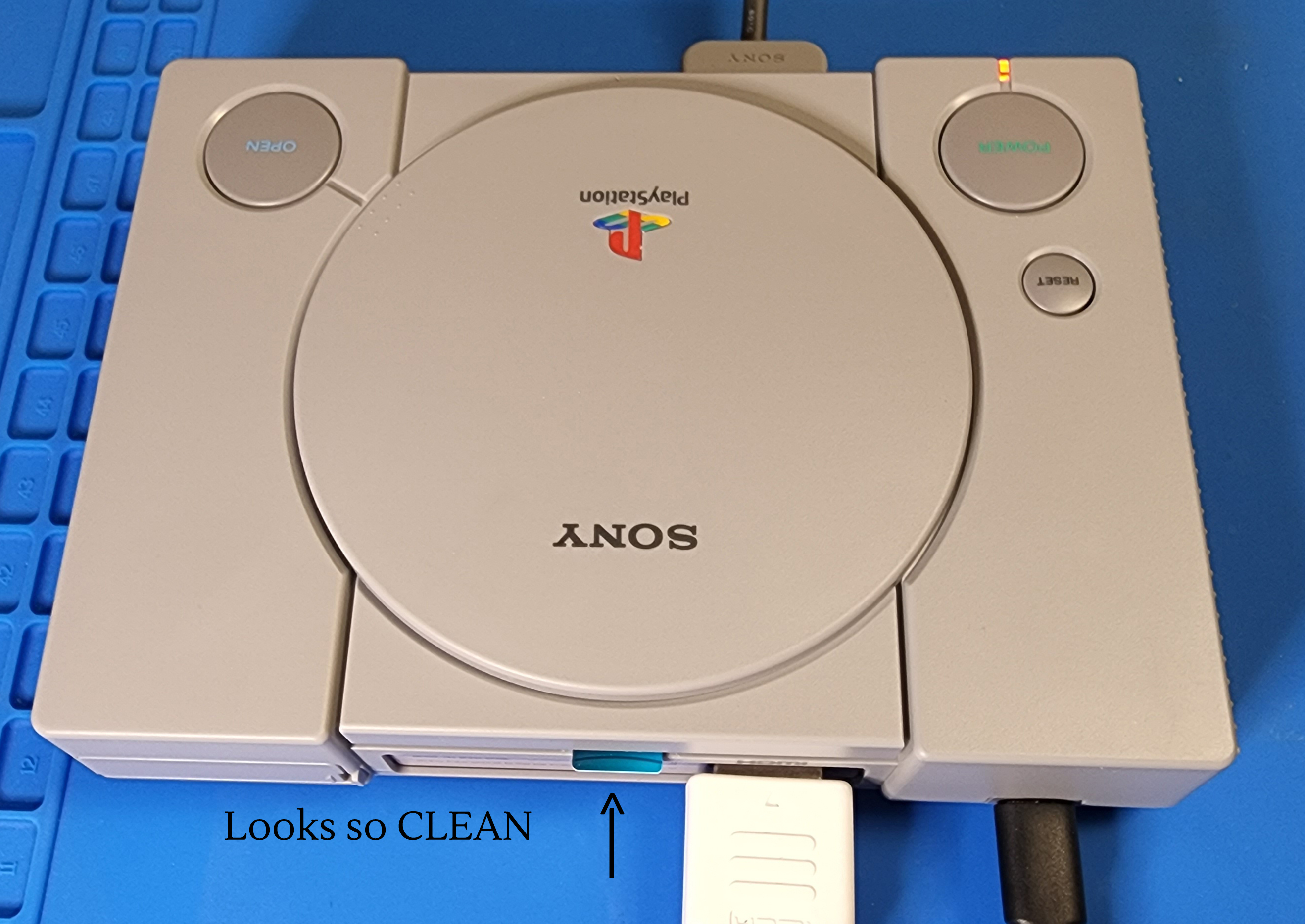

Full picture guide
That's way too hard for me and I want to use an external HDD, not an SD card. Also, I thought 2.5" external HDDs had to be connected to the PSC's Micro USB port via OTG cable.
