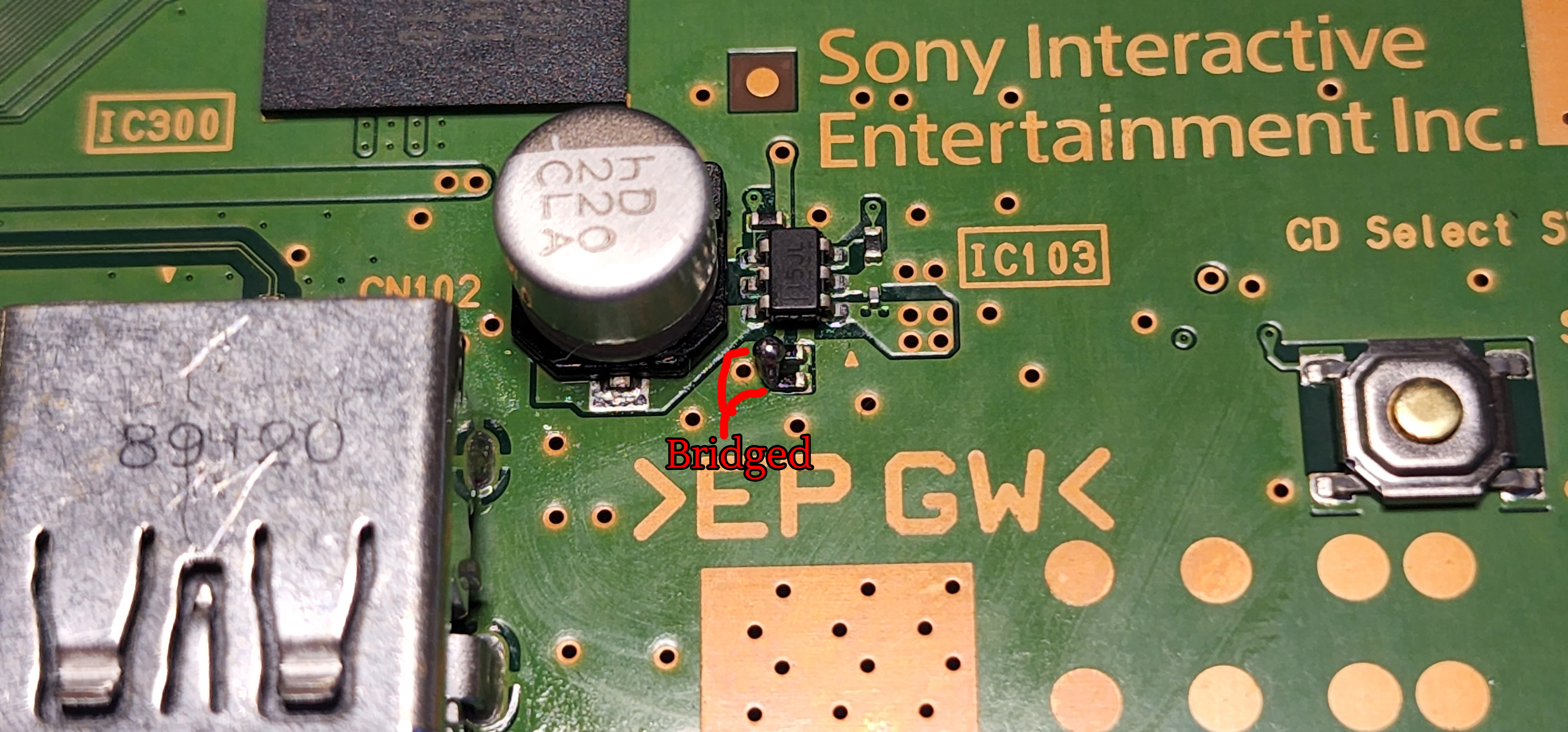

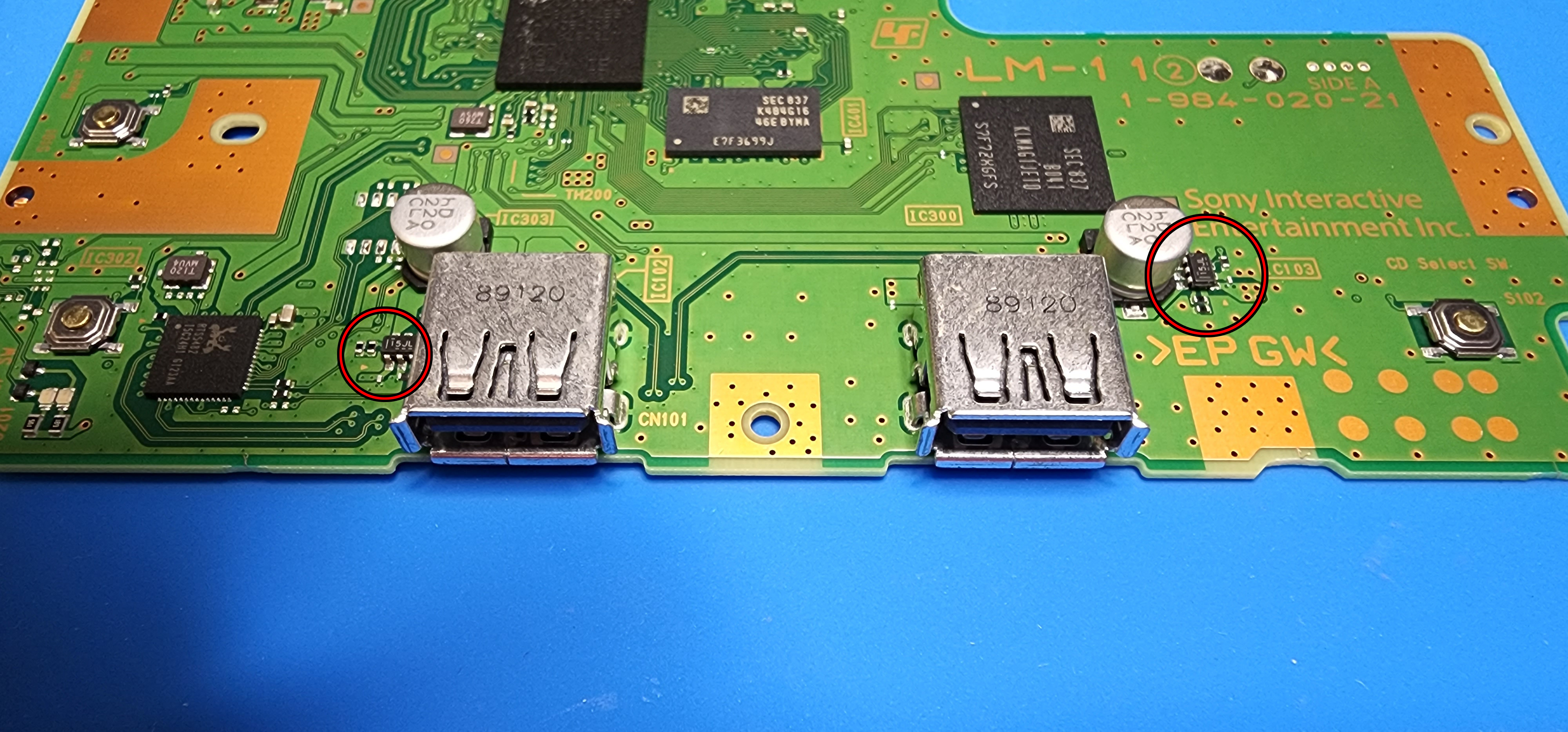

If you don't do the current limiter mod the front port won't work with the 1tb drive. That why there is a compatibility list for usb thumb drive due to the 100mA current limit the manufacturer set. Some hard drive has how much amp they need specified on the drive.

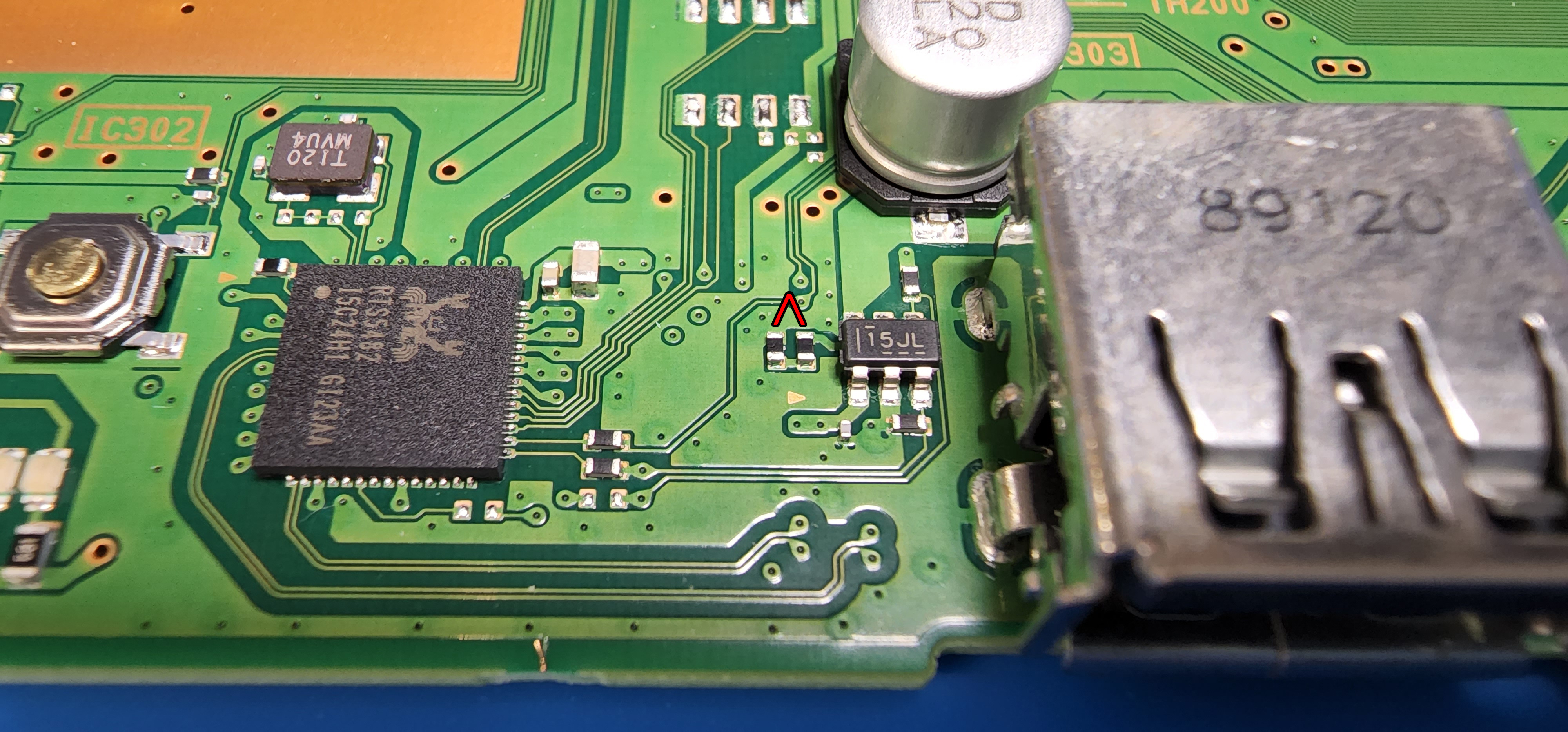

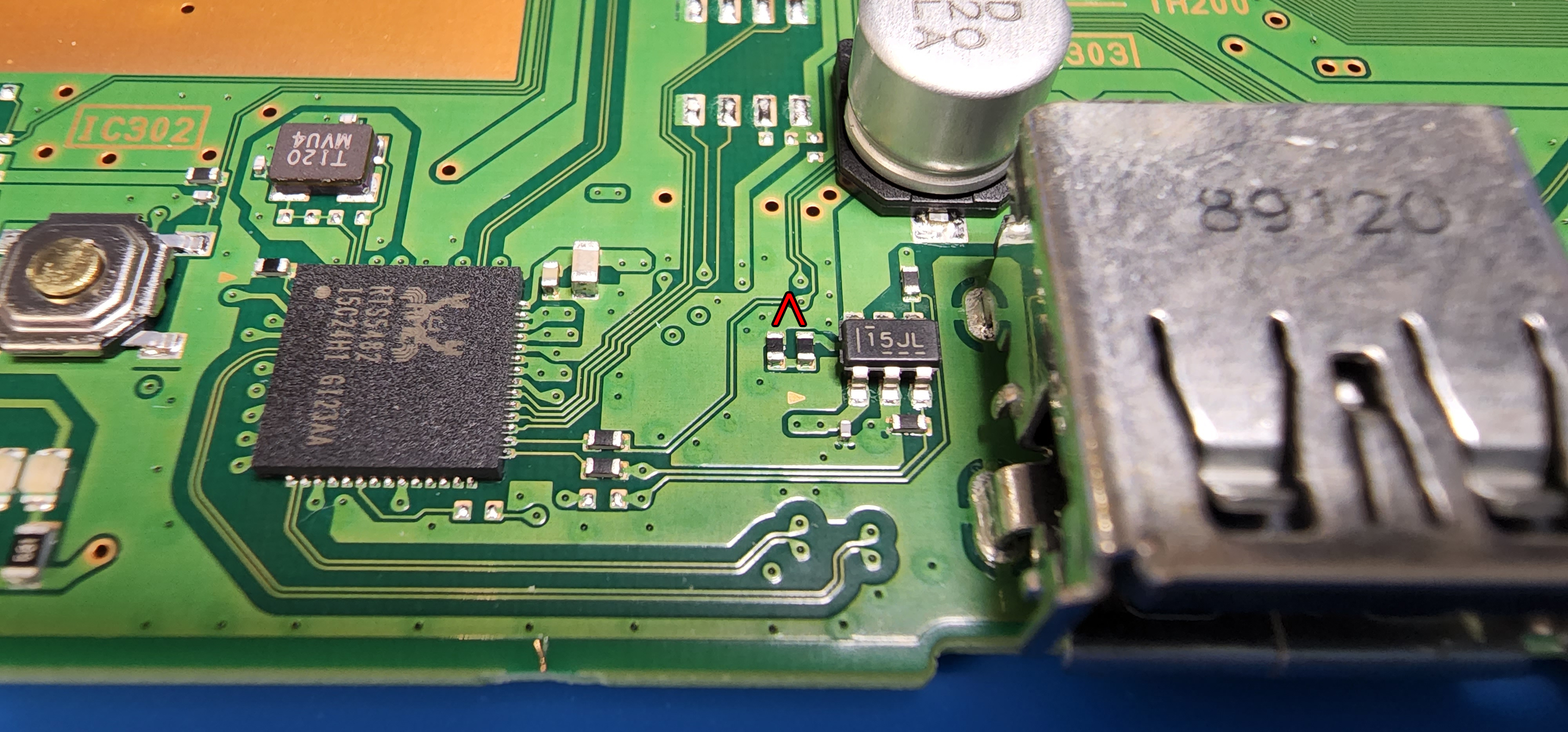

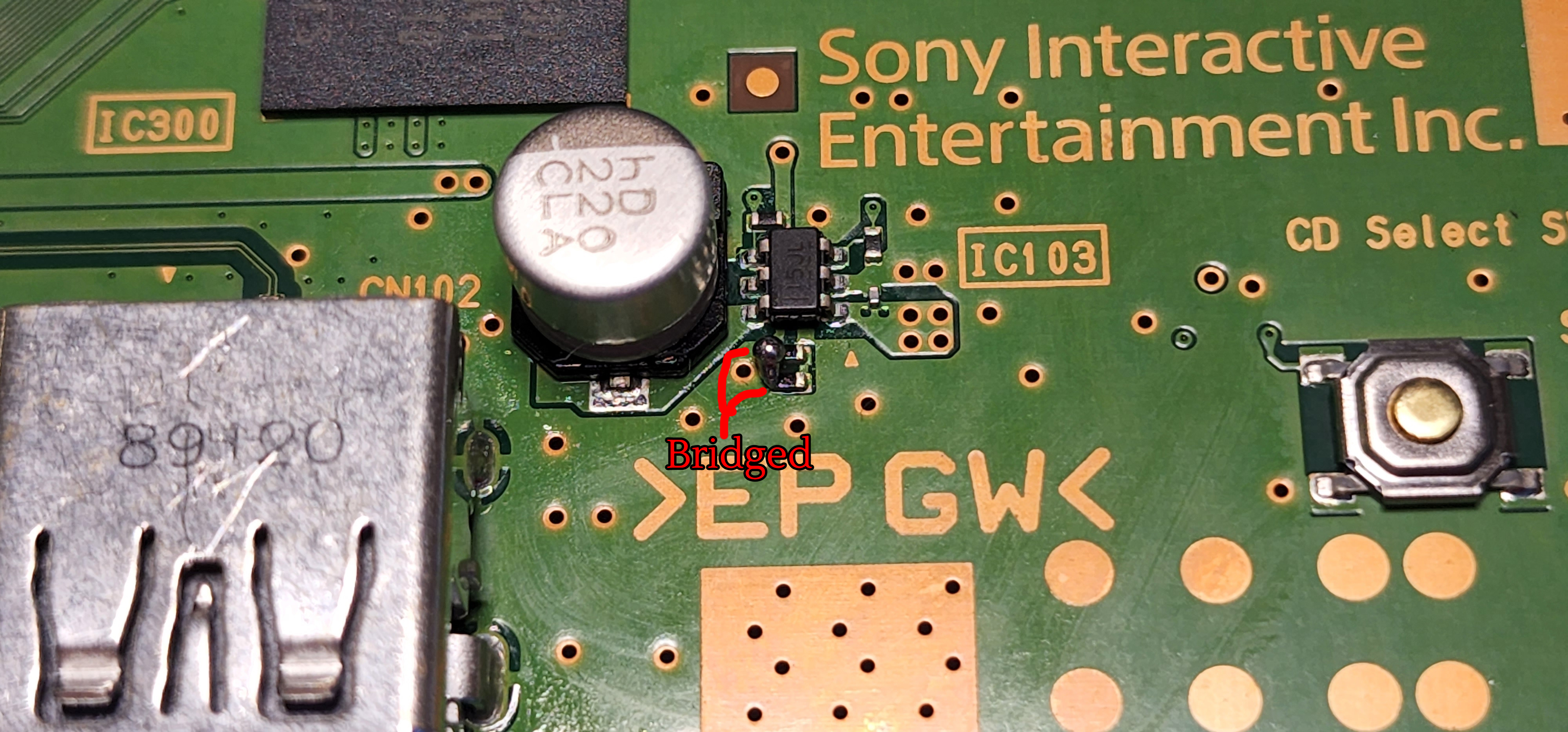

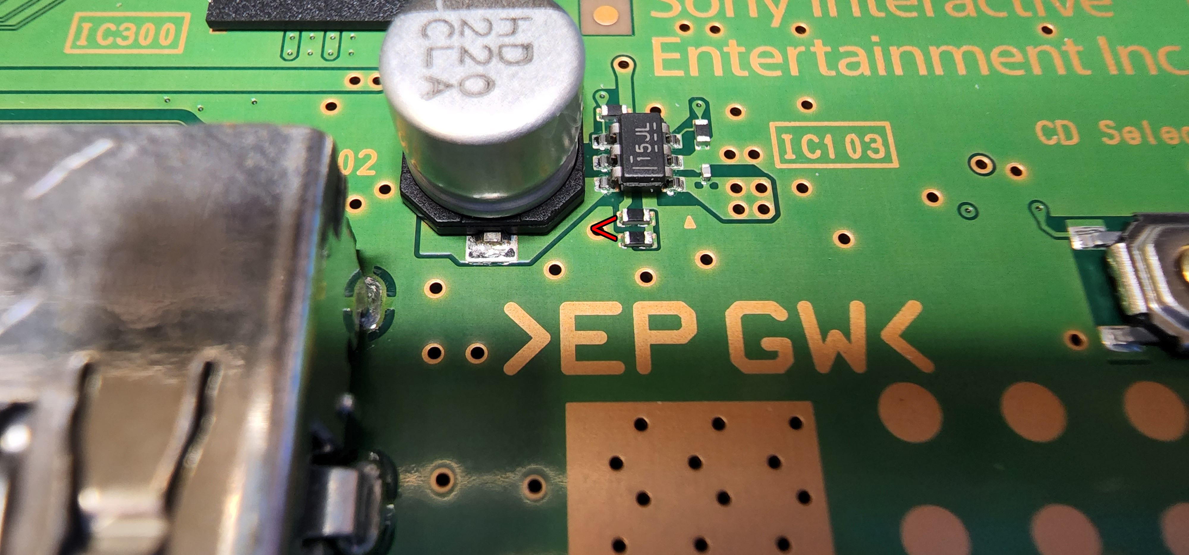

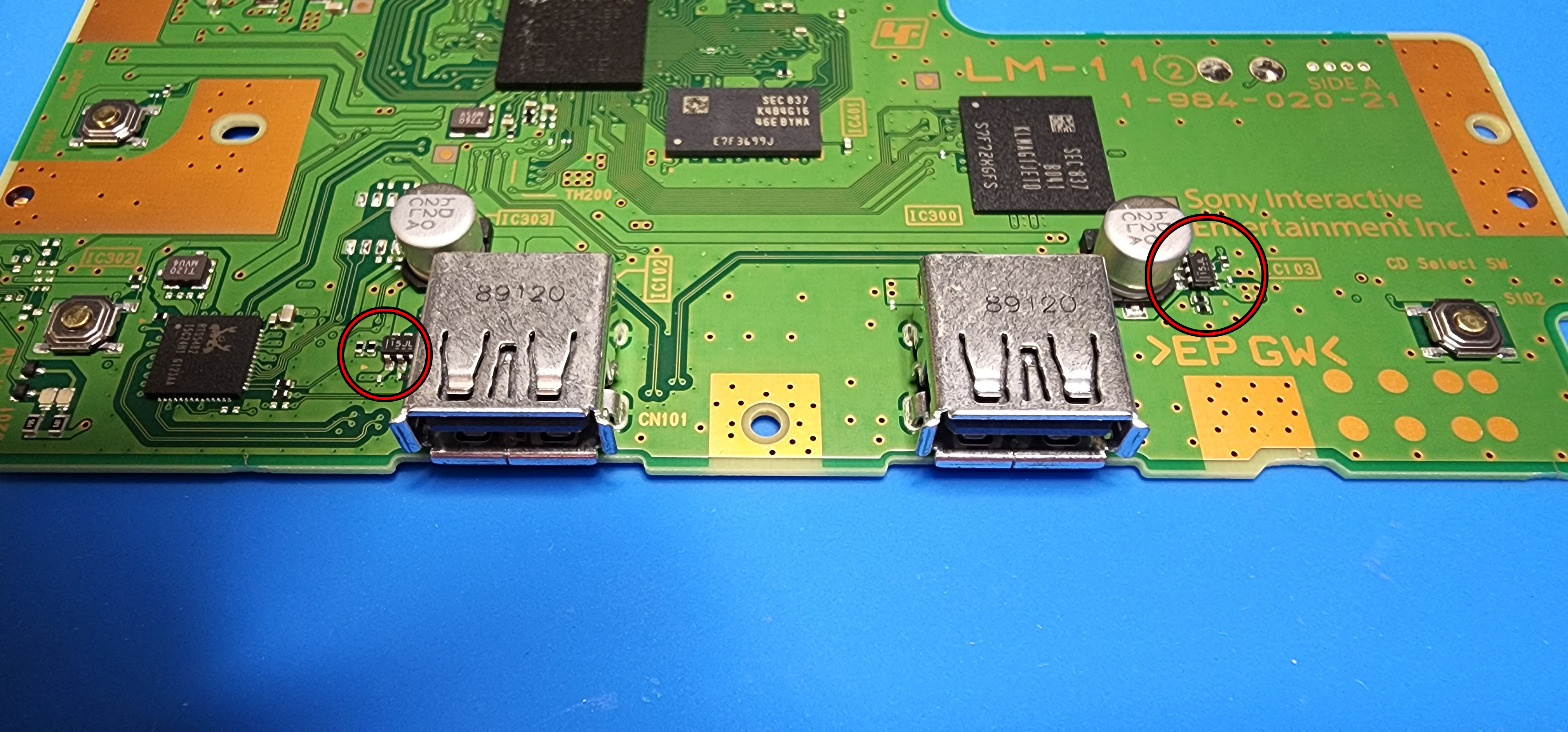

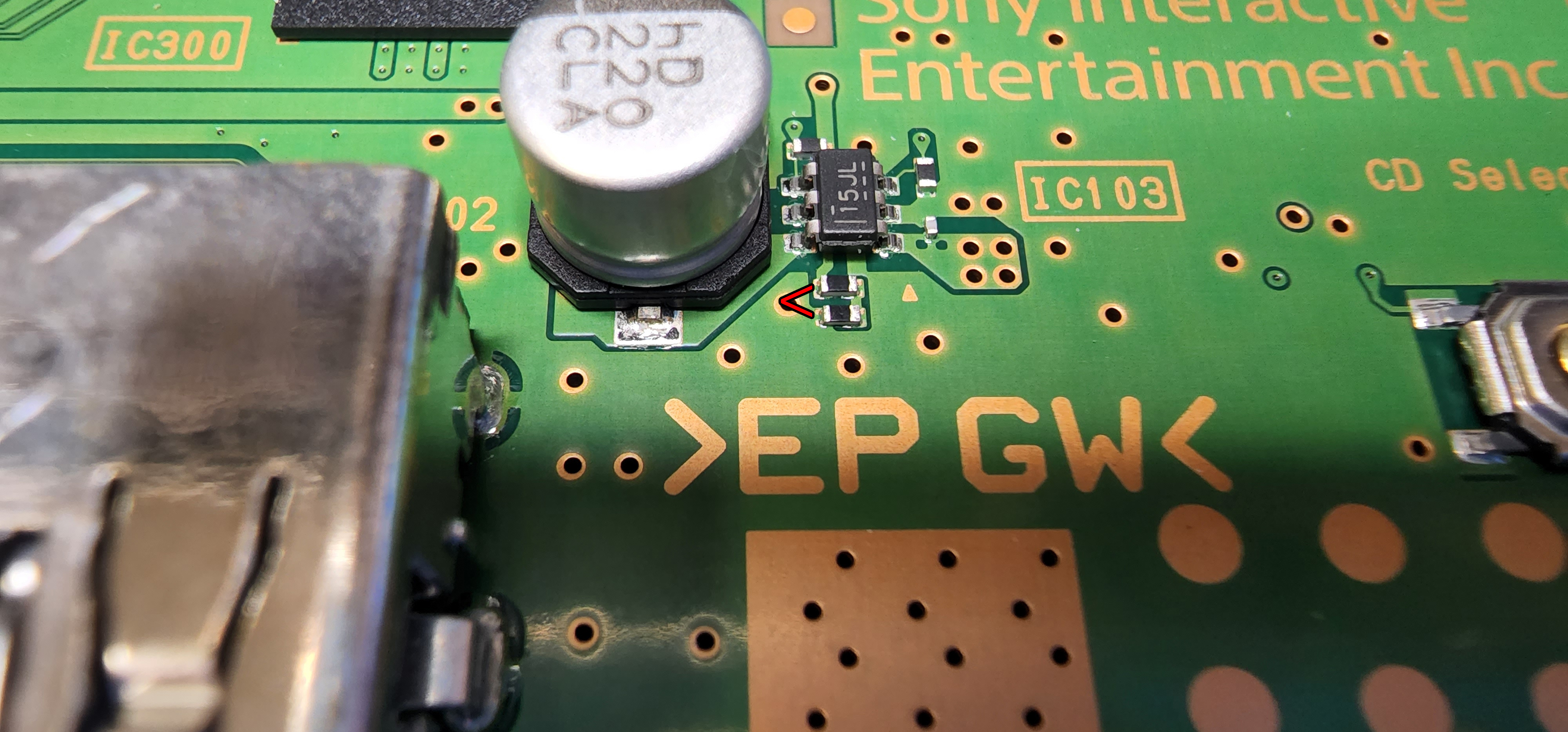

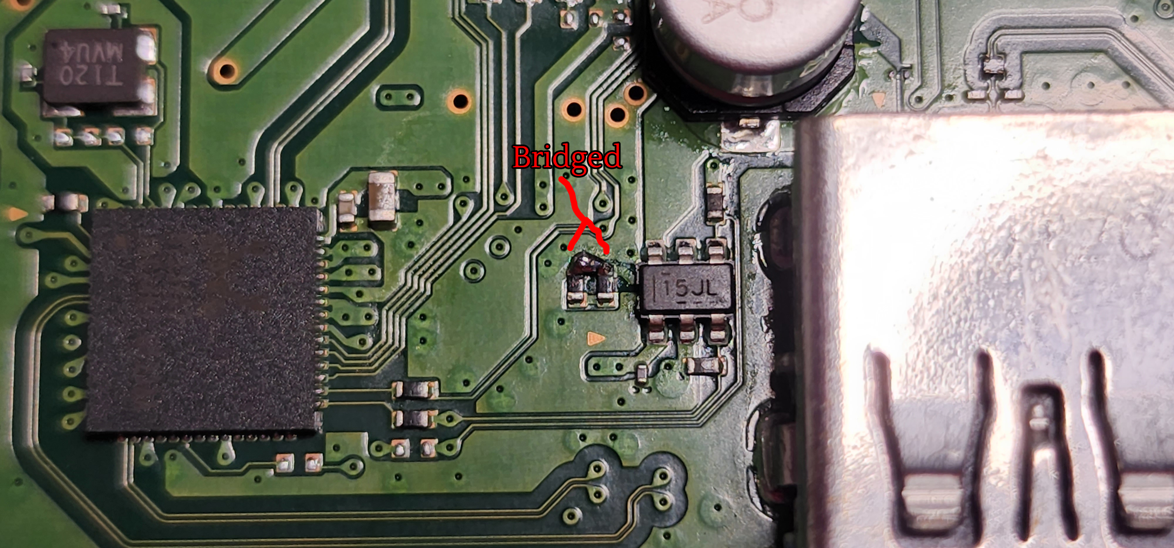

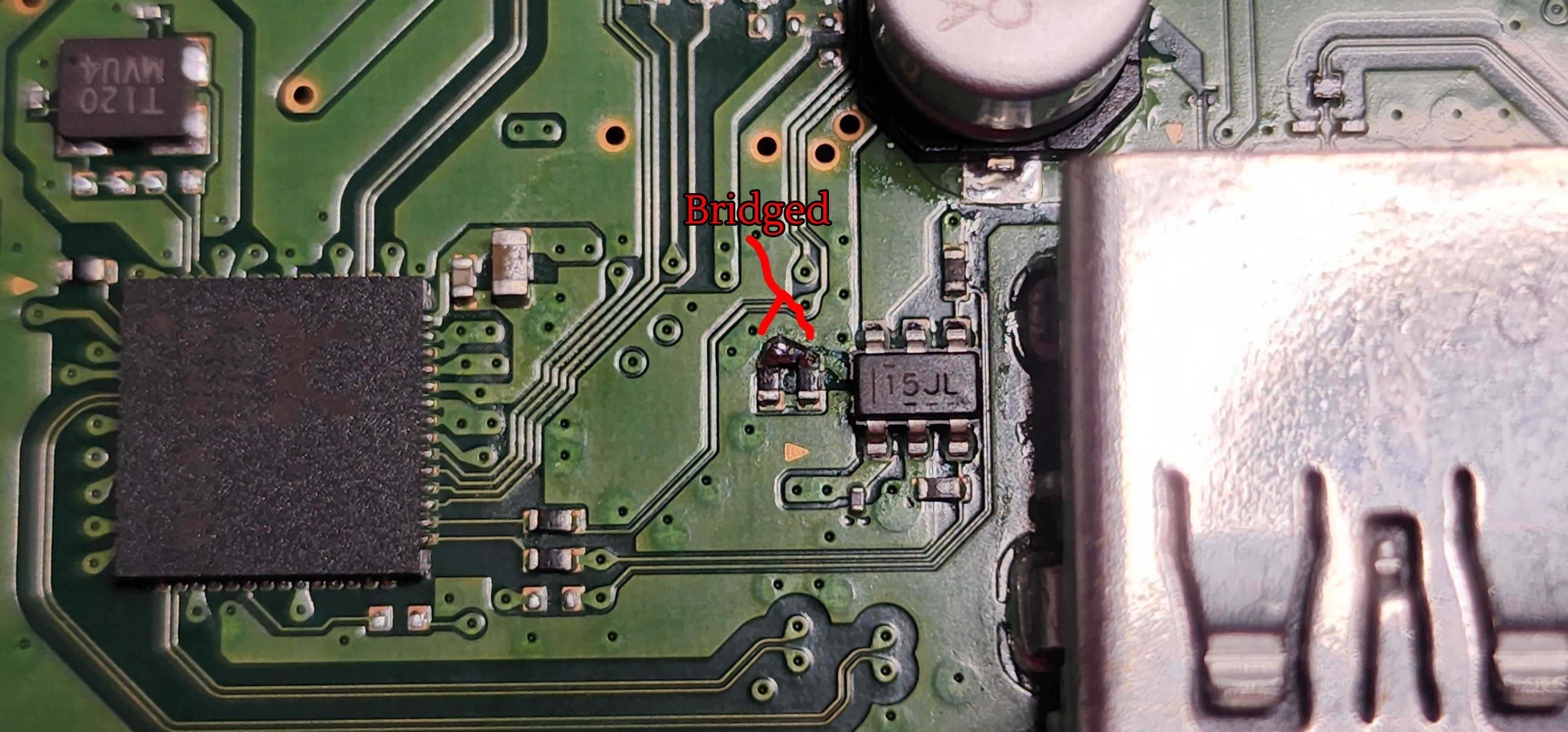

If you own a soldering iron and have ever used it for ANYTHING you can do the power mod to both front ports in under 60sec after you get the device opened. It's literally a matter of dropping a blob of solder to connect two neighboring points - once for each USB port and you don't have to do both.
That said you can use an OTG cable and not need to hard mod it at all.
Here is the power mod in pictures:

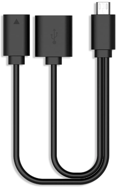

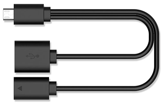

If you go the easy route and use OTG, I personally prefer this style of cable since it can look basically stock if you tuck the HDD/SSD/Flash drive somewhere out of sight.
Link to Amazon listing

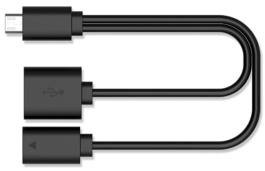

The OTG cable need to be connect to the where the power cable is connected, not through the front, the front is limited to 5V/100mA without doing limiter mod.
Which power supply should be bought to connect to the OTG cable? According to what I read, 1A isn't enough to power the external HDD and 2.5A is needed.
Which adapter should I buy to connect the OTG cable to (which in turn will be used to connect the PS Classic's USB cable and the 2.5" 1 TB external HDD)? According to what I read, 1A is not enough to power the external HDD and 2.5A are needed.
Any OTG cable is fine as long as it has a Female Micro USB in ( for power), Male Micro USB (to PS Classic) and one (or more) Female USB-A for the storage device. If you use a mechanical HDD that needs extra power, then you upgrade the power supply that will be powering both your PS Classic and the storage device. 5v 3a would be recommended for a spinning/mechanical 2.5" HDD.
I personally prefer this type of cable since it allows hiding the HDD and power cords easier.
Rii F1 Micro USB Host OTG Adapter​
Reactions: Windows_10_User

There is nothing to worry about unless the power supply is junk (tho a low amperage one that is junk is just as dangerous). As long as it is a 5v power supply that meets the minimum amps you need you are fine. The supply could be 5v 10a and it won't hurt your HDD or PSC. A power supply's amperage is the MAX it can provide. It doesn't force the full amount to your devices. There is ZERO harm in having extra amps available.
Your only concerns should be if it is a decent quality and that it is ONLY 5v, not 5v & 9v or 5v, 9v & 12v like QC 2.0 and QC3.0 chargers are.
