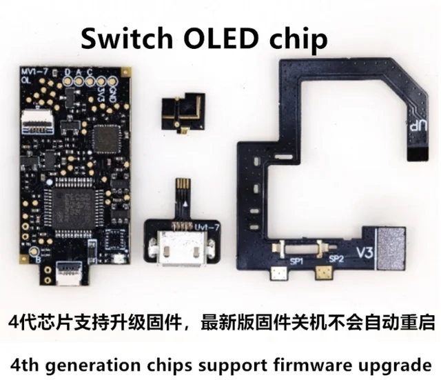

Here's a photo of V3:
And this is V4:
Hwfly-for-Nintendo-switch-lite-oled-core-chip-ic-chip-cable-black-board-payment-for-sx.png_640x640.png
You can easily tell them apart by the ribbon connector at the bottom.
And this is V4:

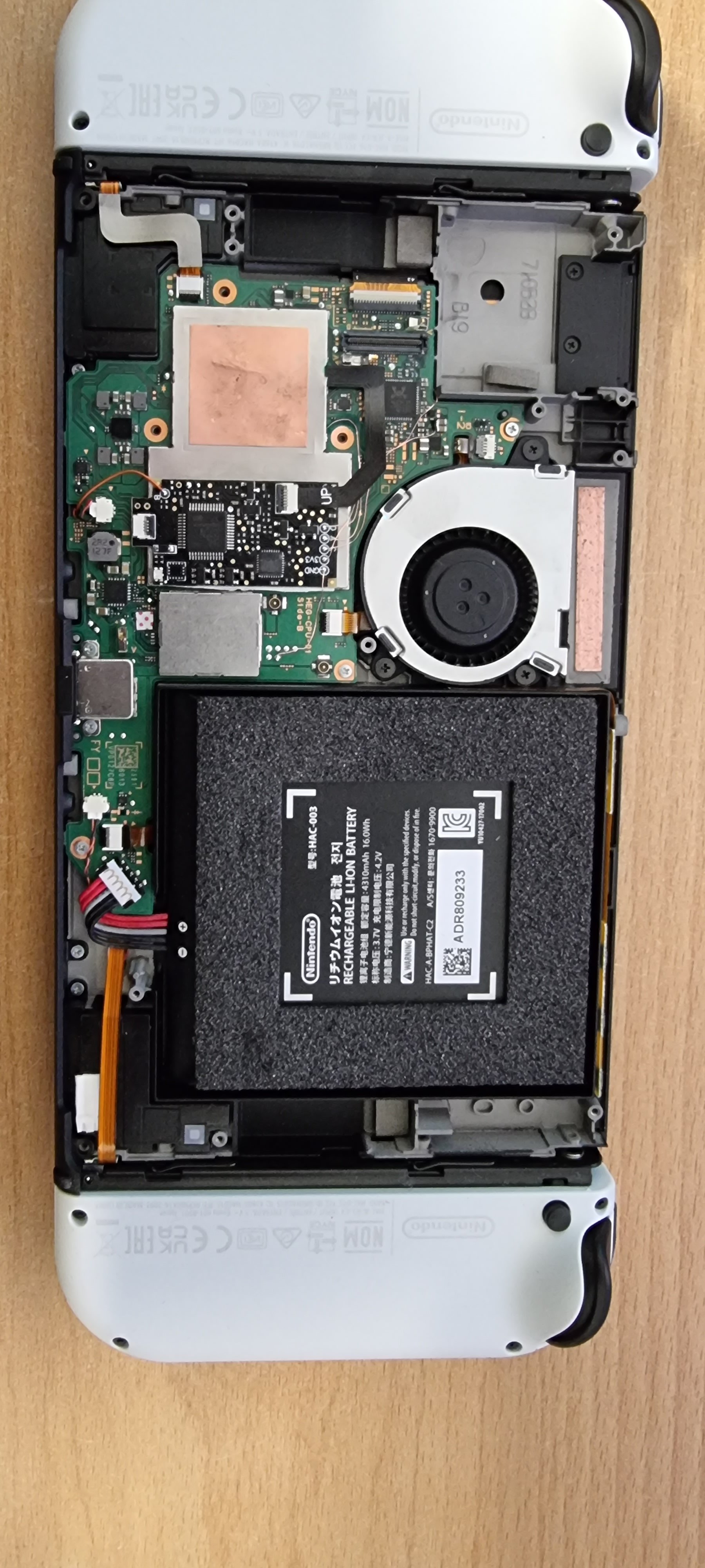

This is the picture of my switch my seller sent me.
I didnt solder it etc. so you can imagine telling me to go put a V4 in it is a big no no. Anyway what is the alternative, you said i could try reset the chip. how do you do this? also lets say i just keep it like it is, because Im too scared too do anything. What is the worst that can happen? can it be i can never boot hekate?
Nvm that's a V4. Forget about everything I said related to V3.
Can you see the LED through the bottom vents of the switch? What's the LED color when it boots to OFW? Probably it's still running stock firmware, try updating its firmware to latest hwfly-nx.

He sent the picture on 15 january. i dont htink there was a V4 then.
