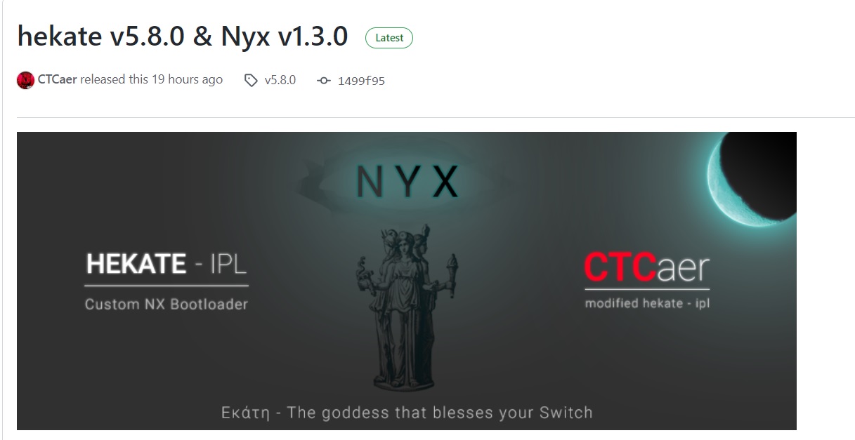

hi, let give a try to update your hekate and nyx to latest version maybe will solve your problem
