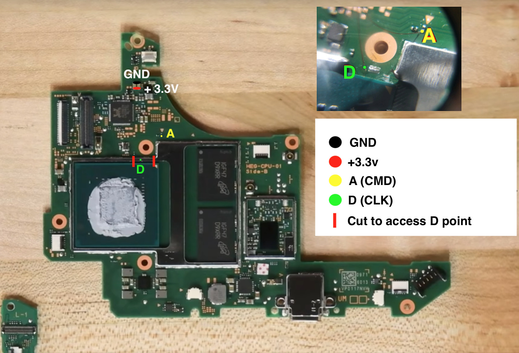

I just done soldering a Hwfly v5 based on the latest sthetix video. But what about ground and the pad below 3v3? Should I wire ground to other side of the 3.3v capacitor? Also, do I need to bridge both capacitor for 3.3v just solder one? Thanks
U need GND. Without GND the modchip will not work. The other point is not relevant for your case.
Grab the GND from the otherside of the 3.3v cap (or from any gnd)
