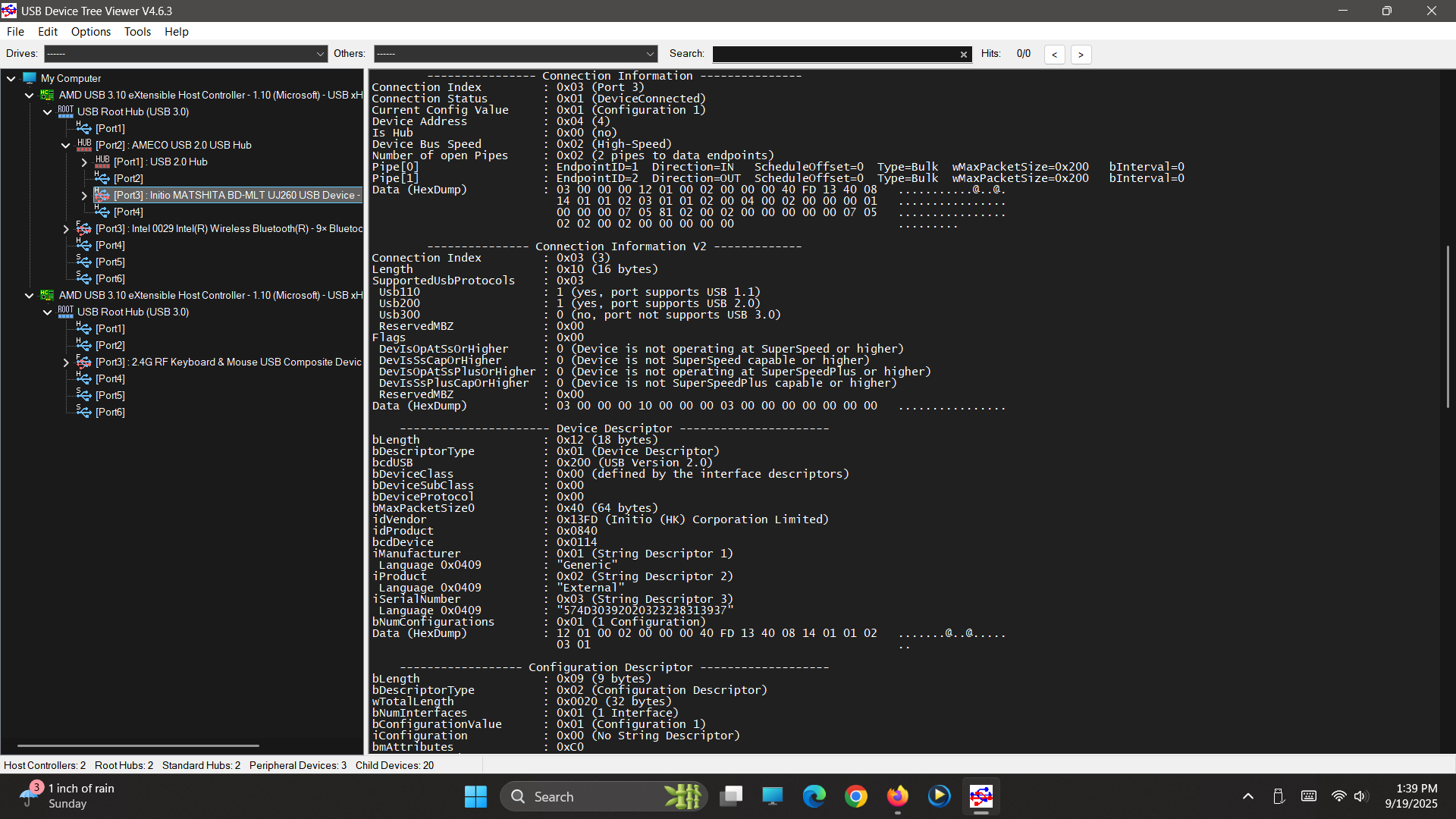

What helps me a lot could be a screen with usb device tree viewer of the drive specs

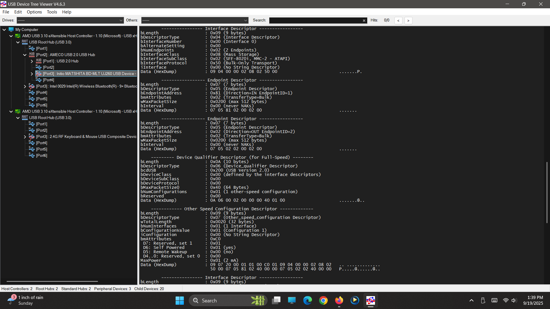

Found out why many bluray player dont get discovered.
Seems that all of them are subclass 0x06 (check it with usb tree viewer) that i filtered out for not conflicting with libusbhsfs.
I will make an unfilter command to use if drive is not detected.

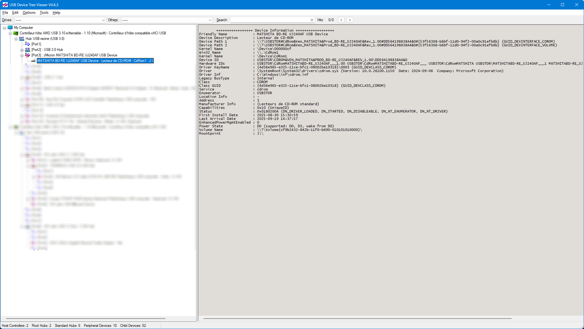

@proconsule54 I was able (at last) to test my new blu-ray drive
libusbdvd 0.1.0 : crash at startup
nx-laserplayer 0.0.1 : no USB drive found
USBTreeView of my drive, if it can help :

pressed the minus button to force subclass 0x06?

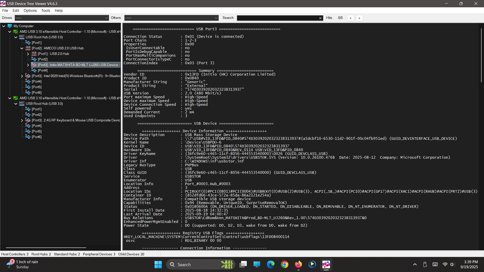

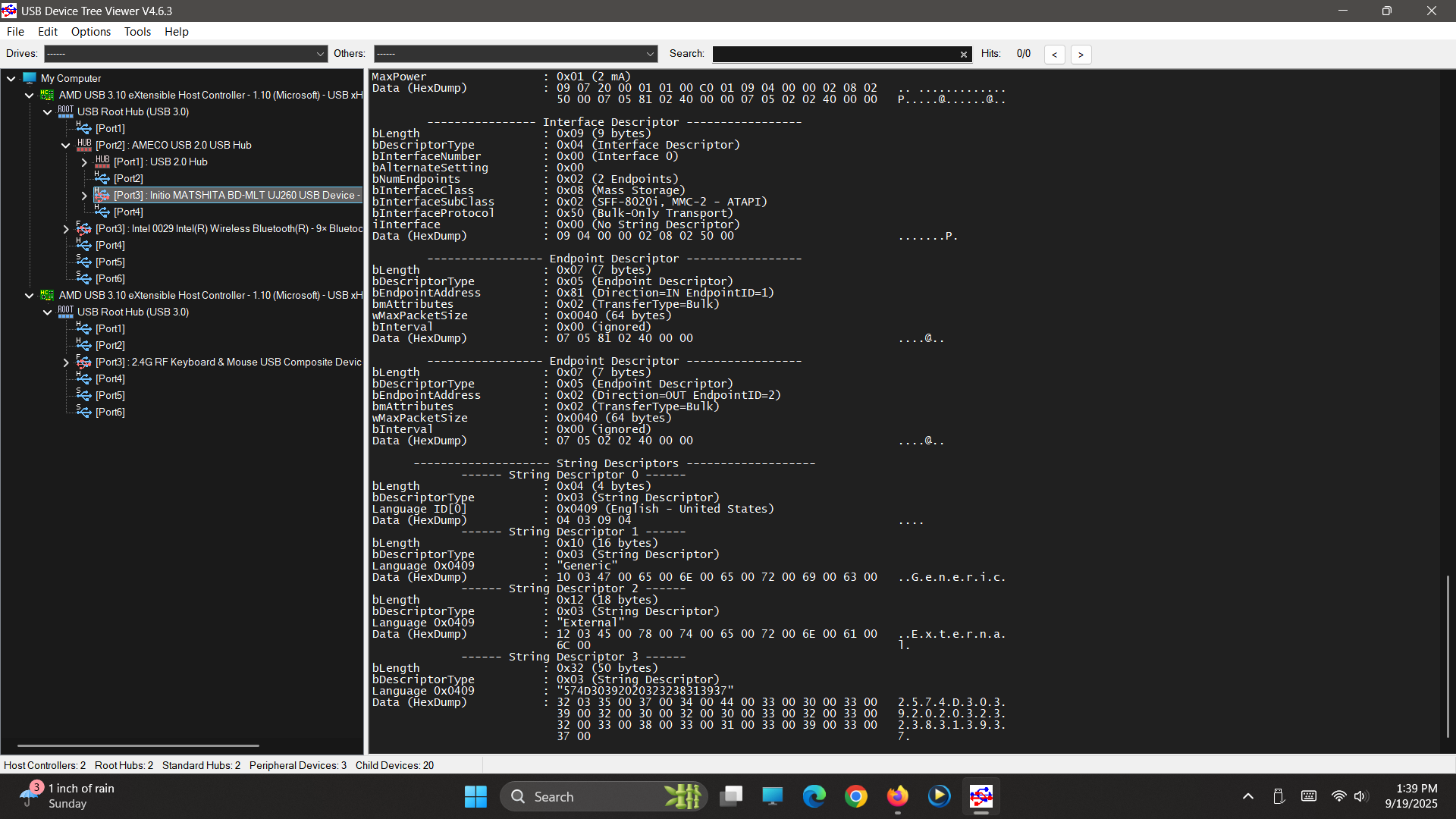

Tips for make it works, first be sure of the subclass of your drive.
Use usb tree viewer and search for bulk endpoints it gives class and subclass
For optical drives it should be 0x02 but many bluray uses 0x06.
If is a 0x02 it should be discovered in auto, if not there should be some deep problem i have to investogate.
If is a 0x06 app should say usb not found with press - button ecc.
Disconnect any other usb device other then optical drive, press - button
