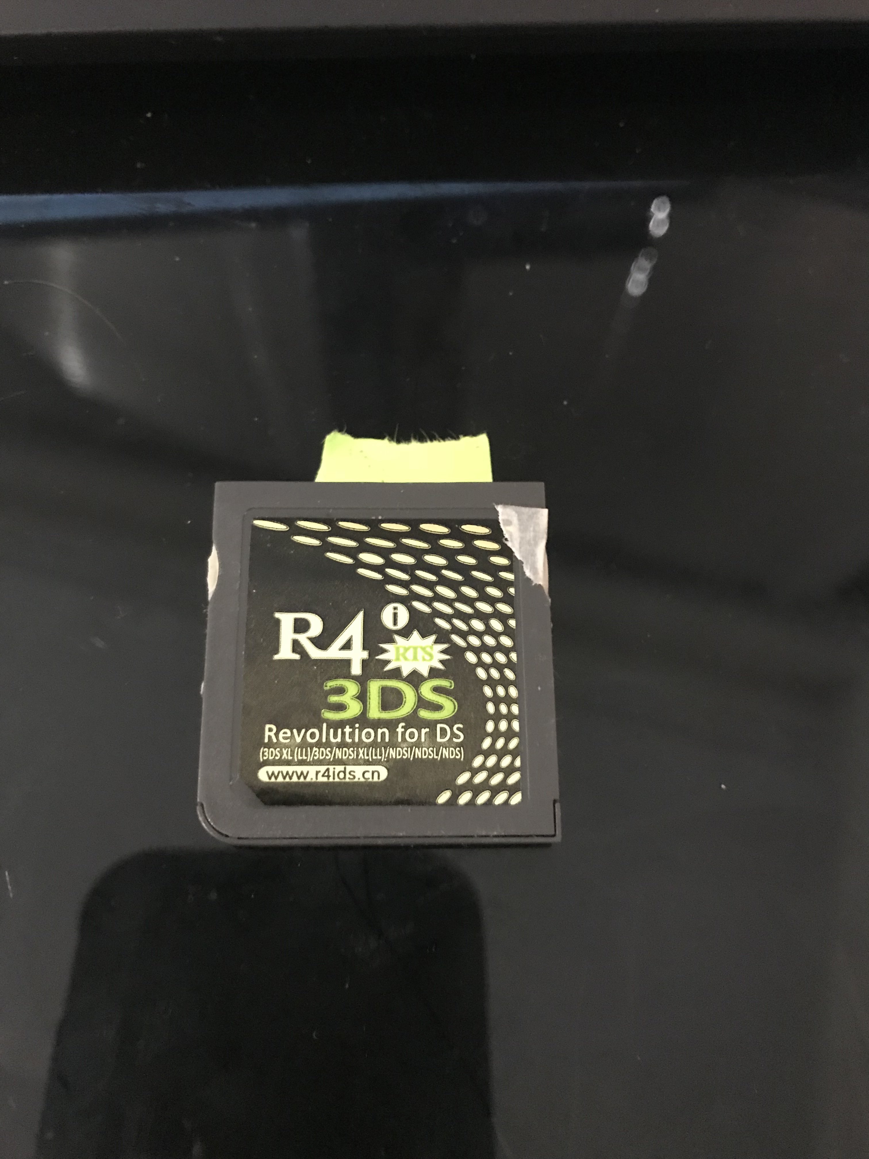

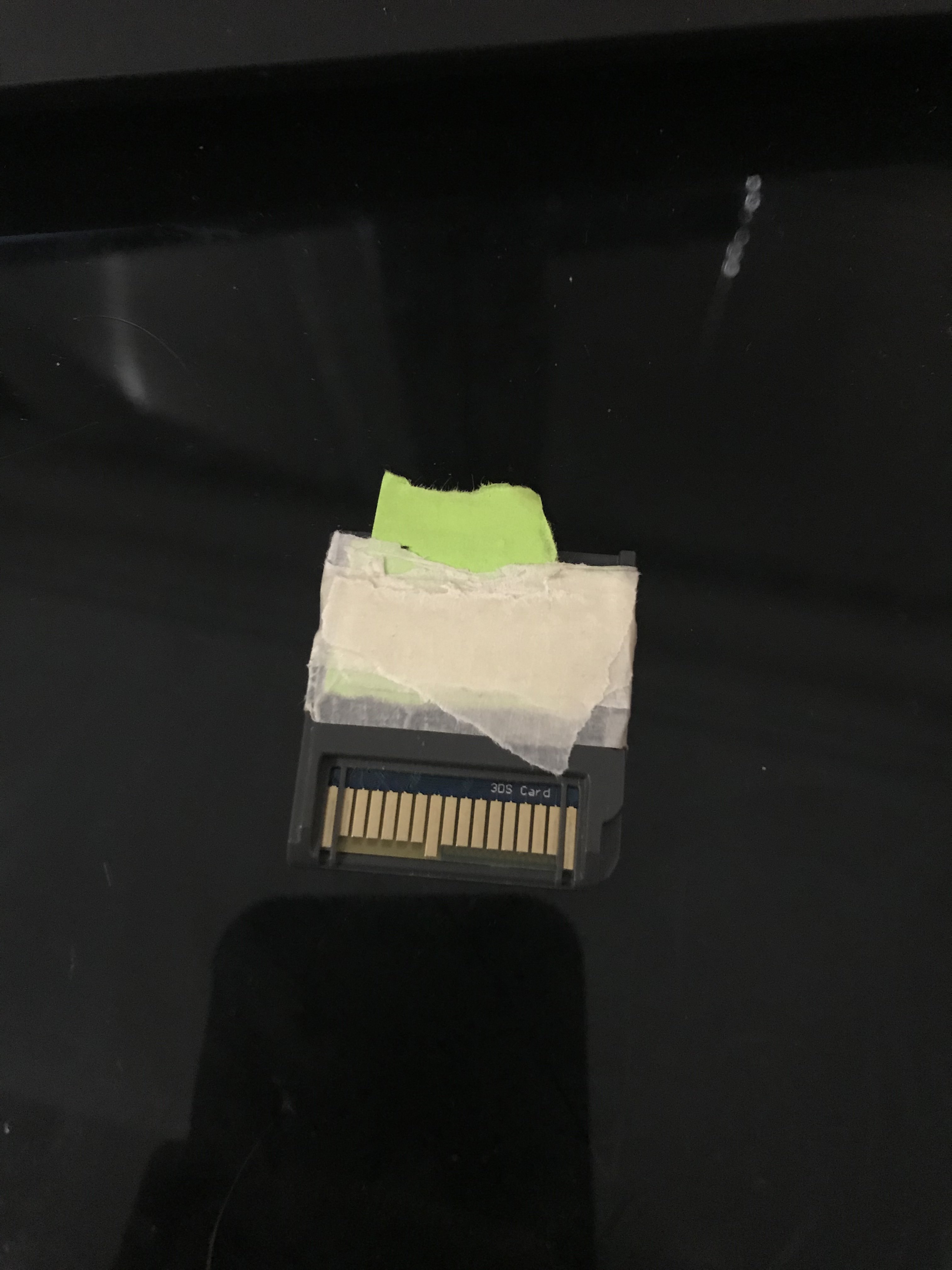

Hey guys, my R4 Gold RTS came today but it doesn't fit in my n3ds xl card slot. It seems, that my card slot is too big for it. I flashed ntrboothax when I hold pressed the flashcard in the 3ds. Is there a fix to let it in the card slot somehow?
Have you tried it with the backplate thing taken off? It should fit with that removed.
nope, it doesn't work
How about following this?
