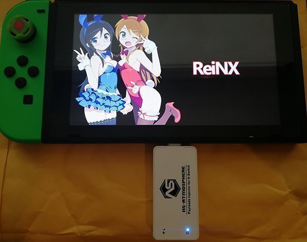

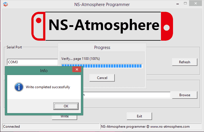

Anyway, as expected the dongle works for any payload you want. You can swap between Hekate, ReiNX, SX OS and any other payload at will by using the programmer application that lets you flash the given payload to the dongle with just a couple of clicks. You can grab it from the official website here (direct link): http://www.ns-atmosphere.com/media/content/setup_ns-atmosphere_programmer_v03.zip

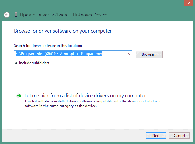

For me the driver did not install automatically (flip power switch then double tap the reset button after connecting to usb), I had to install manually which worked fine after I disabled signature verification. Just reboot afterwards and it will enable verification again.Then I browsed to the latest ReiNX.bin and waited for it to write to the injector.
They do provide a .zip for different firmware versions which contains the files for your switch sd card, but those may be outdated, so I just stuck with the files I already had (latest ReiNX files for github) and flashed the reinx.bin included in those official files (the same .bin I used for tegraRCM).

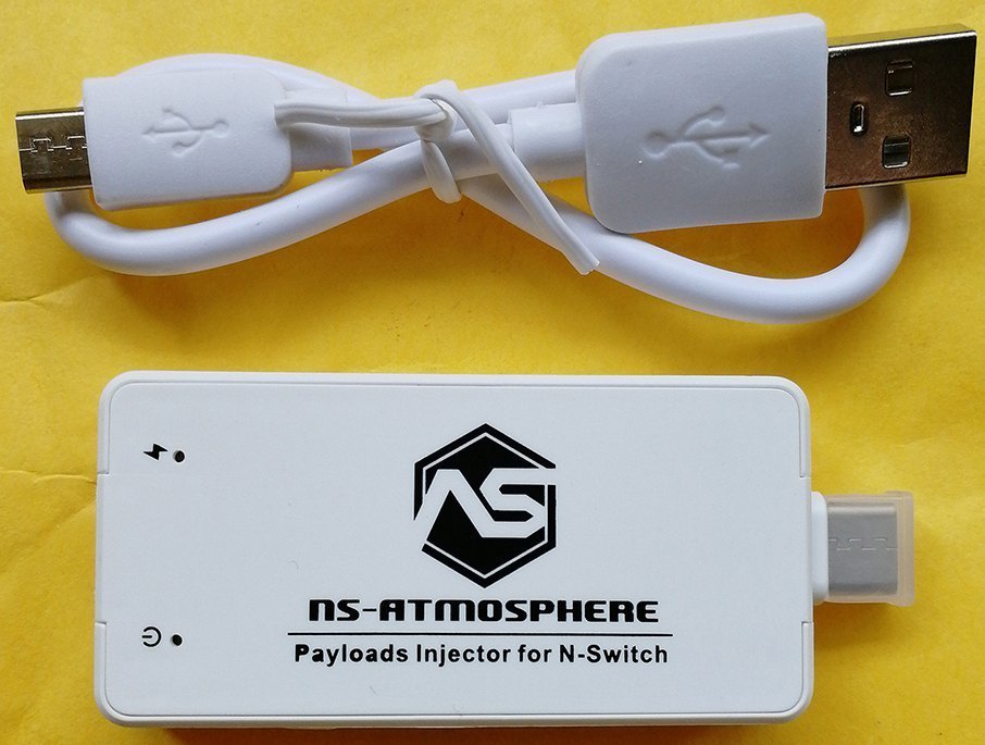

The LED's change depending on what is going on inside the injector while it's connected to a pc, blue for power, green for full and red for write (payload as well as driver install)

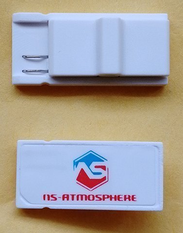

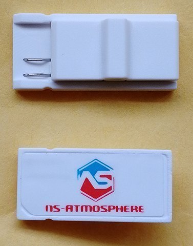

It comes with a separate usb cable to connect it to a pc for injecting or updating the payload. I actually prefer this as it makes the dongle look much neater when compared to the other dongle that has a full usb connector sticking out from the other side that could break off. The jig fits nicely into the slot on the dongle, and glides smoothly into the rail in the switch to short pin 10 with pin 7, it has a solid feel to it and even a little sticker on the back.
Right now, it is the cheapest dongle available on the market at about £12 ($15) but it looks much more professional than some of the other cheap injectors out there.

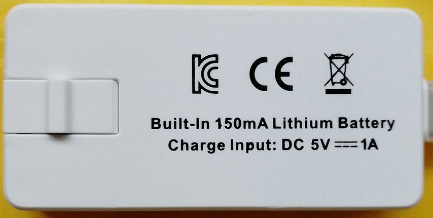

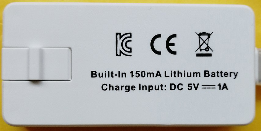

Another thing I noticed when shopping around and comparing the different injectors, is that this one has a 150mA battery, which BitFunx say will allow for 2000 injections over 60 days before needing a recharge. I know this might not be too much of a concern for some people, but the other cheap injectors only have a 60mA battery in them. So this one is going to last much longer between charges if you’re worried about that sort of thing.

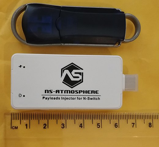

I know some people have debated the size of this dongle, saying that it is too big and bulky but it really isn’t. If you compare it to the SX injector then yes, this one is bigger, but it’s only 7cm long which is about the size of a regular USB stick which makes it very easy to carry in your pocket or in the case with your switch.

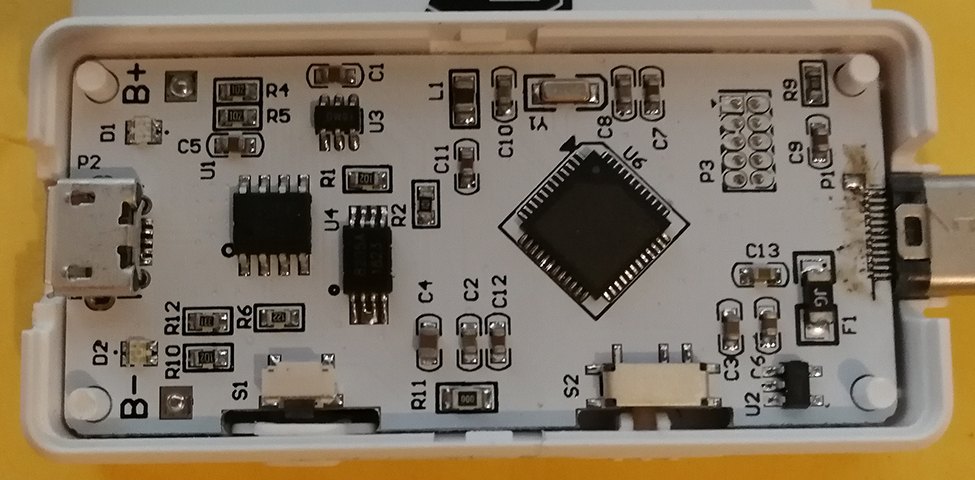

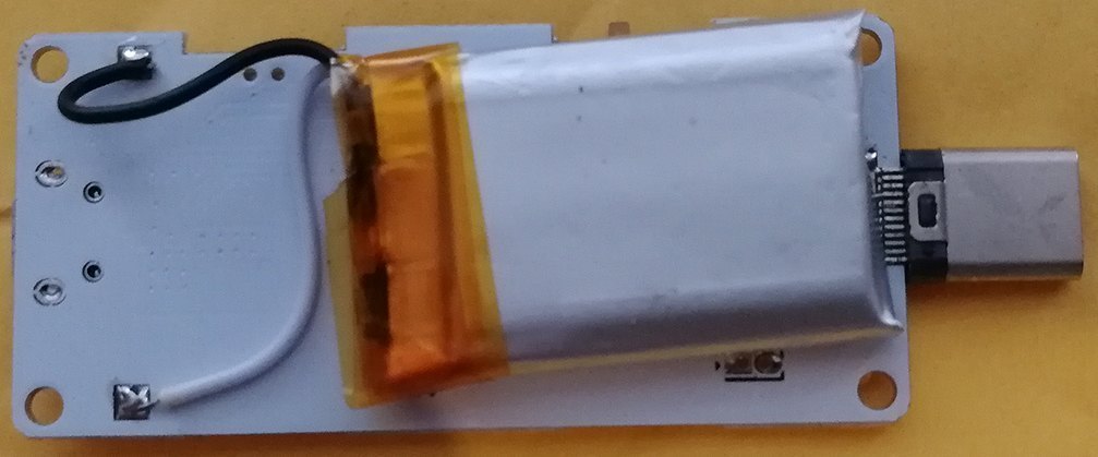

Here's what the inside looks like

What does the top of the big microcontroller say? It's unreadable in the picture above. Needing an extra tool and driver to change payloads sounds like this is not the usual SAMD based dongle.
The top of mine doesn't say anything, it seems like it has had the ID removed.
I took the image from someone on reddit but I cracked mine open and added my own images of the inside, which mine too has the ID removed.
i bought one. it possible to load xecuter sx os and how ? i have sx pro.
Yeah you basically just do the same as I have, but instead of writing reiNX.bin you write the .bin for SXOS instead. The process is exactly the same regardless of what payload you want to use on the dongle.

It is a good dongle. Programming was fast and easy. Payloads launch no problem. You can replace the included Jig with your own if you already bought another. It will fit in the same slot on the launcher. This launcher is great.

Oh, that's a shame. I guess they don't want us to know their secret lol Probably an even cheaper microcontroller than the SAMD.
(nvm this post, I didn't see kumikochan beat me to it haha)
so i need to write ‘payload.bin’ from xecuter sxos
Yeah I guess they're keeping us in the dark haha
If that is what is is called then yes, I don't have SXOS so I don't know the name of the payload. But given the name, it certainly sounds like that is the SXOS payload file, so just write that.
Looking at the board you posted, they can reduce it's size by half, there is so much empty space, i think i can park my car on one of those spaces.
