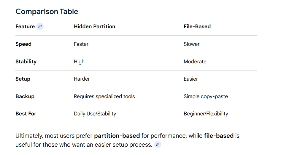

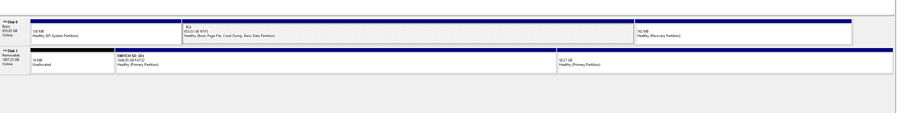

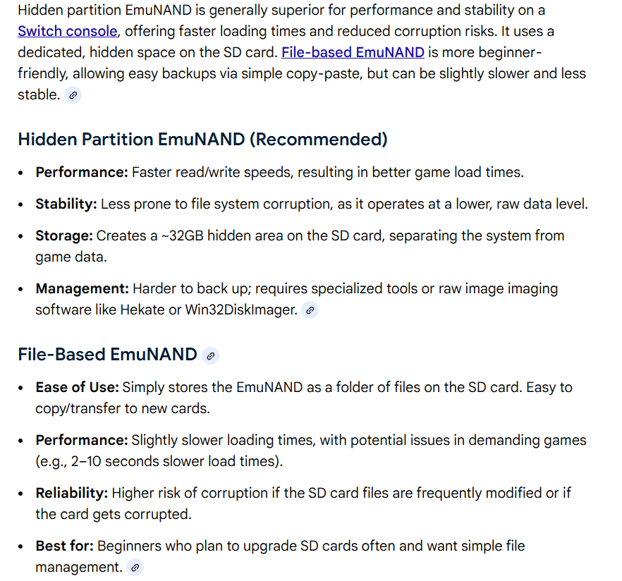

Like this you need to see if you have a second partition, if you have a second partition then you have a hidden partition emunand, like mine it is 58 GB since I have an oled. But based on what you have you have no emunand as you have no emummc folder.
To get back to your opening question, as for new SD card you can copy and paste to a new card as long you format it correctly, I would recommend fat32 though, since I see you using an exfat format. You can use something like guiformat and format the new card to fat32
https://guiformat.io/

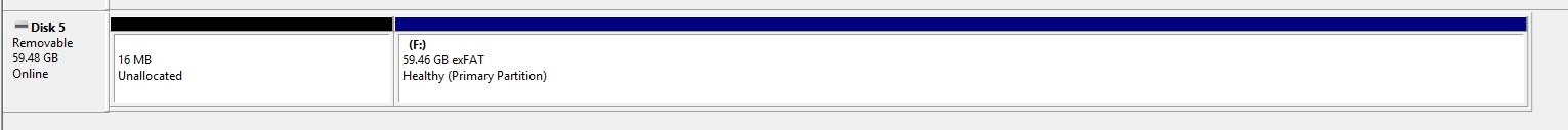

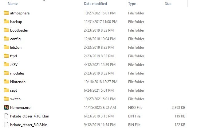

The only thing I can see is Disk Part is the 16MB Unallocated and Healthy (Primary Partition). I assume that means I don't have any extra hidden partitions? I can't quite see the image you attached but I can see there is a 3rd partition there which mine does not have.

No extra hidden partition for you, A1 card are slower compared to A2 card but switch 1 sd card reader are A1 speed inside horizon os, the only benefit is faster transfer speed when copying data from computer to sd and when backing up nand due to faster read and write speed. You can go with UHS-I / A1 128gb instead of UHS-I A2 card if you want to save some money since memory card are 50% more expensive than before.
