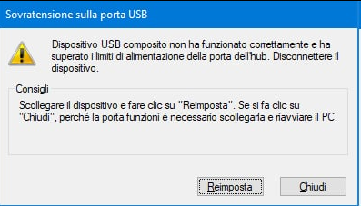

Small update: the new cable worked, but I haven't plugged the PS Vita since yesterday morning, but when I moved it a small inch it stopped charging again. When I plugged it on the PC as curiosity to see if my PC would see it I got a message talking about USB voltage
@Yayo1990 ,does the cable move when you connect it to the PS Vita?

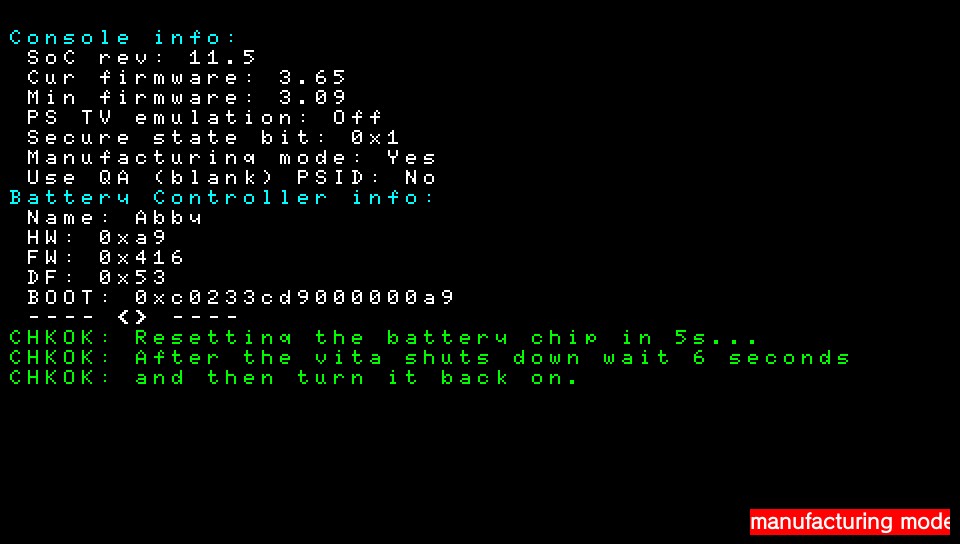

Might be worth giving the "battery fixer" vpk a shot...
https://github.com/SKGleba/PSP2-batteryFixer/releases/tag/v2.1
is this vpk safe/okay to use?
i tryed using it and aftering running it, turning on my system, it showed the day/time/year setting (reset battery)
it intimately shut off.
to fix my system i had to remove the sd2vita and reinsert it back to be able to boot up the system without a crash.
for me this vpk did not work, maybe that's why i got that crash on boot after the battery reset. and i had used the leatest vpk version (2.1)
i read somewere here in another post that the batteryfixer vpk was not okay to use for some reason?
I'd not heard anything about it not being okay to use - I know it's been tested on fw's 3.52 - 3.70, so presume it's okay to run on anything running those (with the obvious exception of the PSTV).
Did it create a log in ur0:temp/batteryFixer.log ?
Did you get to this screen...
