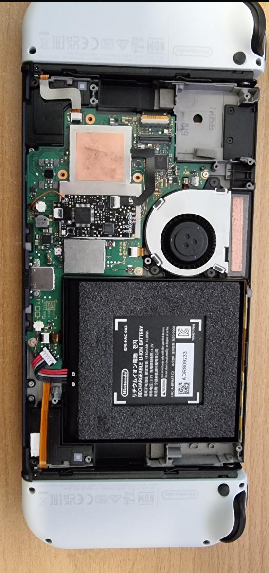

Very soon. A couple days. @FAKEdemicBioPYSCHONANOWAR What modchip did you install? Show an image of it.
I didn't mod my switch itself. But this is what the seller send me. I have no idea what chip it is or not.
During my testing like i said i noticed the brand new 1TB sandisk is 9 out of 10 times "No SD" error.
I tried to use my half year old 1TB sandisk, which appear to work 9 out of 10 times while only once in a while giving "NO SD" error. I read both cards with hekate.. Both seem the same in all ways except S/N and production time.

Looks like the new OLED variant modchip, which I've seen is picky on which SD cards work consistently on it. Would explain the issues you are having.
Check out this video, I linked it at the timestamp where it shows the issue. If you watch the whole video, you will also notice it's the same modchip in the pic you showed earlier.
The installer comments on the exact issue you are having and he gets the same issue in the video as well. Apparently there may be no issue with Samsung brand sd cards, but others can have issues like yours. At this point I believe you're only options are to wait for a modchip firmware update (unless there's one out already?) or get a samsung sd card.
