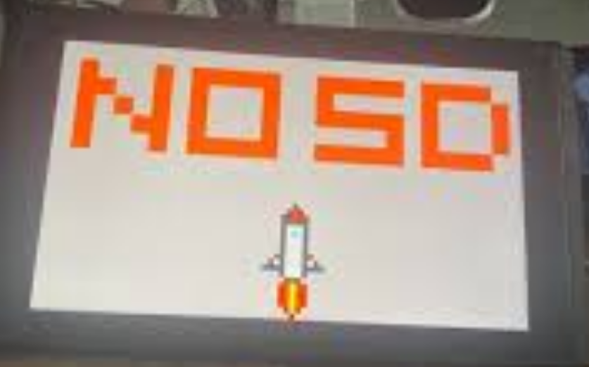

Trying to boot hekate and im getting "
no sd logo"
I first formatted the sd with guiformat to fat32 with default cluster. Then it still gave me the error. So I then reput my sd files on it. Then hekate booted somehow.
Then I did the emunand part with partition based emunand. and I rebooted then again..."NO SD" logo...
What is going on to behave this way?
Trying to boot hekate and im getting "View attachment 294147no sd logo"
