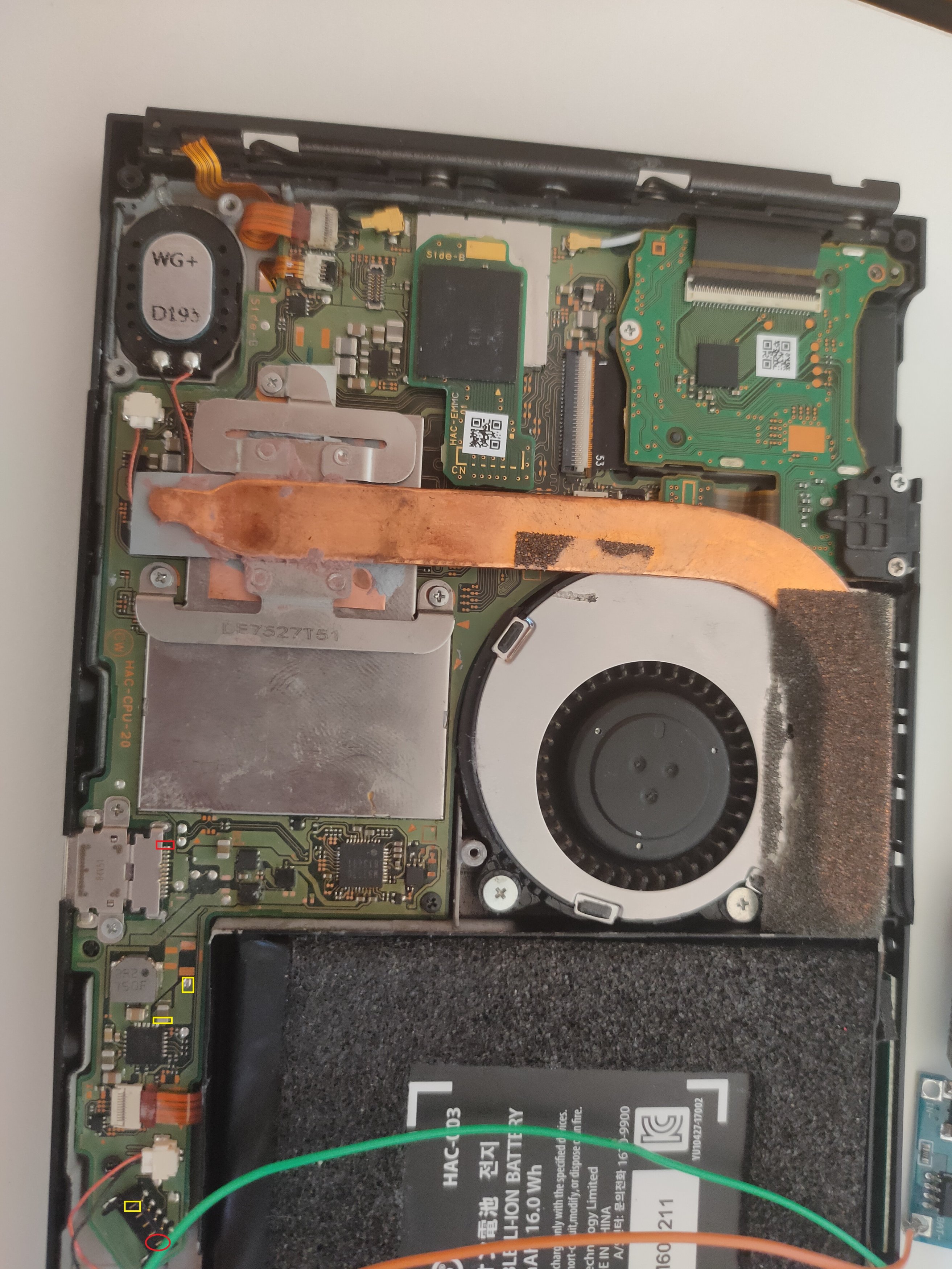

Hi to all,
I have a nintendo switch that doesn't charge and doesn't power on.
I've opened the console and see the m92t36 chip like the attached file
do you think it can be a problem? how can i fix it?

Check if there is a continuity path to all charging components to USB-C port
You right there is not continuity with all parts.
I add a image for the points of continuity with colors. The battery- has good continuty but the battery+ hasn't.
¿Someone has the route for the battery+ pole?
When I put the ac conector the switch stared to do a continusly noise, I don't know what that.
