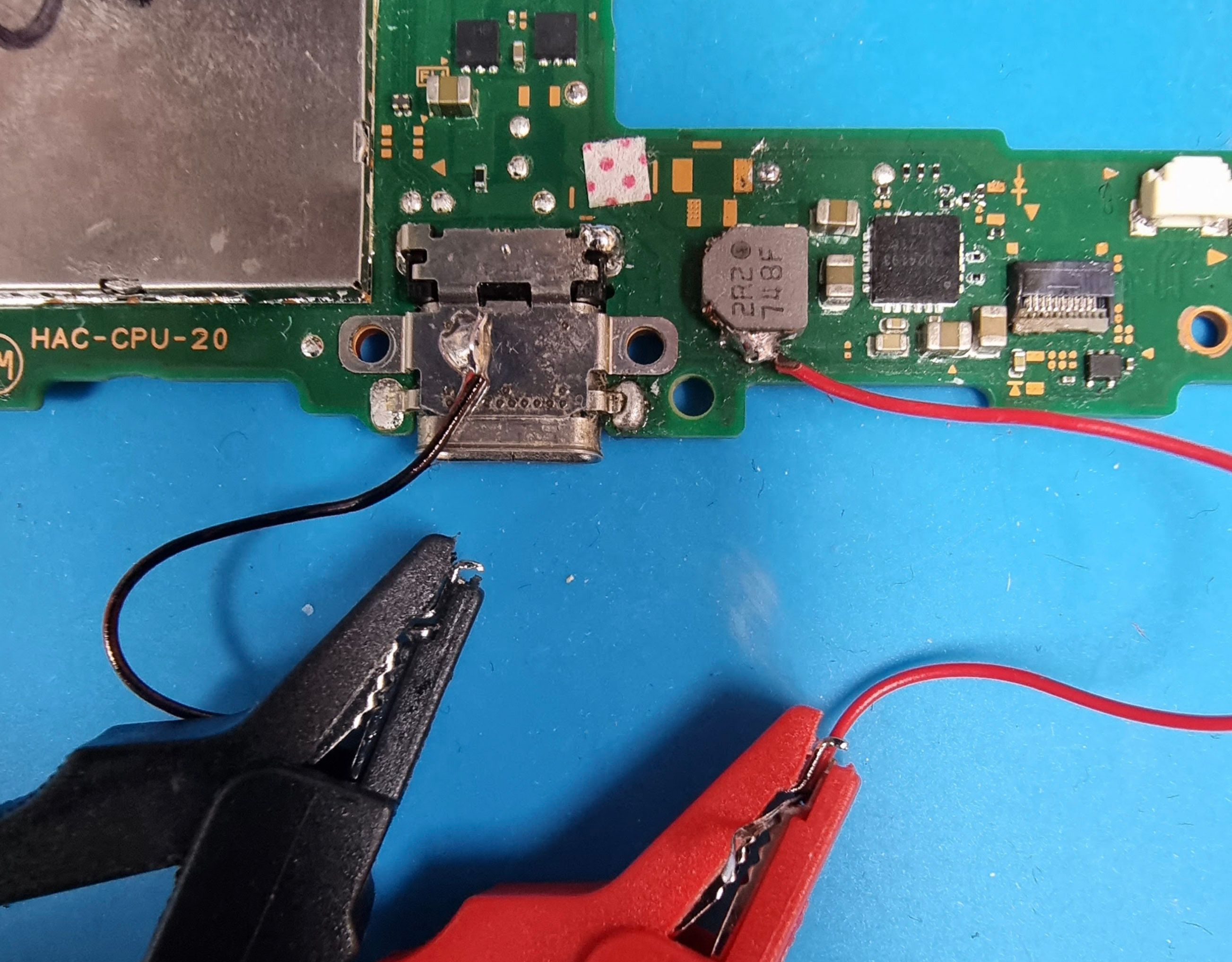

I Have a Nintendo Switch v2 , the console shows image when battery is plugged in, but does not charge.
It shows nintendo logo and then insta dissapear and shows the battery-empty simbol on top left of the screen.
I checked the pin 5 of MT92T36, and shows 4.8 volts with the charger connected to the console, but pin 6 its on 0 volts.
I also tried to give power to the coil of the image and power on the nintendo, it gave like 110 mA for a long time, but last times it went to 350 mA for some reason.
I used the thermal camera to see if something was heating up but no clue.

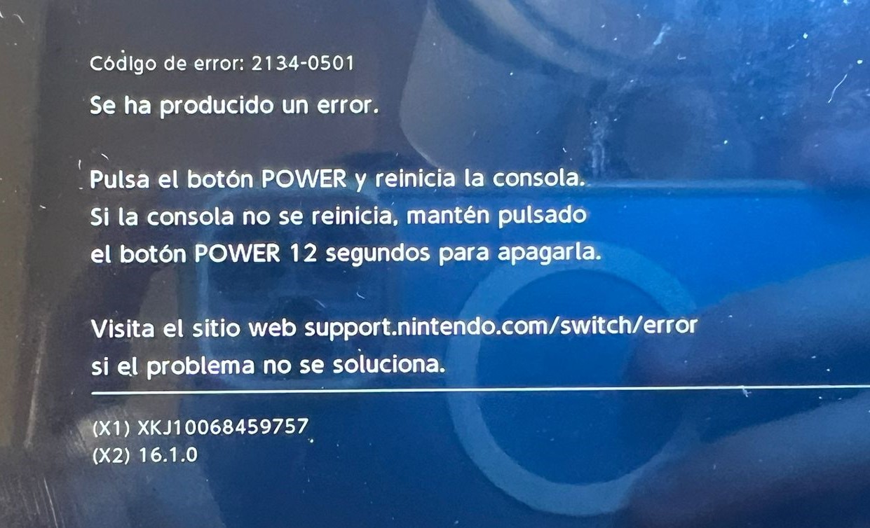

After all this, i charged the battery manually, till 3,8 volts and the console shows the error on the "error" image Attached.
Can someone help me with this?
