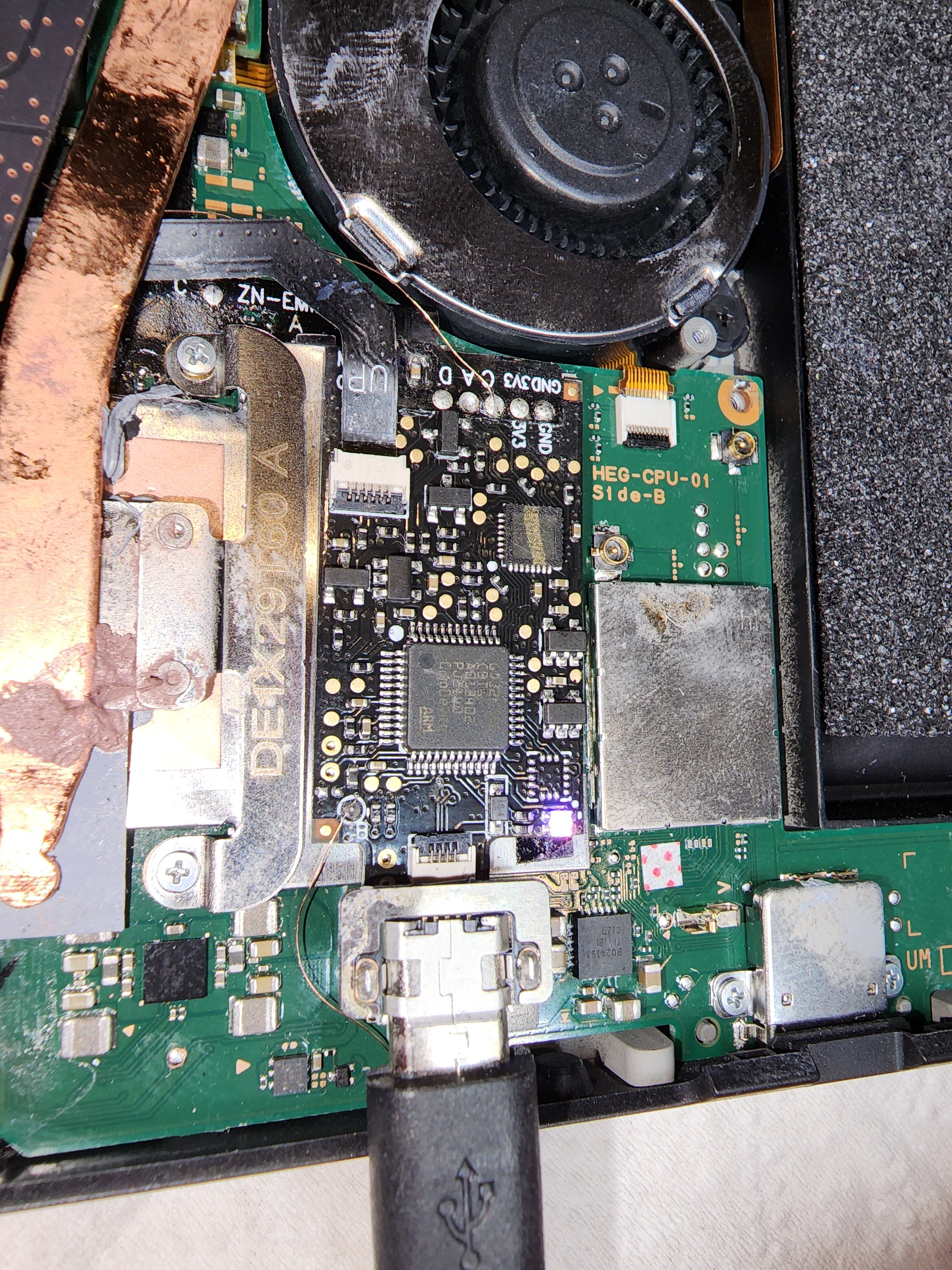

How do I fix this still purple light? I think it is the glitching timeout glitch but I don't know a way to fix it.
Most of the time it's a bad connection with the DAT0 dataline or one of the other signals.
One suggestion in some topic was to give the Switch a small nock/tap so that the DAT0 cable goes into the right place again.
But for a real fix I would suggest taking it to a good workshop.

Pulsing purple LED: Still glitching, just wait. Usually glitching should finish within 10 seconds. Try to re-train the chip or check connection if it takes too long.
Solid purple: Almost always a connection issue, usuall dat0 adapter's issue. Apply some low temperature solder to the adapter and reflow the emmc chip.

It is solid purple so I might need to bring it back to the shop
