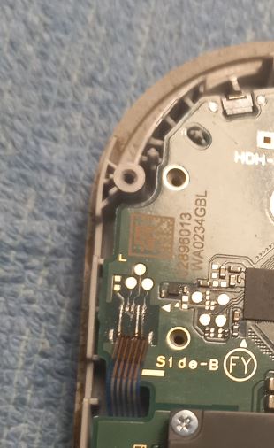

Hi I've opened a switch lite to change the analogue sticks and the pins are missing where the ribbon should connect to it (see photo).
Can this be fixed or is it as good as dead?

Seems to be missing the FFC connector on the board. Should be fixable if the traces aren't too damaged and you can find a spare connector. Can be tricky to solder, though.

Can I solder onto the ribbon cable?
The PCB tracks are intact and not damaged.

by spare connector do you mean buy a replacement connector, or do you mean there are spare connectors already on the board?
