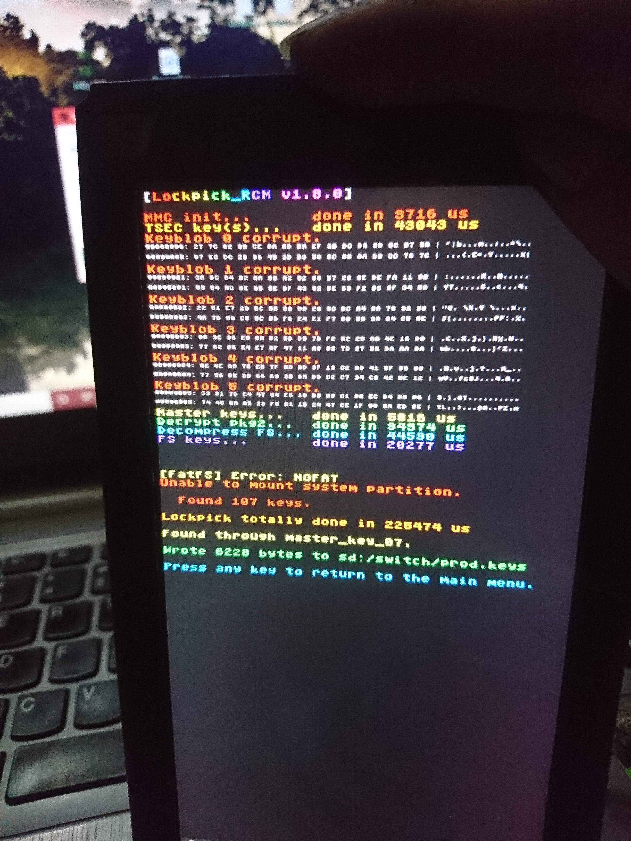

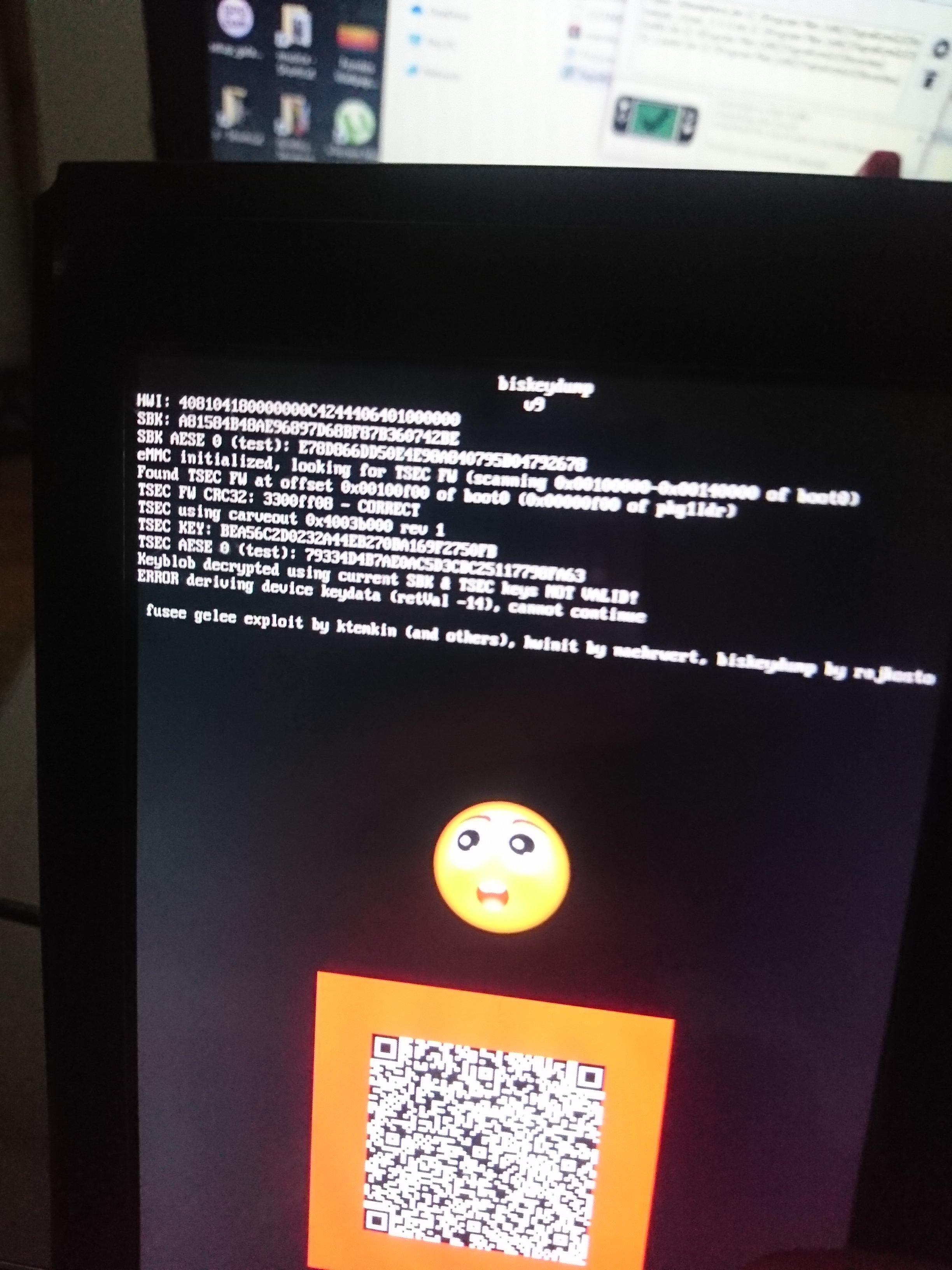

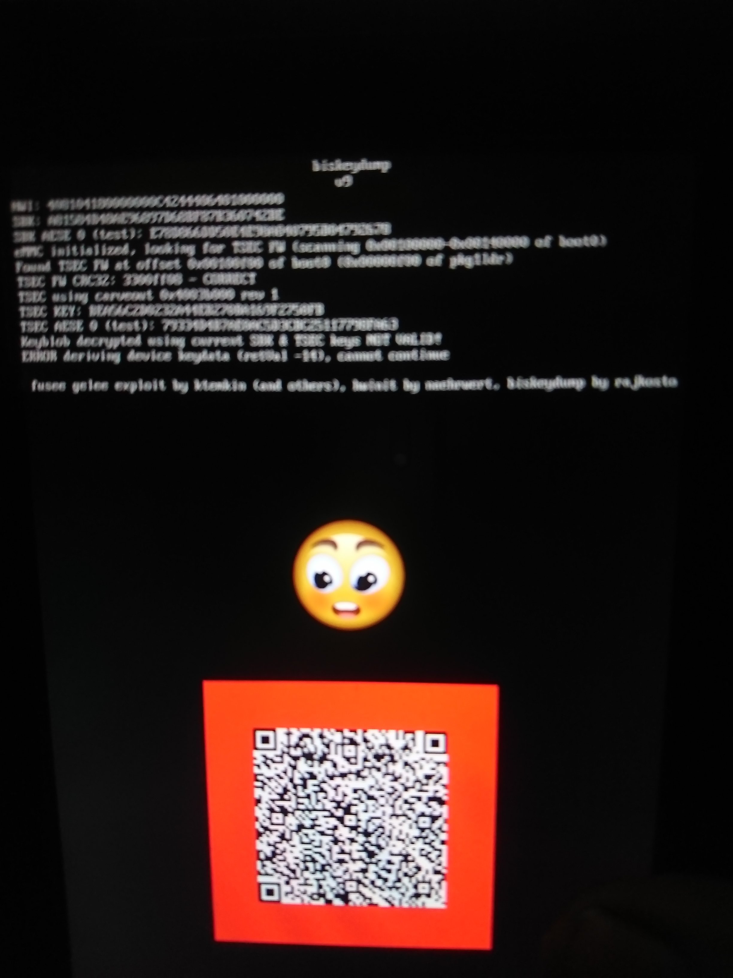

i tested usb in board all pins with continuity and they are fine.
i will try software for now
i try obtain biskeys but i cant obtained
>8{
with lockpick i cant too
