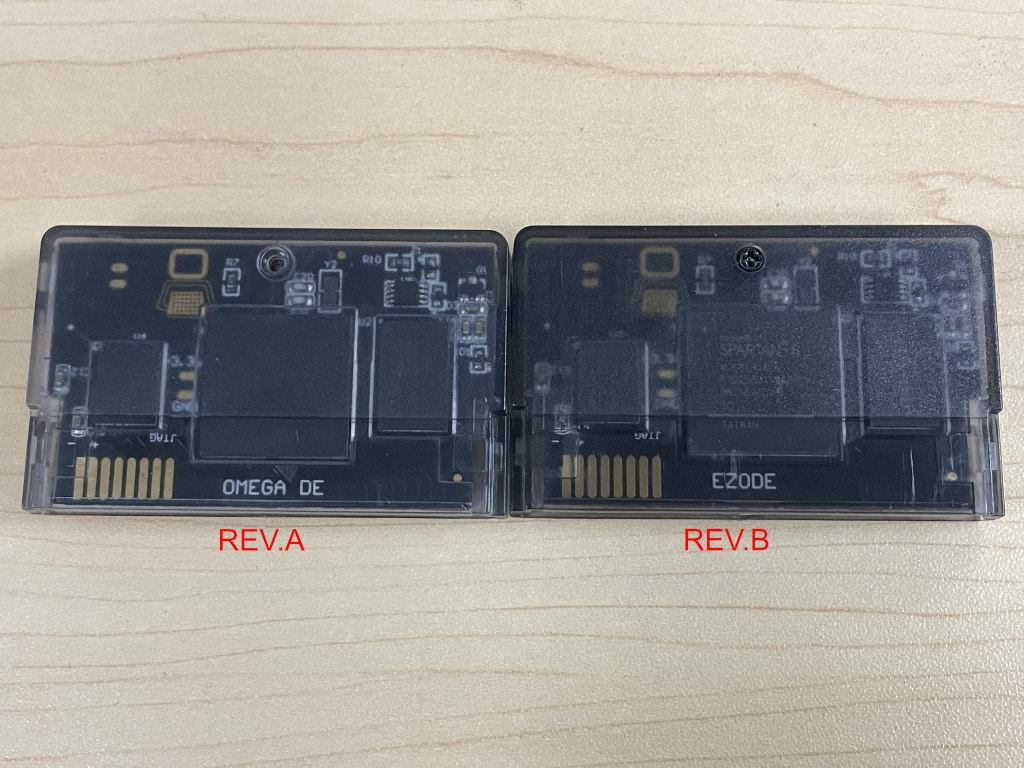

possibly but there are fakes on aliexpress as well. One way to tell is to compare the pcb boards in the cart. defects aren't all that uncommon tho either. bad crystal oscillators or badly soldered ones are common. which can cause certain types of roms saves to fail. like roms that use the rtc clock for in game and saves. or just a bad fpga chip.

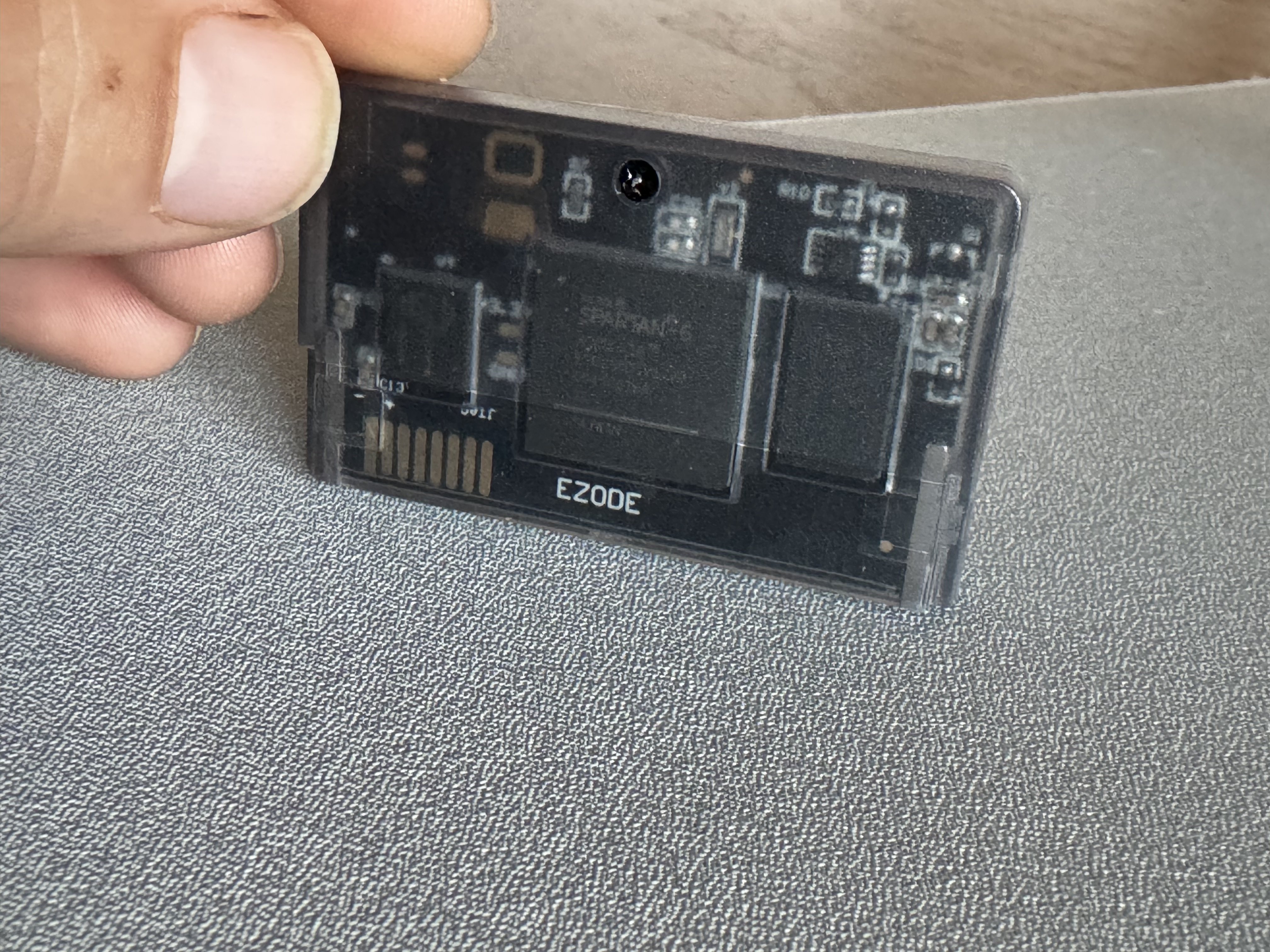

That REV.B cart/PCB is identical to mine. But again, I have zero saves on my SD card, and every single ROM i try to boot fails, except for using the official kernel. About to try another SD card for the heck of it.
