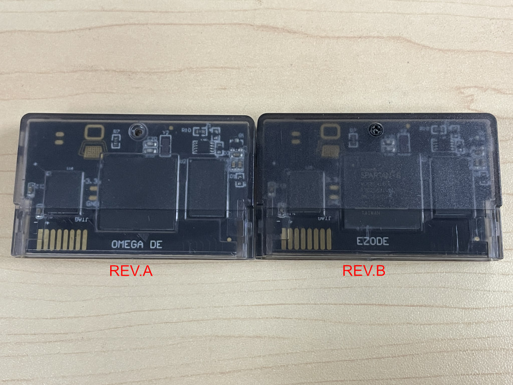

then look if you have a rev A or B omega DE cart
If you have a rev B cart download and extract the file that has a .gba file extension to the root of the sdcard
and run it like any other gba game and follow the instructions on screen as before power cycle the system again.
