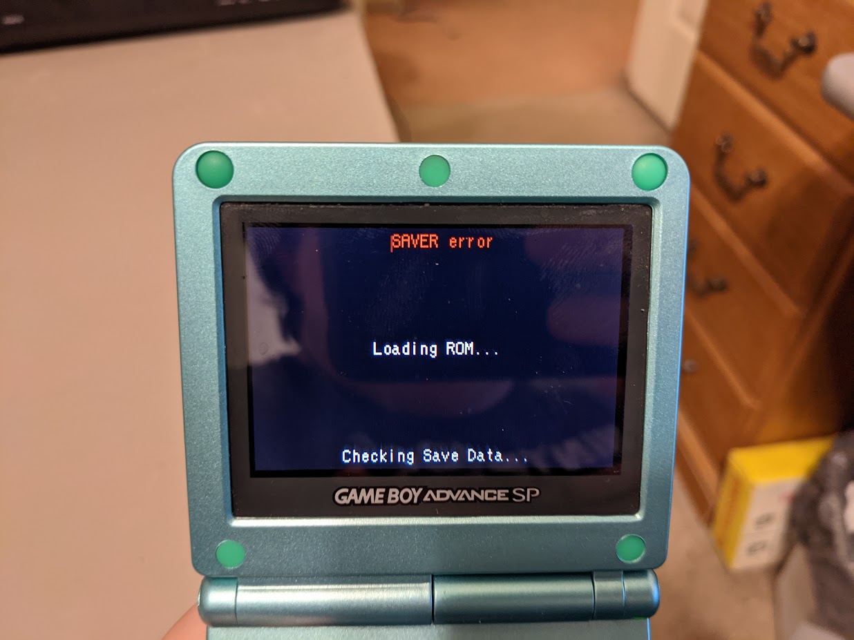

I was able to successfully install the firmware on my Omega DE but now I have this "SAVER Error" that prevents me from loading any ROMs, even after I reformatted my SD card.
Does this still occur after reformatting? Make sure you have the SYSTEM file structure set back up.
It could be that I don't have the file structure set up right, I'll try that.
EDIT: Okay, changing the folder structure fixed it! It even made my cheats work!
