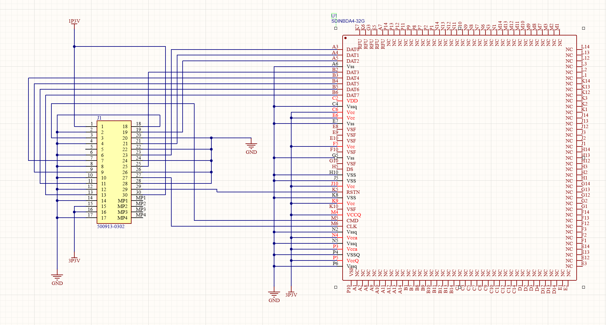

I'm working on making a new style hard mod for the switch, the one I'm working on is an unpatched v1 switch (XAJ70001)
right this moment I'm working on reverse-engineering the module, I'm hoping to have this as open-source but we will see
anyway need help working on the schematic I have this so far in Altium designer but I know there are 4 caps that I don't know the values for or where they go on the emmc. was hoping for a fast track if anyone knows them and what line they connect to pin 5 I'm not sure where that is connected but the rest is working other than the placement of the 4 caps it's nearly done
the idea is to get this printed and shipped back to me and see if I can copy my nand over to this new design if successful then I can work on adding mod chip functionality to this as hopefully a semi plug and play module
