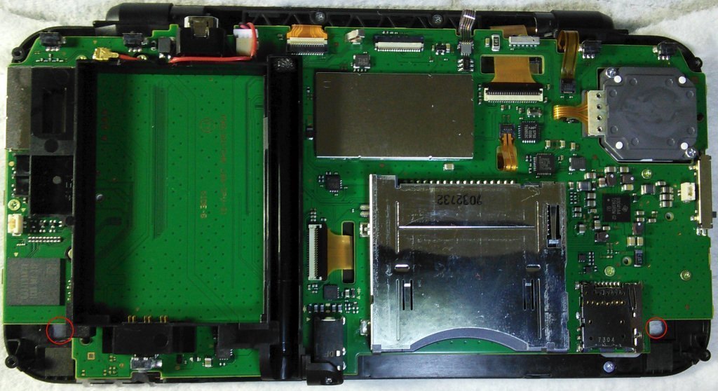

So I had a fairly simple idea: make holes going through to the top so even if the bottom side is covered I could still hear sound. And maybe get a bit better sound along the way. Unfortunately, when I opened it up I found out the speakers are actually on the casing itself, not under the main board. That means that even with it cut straight out the sound isn't really going right. First I tried doing it directly anyway. I went ahead and cut the holes like so:

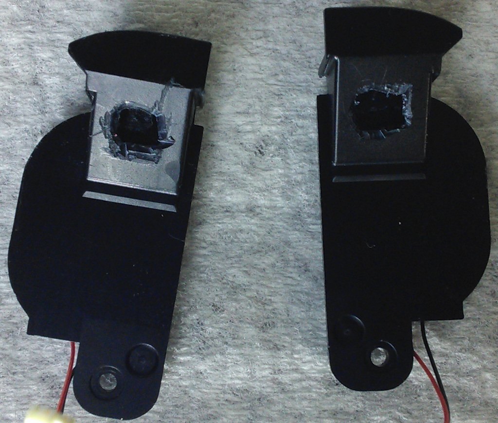

I took the speakers out of their little enclosures and used some double sided tape to stick them in pointing up. This was awful. The sound seemed weak and "far away" for lack of a better way to put it. Ok, they need their enclosures. So I decided to try making holes in the enclosures that at least come somewhat close to those openings like so:
This is a lot closer. But it still sounds very wrong compared to what it should. Certainly much worse than my N3DS.
At this point I'm about out of ideas. I think I need to add onto the enclosure somehow going to the top part where those holes are, but I haven't the slightest clue how I might do that. It would require something very small and somehow I'd have to fit it just right I suppose (certainly it can't be too large, but if it's too small by any significant length it won't work. Guess I'm stopping here for tonight.
EDIT: Maybe a straw. Though I, of course, don't have one.
EDIT2: I tried cutting a straw. I used a dab of hot glue to hold it in fairly well over the holes I've cut on the speakers. It won't quite line up right though it seems. That's a tad disappointing. And of course I forgot to remove the memory card when disassembling (this N2DS is the WORST device I have seen in a very long time for repairability! The volume control also likes to break off and if you're opening it you really really need to first set the volume to the locked position -- zero on this one, but I had tried another where it for some reason was the 100% position, perhaps a screwup on their part.) That's going to sting. I've lost a 64GB memory card and now will have to reinstall everything and lose all saves since my last backup (thankfully not that long ago, but quite a few hours will be lost in one game.) What little I could test (starting up Mii Plaza and not immediately exiting so it would play its music for example) seemed to actually sound a lot better and when I covered the bottom holes the sound wasn't awful. I guess this worked as well as it's going to. And now I must never ever take this bloody thing apart again because every single time I do something even harder to deal with breaks. I don't even want to think about what's next. -.-
