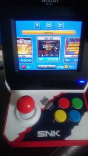

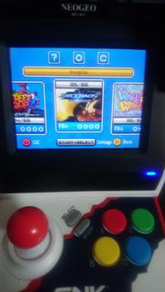

So now we can use USB drives with this, I dont need to reflash to add games
I've just been using the more games folder and have had no problems with adding as many games as I wanted there? I've seen the usb folder icon but couldn't work out how to add that way though? What does the folder structure have to be?
So we have a system.img file that we added a new script to mount the roms, and accept roms from the USB stick, even if you create the folder the right way, it still crashes on you. I'm working with MadMonkey right now to gain root so we can manipulate the /usr folders to change the launch scripts as well... This is more for me, to run SVC Chaos from the main screen. We are also working with a clean dump, trying to gain root.
