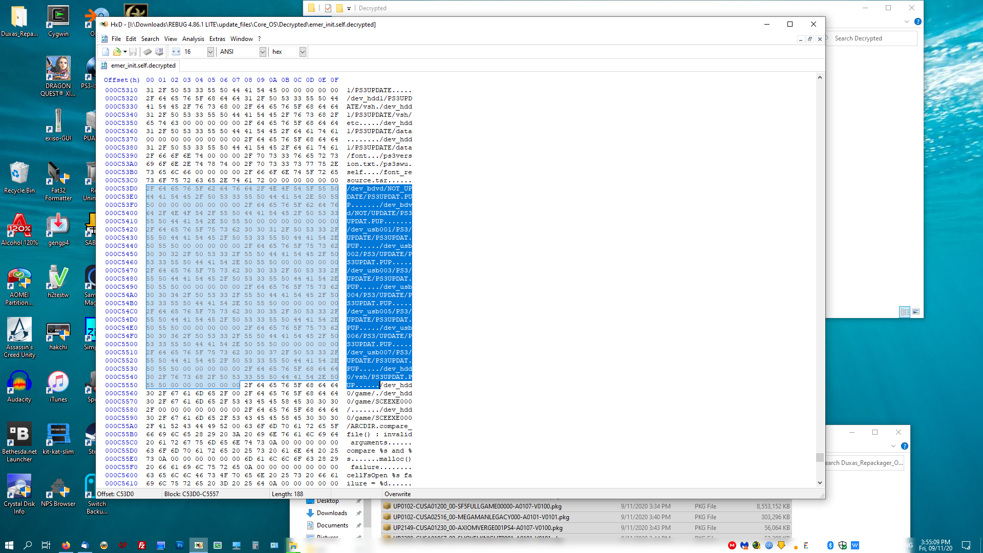

can't update with sd card. check this out:
the emer_init.self is the recovery menu. it can only update from these locations. as you can see, it's taken from rebug lite 4.86. they've added not to the bluray locations. that's their update patch. all the rest are hdd, usb, or vsh.
can't update with sd card. check this out: View attachment 224551
