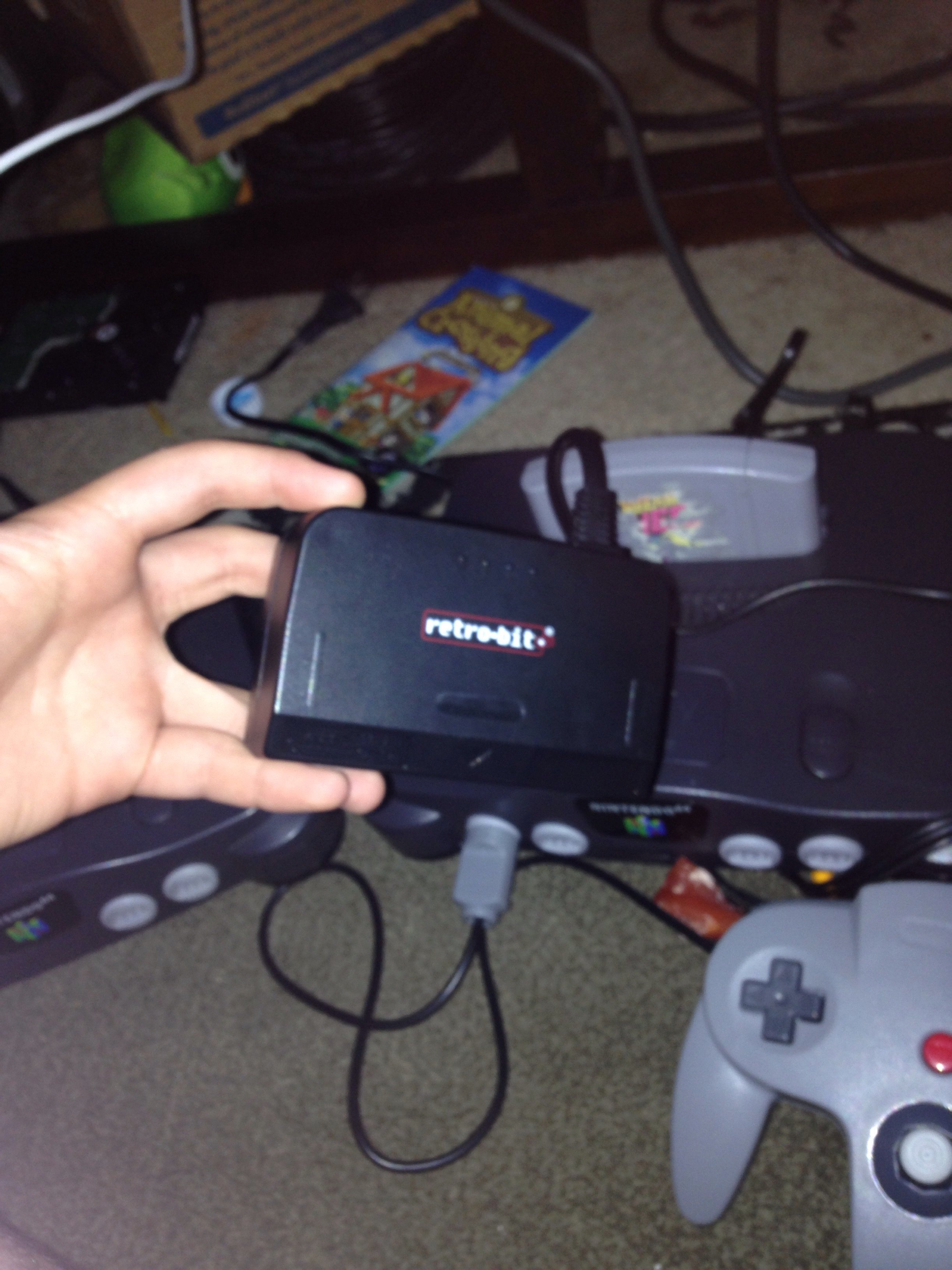

I also have a retrobit power supply for it.
Could that have damaged my systems?
That's the power supply.

My question right now is, could the power supply be causing this?

I wouldn't worry about the power supply. Not until you've ruled out other problems (try other carts).

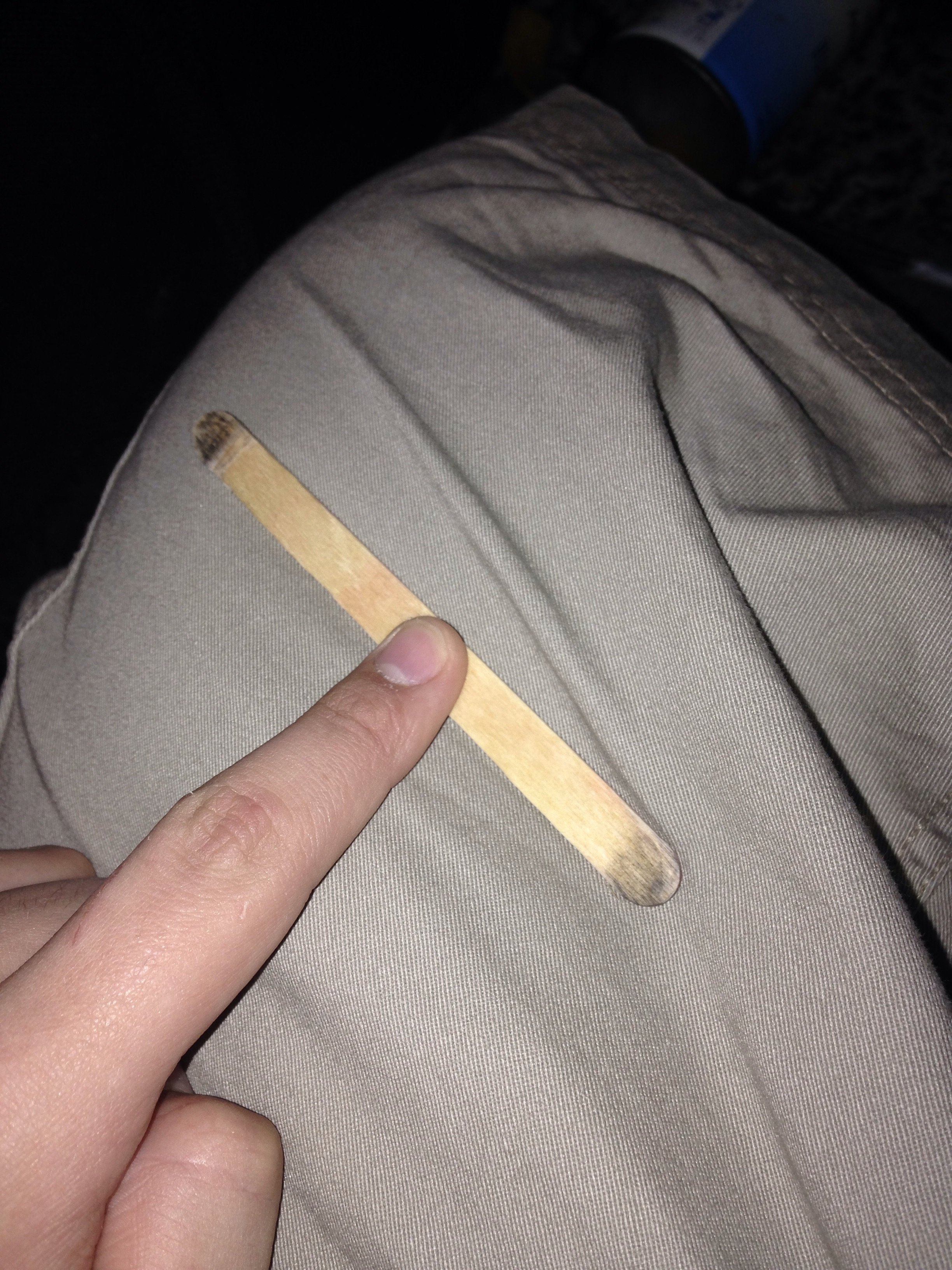

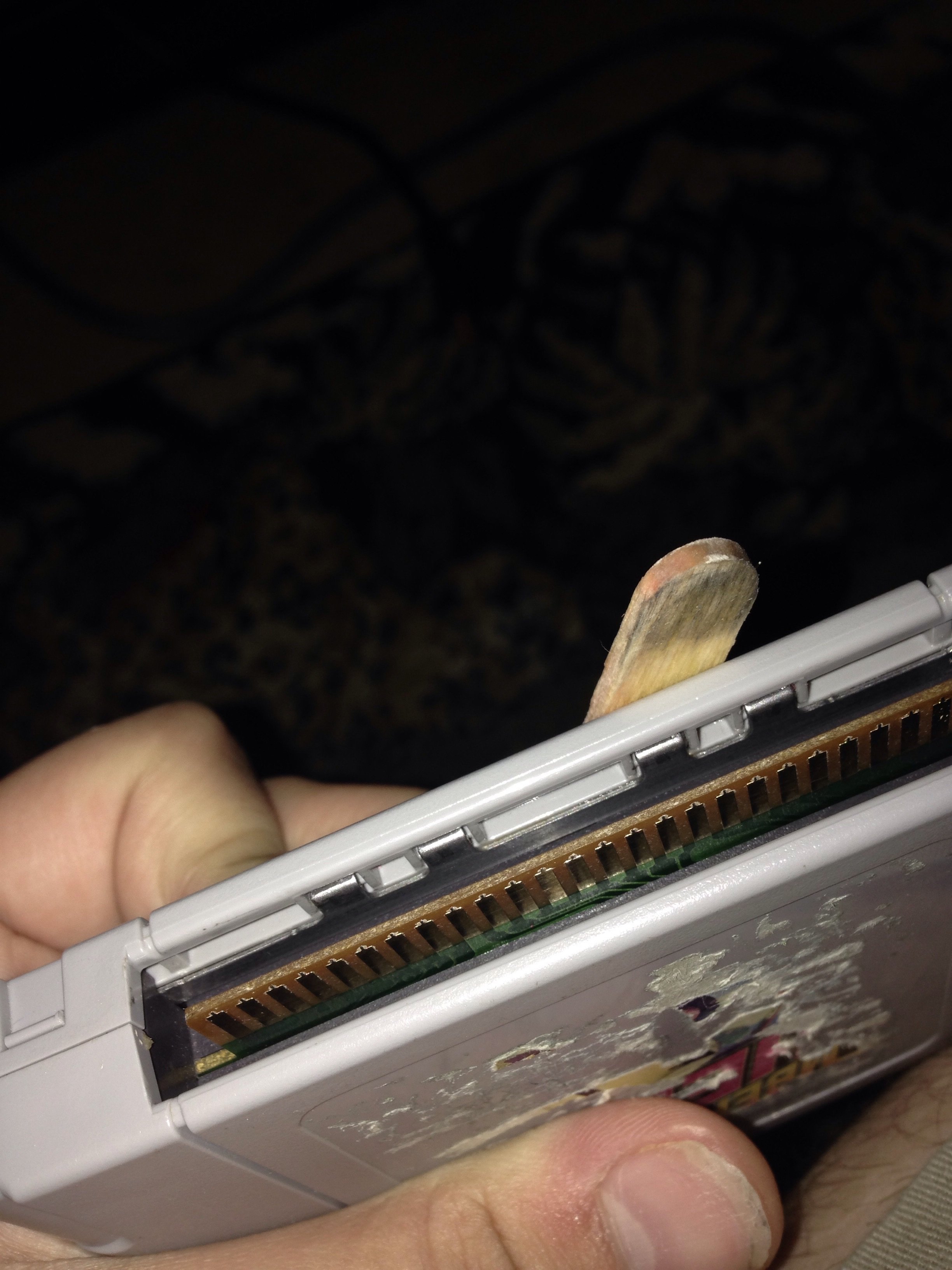

The contacts on the game aren't giving me any black spots anymore, but the metal around the inside of the cartridge has a lot of it.
Does the metal things have anything to do with how it reads?
Here's a few pics of what I mean.
The black stuff on the sticks are from the metal, not the contacts.
no the metal lining that area is shielding. The copper contacts on the PCB are what matter. But if that cart is dead, no amount of polishing them will help. Are the contacts in the console's slot clean too? If yes, then it's time to relax until you can test other carts. Also take care not to bend the contacts in the cart slot on the console. The previous reply suggested Q-tips for a reason. (I don't even use that when I need to clean contacts. There's a purpose made aerosol spray you can buy - CRC Electronics Cleaner. They sell it at WalMart.)
