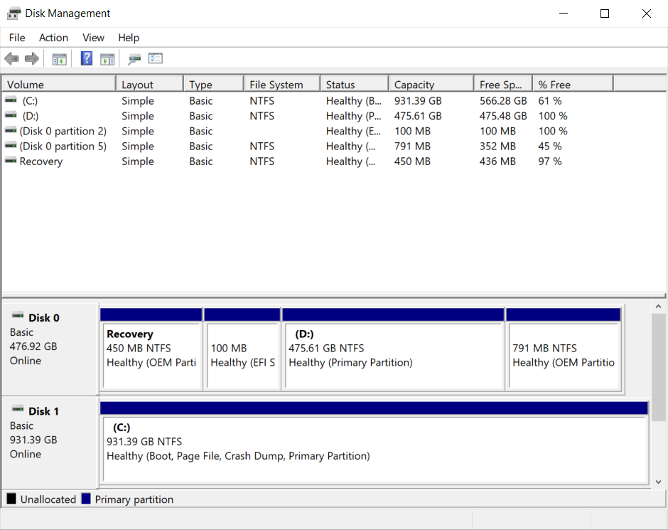

I have a laptop with two hard drives. One SSD and one magnetic disk. When I bought this laptop it came with Windows installed on the SSD. I reformatted it and Windows was magically moved to the magnetic disk. I don't like magnetic disks because they're slow and prone to the click of death. The click of death has happened to me several times before. I tried reformatting it a few more times to no avail.
I'm very reluctant to format both hard drives then install a fresh copy of Windows on the SSD. Last time I tried updating a driver myself, something broke and I had to reformat my laptop. Maybe I can backup Windows to a USB, remove the magnetic disk hard drive then reformat my laptop. Will the TPM stop something from working?
How do you recommend I proceed?

Disk 0 is the solid state drive. Drive D should contain Windows but no longer does.
Disk 1 is the magnetic disk hard drive. It currently contains windows.
Given that Disk 0 contains the recovery partitions, can I simply remove the magnetic disk hard drive from my laptop then launch the system recovery software at startup?
I tried booting Linux on this laptop before. It didn't work. Last time I tried using software to migrate Windows to the SSD it didn't work either. I don't remember the exact errors now.
I did check my manufacturer's website but sadly my laptop is a model which doesn't have proprietary system recovery software. It only has the Windows system recovery software which hasn't worked properly for me.

It looks like your system restore partition is completely wiped. Usually a system restore partition should be in the GB ranges, like 10GB to 15GB or more in size for the partition. That recovery partition is probably the Windows recovery that usually only fix the installed OS but doesn't reset the computer back to factory default. Much like taking the Windows install DVD disk and booting it off of that for repair tool to fix some unbootable Windows installs.

Ouch. Does this mean I'll have to screenshot all the information in the device manager, screenshot or write my Windows key, install a fresh copy of Windows on the SSD, then manually install each driver and hope it all works?
I finally managed to get Linux working. Turns out I needed to disable secure boot in my BIOS (this has some dangerous side effects*). Maybe I should put Linux on a super fast micro SD card and only use Windows when necessary.
* Now my laptop is vulnerable to malware which attacks the boot sector and someone with physical access to my laptop can also tamper with the boot sector.

Pretty much, although you could download all the drivers and then place them on a media that isn't going to be formatted and use it to install the drivers after Windows installs. You can search for drivers via hardware ID if you like. Windows should have most of the drivers included, mainly the manufacture specific hardware will probably needs to be downloaded. You could download drivers from the manufacture website, provided they still support your model laptop.
This is probably a stupid question, but using Linux can I copy and paste Windows from my magnetic disk hard drive to my solid state drive?
I'm not sure if Linux can write to NTFS partition, but can certainly read it. Even then, I don't think this will work, unless you can chainload the Linux bootloader to bootmgr or boot Windows directly, even then still not sure if this will work.
