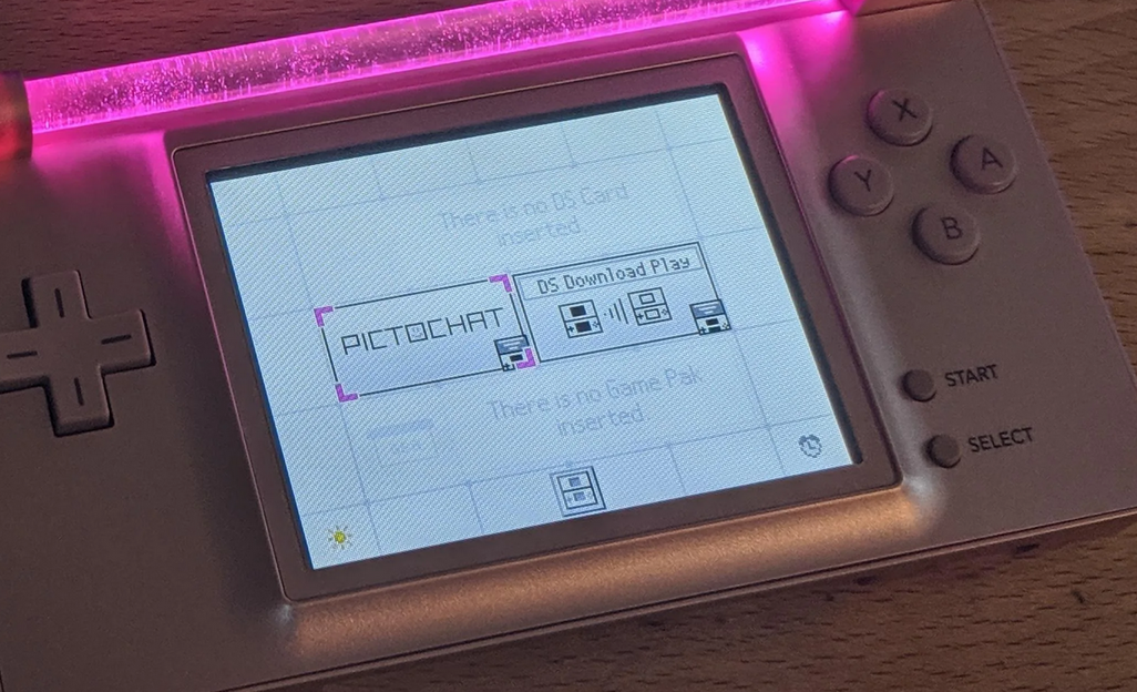

After Restart It Try To Boot To R4 But Its White Screen ..
It Boot Normal On DS Menu Without R4 ..

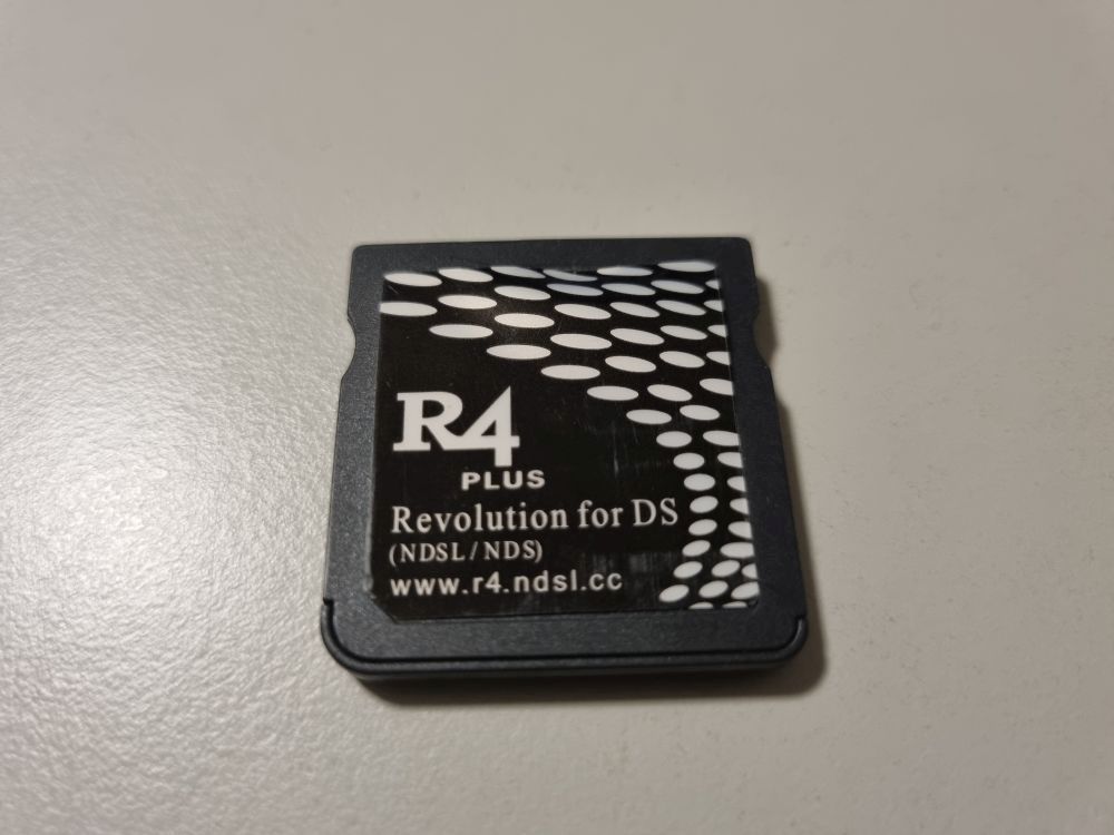

"i Insert The R4 Without Change Everythink To Other DS It Works Fine"
So The Problem Basicly Flash Me Makes Me Wont Read My R4..
i Know my R4 Its Clone .. but its There A Work Around ..

R4 Works On Other DS
When i Boot To My DS its Blank White Wich Is Ds i Installed Flash Me.
Model Its DS Lite .. :cry: :cry:
The R4 Still Works On Other DS But How Do i Make it Works On DS
