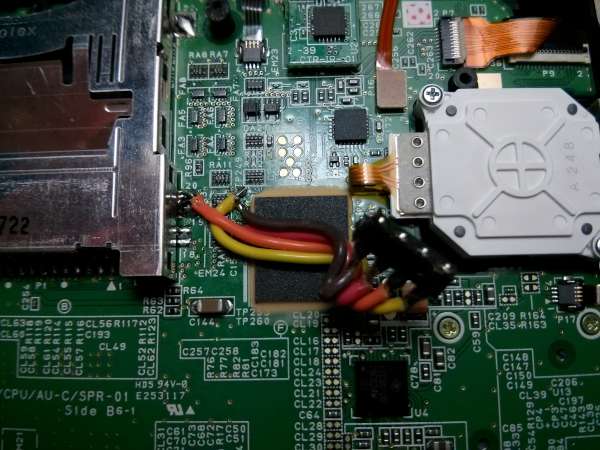

I'm a new user but I already did this mod on a friend's blue 4.5.0-10u XL. It worked flawlessly.
2013-10-16 19.07.03-600.jpg2013-10-16 19.05.55-600.jpg2013-10-16 18.57.37-600.jpg
I just bought a blue Kario Kart 7 bundle (4.3.0-10u) and I'll use Jay.T's (post #399) idea and try to attach, either a mini/micro USB or a molex connector, like he did.

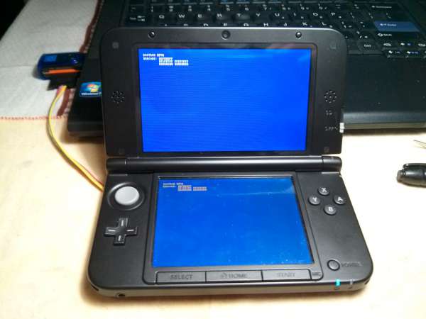

With the very same wiring, I get different errorcodes based on "how" I do the connection to the PC. I'll explain.
I use a 8 inch long shielded USB cable with 4 terminals and a female connection soldered to the console. At the other end of the cable I use a MicroSD to SD adapter. To onnect the SD part to my console I use a cheap-a$$ multi SD read stuff, china made.
If I connect everything up (cable to console, cable SD to card reader and the card reader to my PC USB) and then I turn on the 3DS, I get the errorcode 00000003. Also the read speed is 2.5MB/s at most.
If I connect the cable to the console and to the card reader, turn on the console, I get the errorcode 00000400. Then I plug the card reader to my console and the speed is also 2.5Mb/s at most
If I only connect the cable to the console and turn it on, I get the errorcode 00000020. Then I plug the rest up, but this time the speed is much faster. It's 5.3MB/s
All of the NAND dumps are the same (MD5 matches). I tested them all and they all work on my console, but indeed the read/write speed count when you're dumping 3 times to be on the safe side.

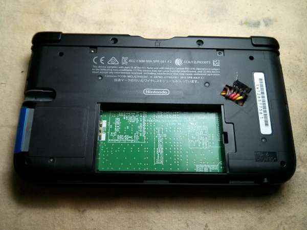

Just bought a spare Red XL on 4.4. Read out nand and also installing a 3dscapture card on main Blue XL :) :)
i am adding a female micro usb port on the internally under Select button and wiring up a microusb to SDCARD adaptor (like how capture cards are installed)
[IMG]http://optimize.ath.cx/LL-SPA3/CIMG06981.jpg
Where did you order your female micro usb port, I haven't found anything small enough to fit there.
hmmm, that is a month or more before I can get it in hand and thats just waiting on shipping from either china or the UK.
The one with the board is gonna probably cause some problems, since I would have to remove the pins to get it flush.
gonna have to mull this over how I want to handle this.
