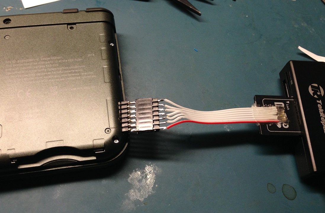

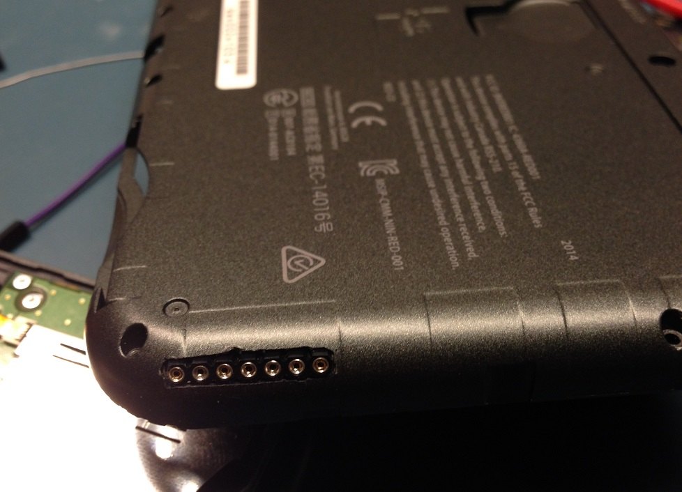

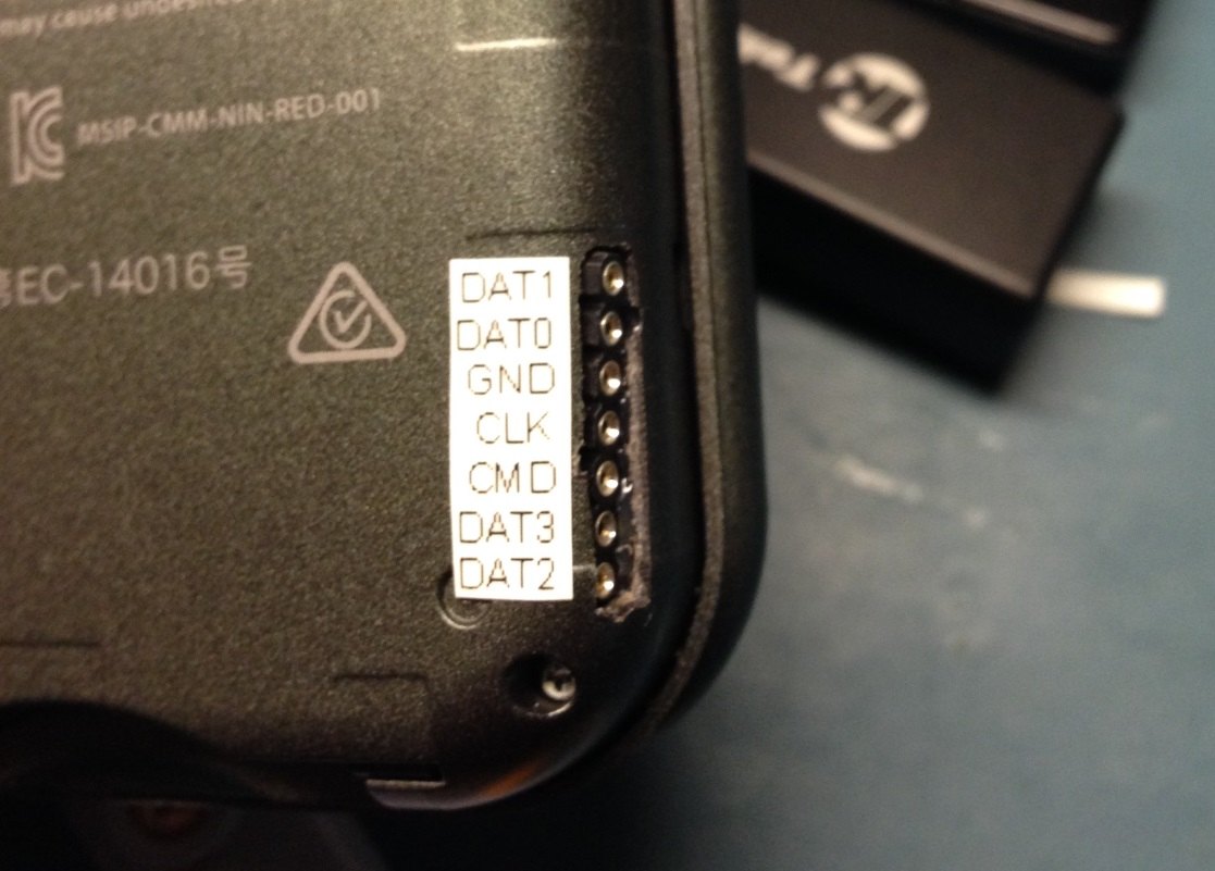

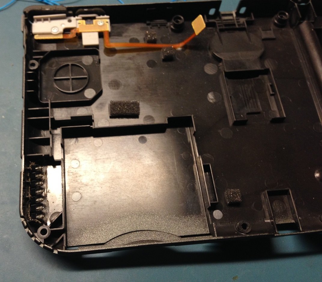

Alright so my NAND "mod" if you will is done, and it's ugly but functional, last thing I have to do is print out my label for the pins

Avalynn What was the speed difference between 4 pin and 7 pin?
Using just DAT0 / CMD / CLK and GND i was able to get around 5.5 MB/s on a trancend usb 2.0 card reader. Using all of the DAT lines i averaged around 11 MB/s on the same reader. Using a USB 3.0 TekRepublic Reader I was still hitting around 8MB/s with just one line and 21MB/s using all the DAT lines.
OK. Thank you. About the same as the original and XL version of the old 3DS. I think I'll stick with 4 pin as they are smaller and easier to keep looking nice.

Did you mean to leave the CMD label out/off of the last picture?
No lol you're right, thank you. I think i've been at this for too long! almost a day and a half now.
I had my N3DS for 5 mins then I decided to take the whole thing about apart and stare at the shiny insides. I'm updating that photo and label.
gamesquest1
So I updated the first post hopefully with an easier to follow picture, with 80% more color! hehe Hope it helps others too.
