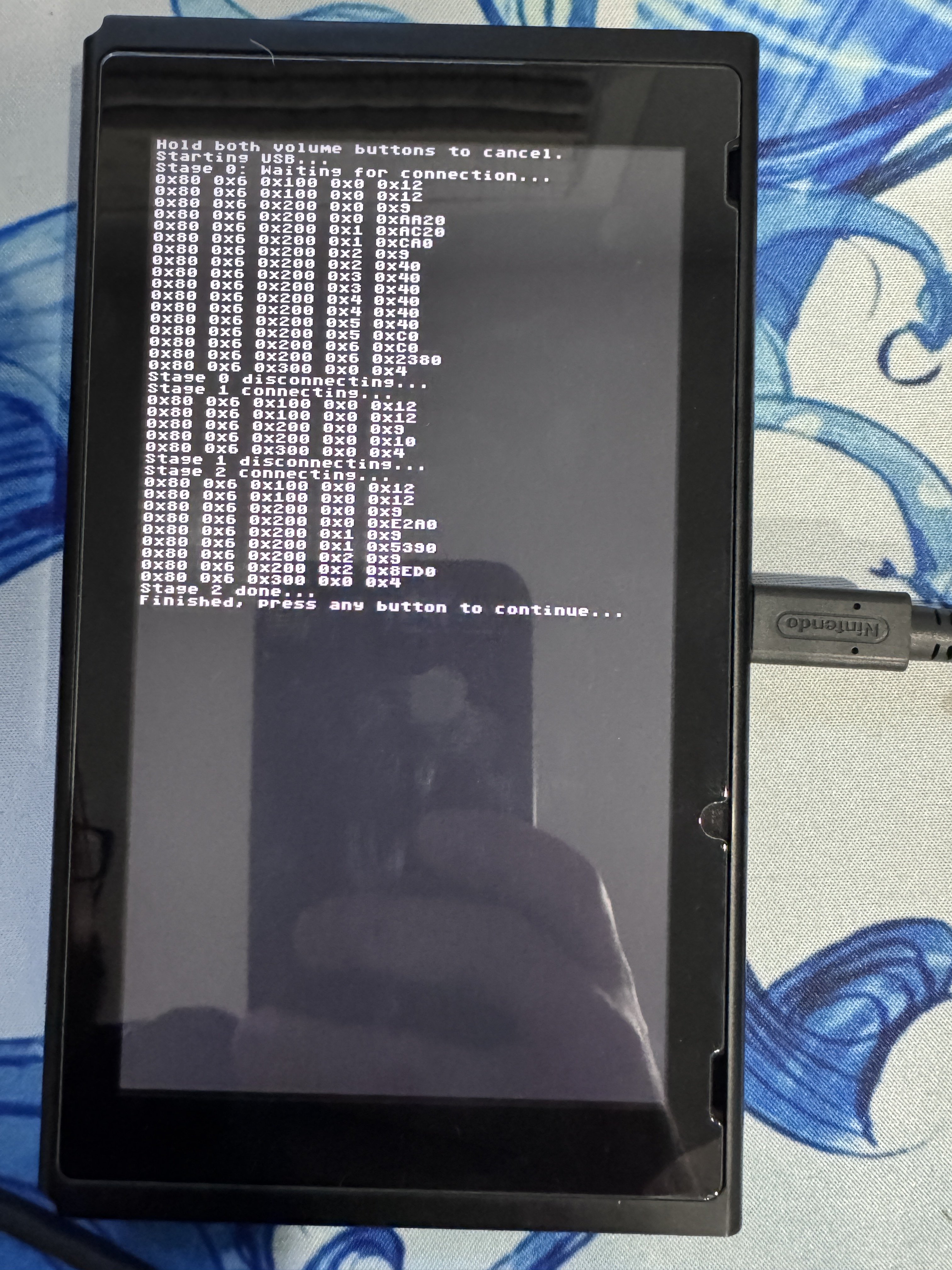

Basically I am at the point where I need to boot back to the recovery menu and run the wupserver to repair any of the corruption. The problem is I can not longer get the recovery menu to load. The WiiU turns on, I get a blue light, the fan turns on and the drive does what it does when the console turns on, but I get no video at all on HDMI or composite. The gamepad is also no longer synced. I also did not install ISFShax
I also am using my unpatched switch so that I can see if it's actually trying to do anything. It looks like it is. One is of the switch screen and there others are of the nand-aid install. Screen shot shows what is on my Switch scree when I try to boot the recovery menu. I can post pics of the install and the logs I was able to get when I made the backup if needed.
