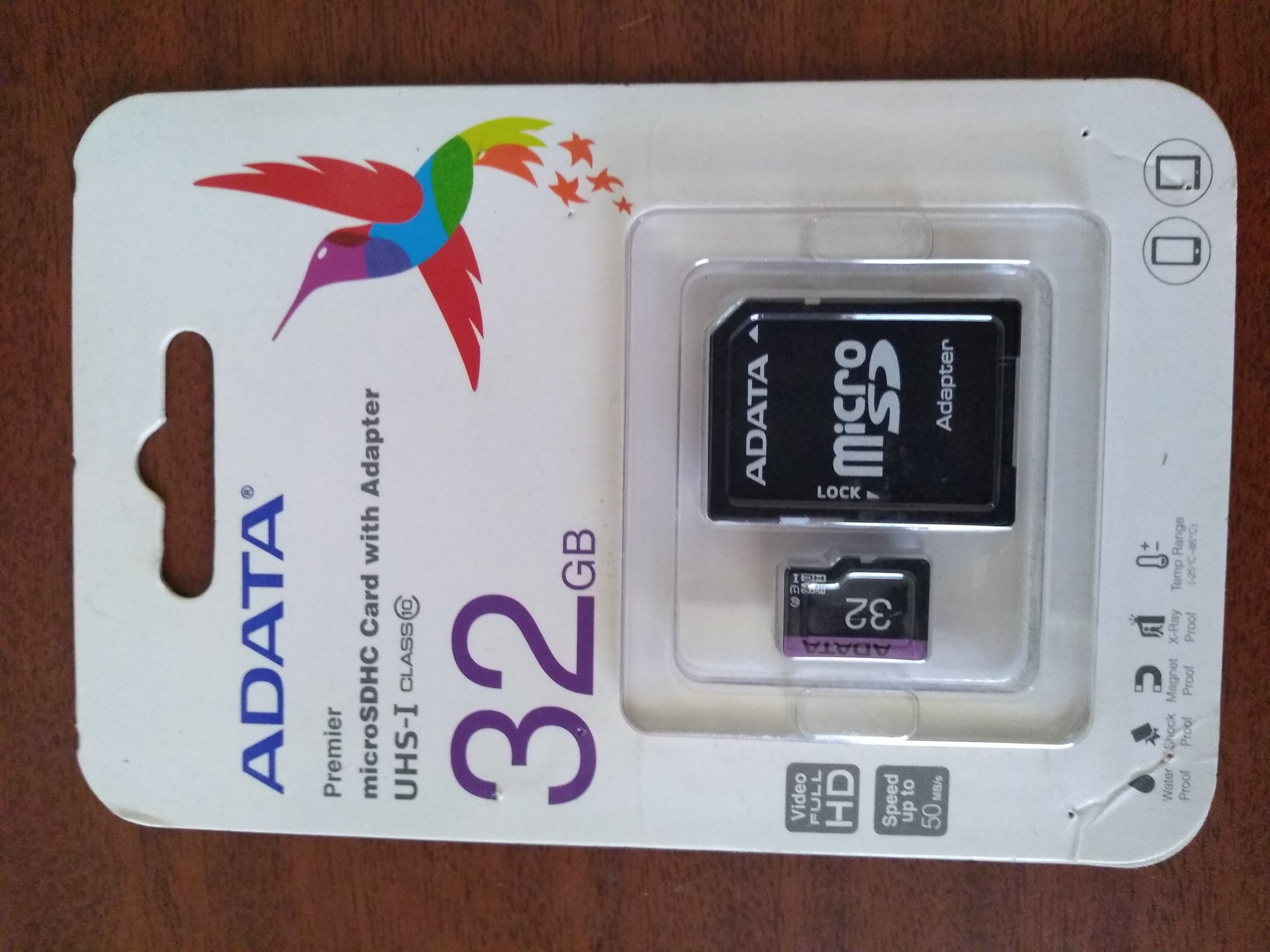

Ok, so I went out today, and searched for a different brand MicroSD card. Unfortunately, I wasn't able to find a Samsung or Sandisk MicroSD card. However, I found a 32Gb ADATA card.

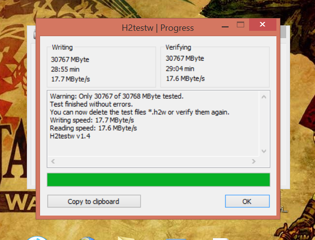

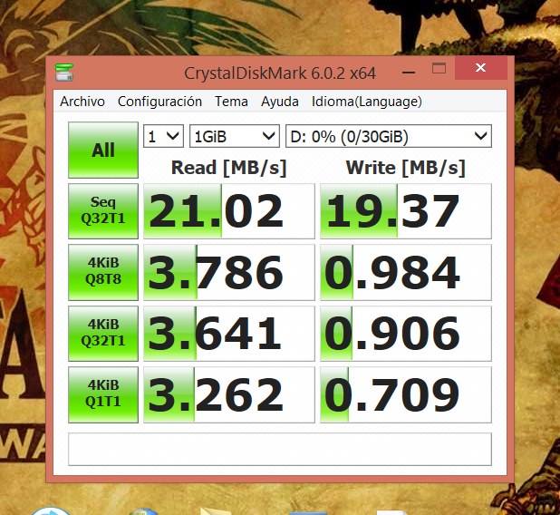

I formatted the card with SD Card Formatter and Windows File Explorer, and then ran H2testw and CrystalDiskMark on it. Here are the results. Oh, and it didn't get way too hot so I guess it's ok about that.

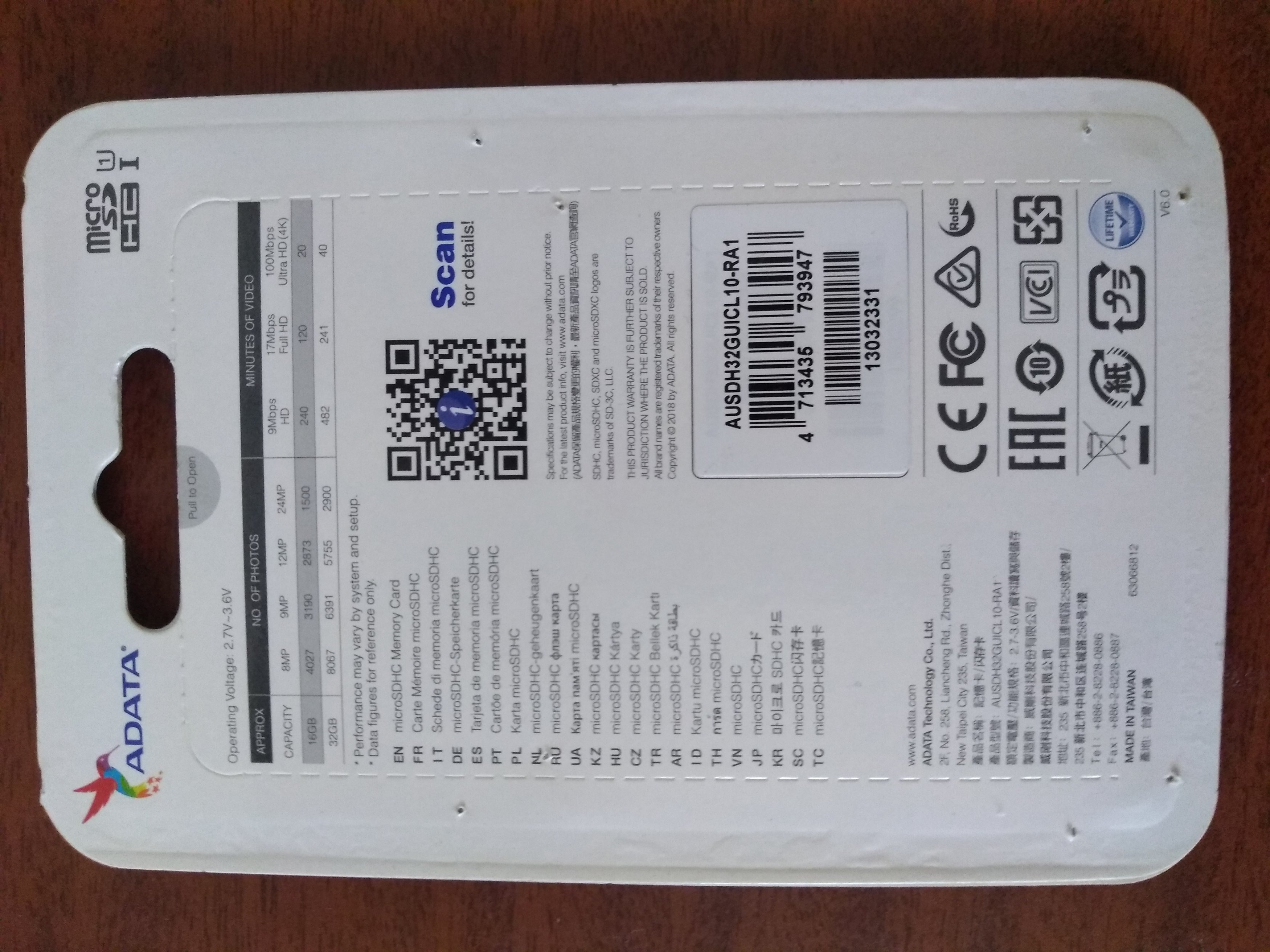

I might not be an expert on this stuff but it seems strange to me that it got so low on reading/writing when it said that it had a speed of up to 50Mb per second. However, I'm pretty sure that it's an original one since I compared the read/write speeds on this card with the results obtained by other people and they are the same.

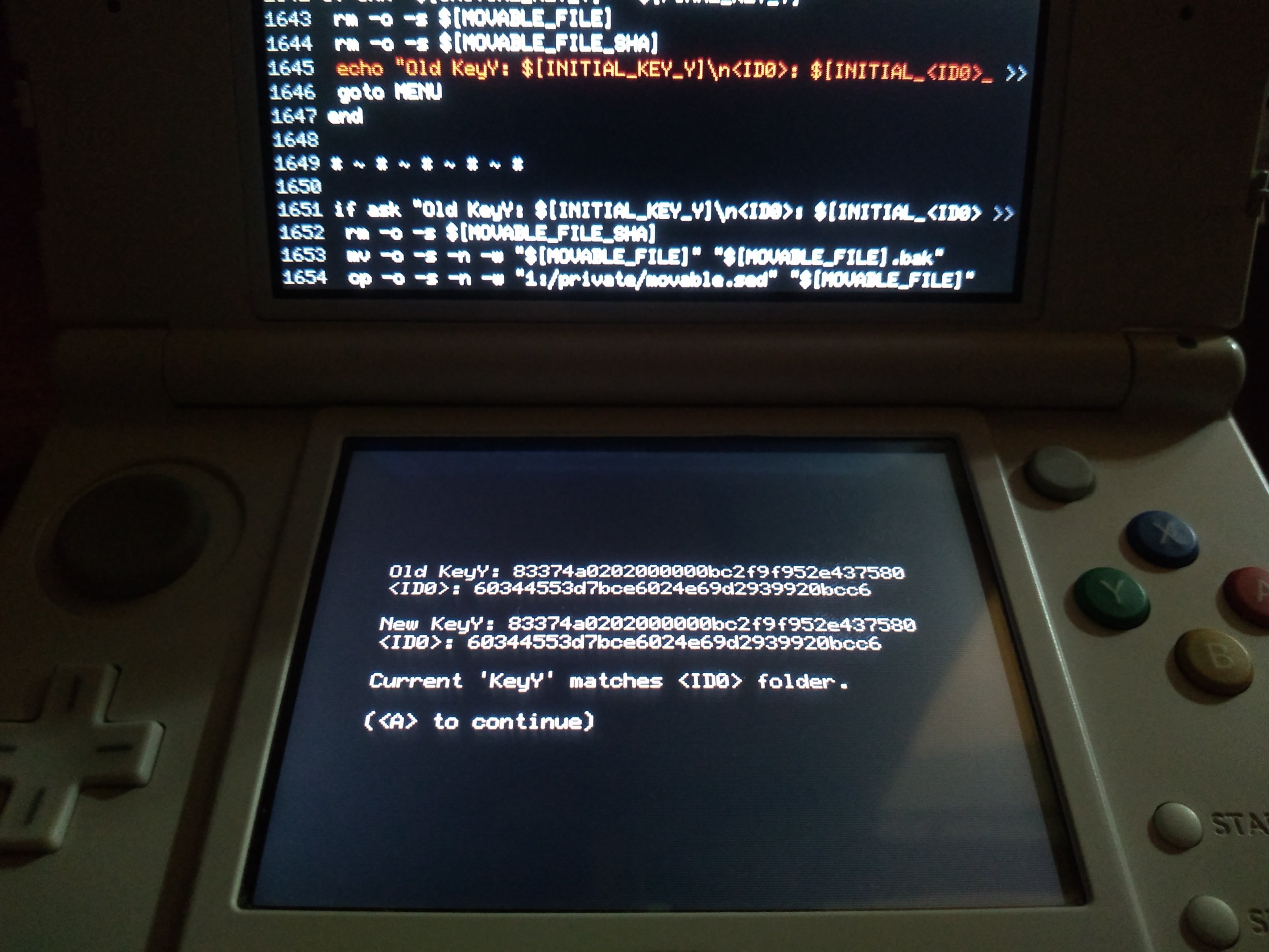

I just ran the "Fix KeyY" script on CTRTransfer D9. Using the New ADATA Sd card it worked! Here are the results.
Now that it completed that successfully, I believe I should run the "Rebuild 3DS database" script, but, what should I select on there? Option "A" (Quick) or Option "B" (Full)?

That looks to be an authentic ADATA Premier series SD card.
Your write speed of ~20 MB/s is well over the expected Class 10.
Speed up to 50 MB (megabytes) per second most likely refers to read speeds under ideal setup. Your read speed of ~21 MB/s for a 1 GB test file is kinda low; this can be explained if you have an older computer that has an SD card reader with a slow bus speed.
Your card should be plenty fast for the n3DS.

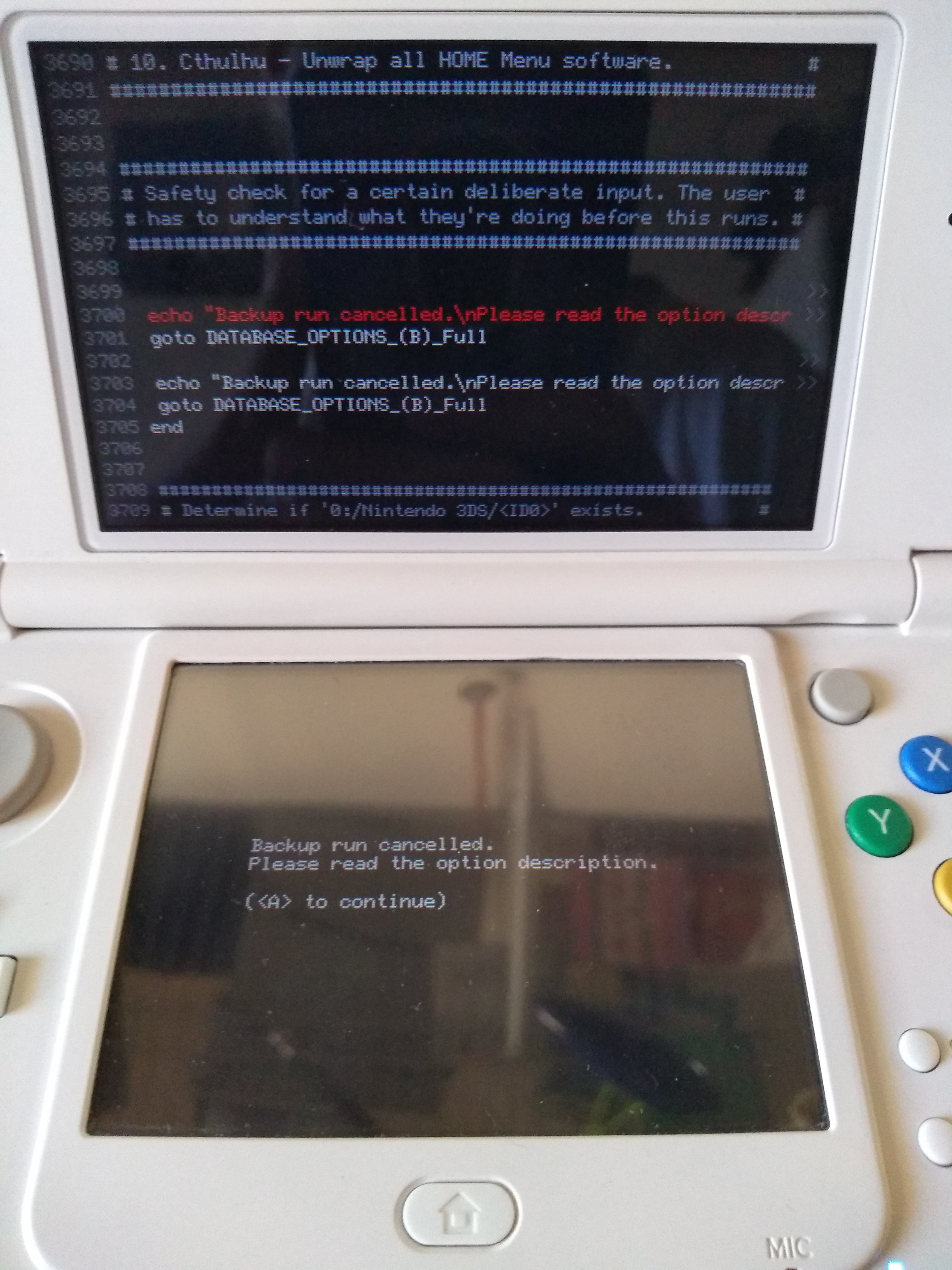

Alright, I tried to run 1b and it gave the error shown on the image :unsure:

As demonstrated firsthand, the safety mechanism worked exactly as intended.
The person who originally started this thread and used the Option (B) also ran into this back in Page 1.
Now that you read both descriptions and instructions, you should have no problem understanding why it's like that and what to do to get (1b) to run.

You read the description but didn't catch it all. :/
As was already pointed out earlier,
... "NOTE: to prevent unintentional misuse, the user is tasked in removing 'import.db' & 'title.db' from '0:/Nintendo 3DS/<ID0>/<ID1>/dbs'."

Oh, ok. I'll delete those files and try again
I just tried that out but it turns out the SD card doesn't have 4Gb of free space. It has 3,96 :rofl:
