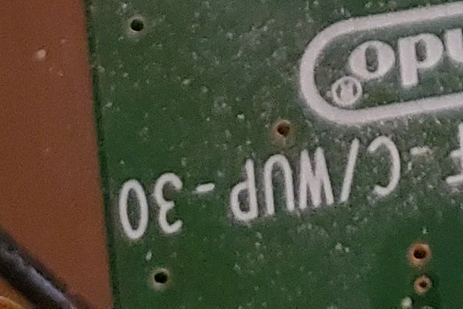

Which PCB board revision does your Wii U have?
That's a very important thing to take into consideration when we see components "missing".
Board revisions exist because engineers try to improve the board and/or fix issues and many times that means some components are removed entirely or just moved over to another area.

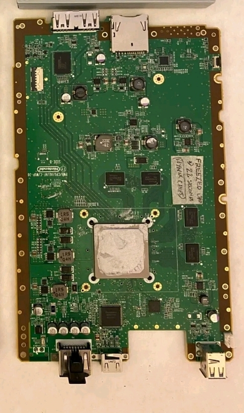

From a WUP-30 I found this bigger picture on Discord (credits to @Lazr1026 ) :
This picture allows us to track the traces to the SoC:
So yea, for me it looks like these parts where some kind of ESD or inrush current protection Nintendo figured isn't important as nobody plugs the disc drive while it's in use anyway. So they simply removed them. I'm also no expert through.

So why are you searching for C157-C160 when they say the problem is CM9 and/or CM10 and these are clearly visible on your WUP-30 board? Just go ahead and follow the post you linked by checking and replacing these if needed, like they did in the thread you linked:
