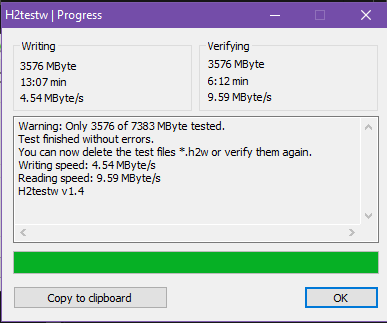

This is what the app shows me:

While this looks good on first glance I still think the SD card is the issue. Could you remove all files and folders from the card (ofc. take a backup before and restore it afterwards) and then repeat the H2testw test, please? Just so it tests the whole card instead of just 3.5 GB.
And yes, this new test might take hours or even days to complete. Really sorry for asking you to do that but I guess both of us want to get the root of this issue?
