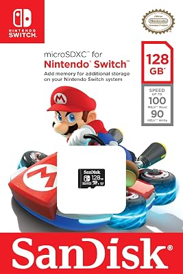

Now, if you're talking about those Nintendo licensed SD cards with partnership with SanDisk like this:
At this moment, you're probably not going to encounter any of these as fakes, but this can quickly change if the counterfeiters believe there's incentive to chase and undercut this market. You pay a premium for the Nintendo name and quality label, but don't count on those alone. H2testw check every newly purchased card anyhow, not only for fakes but the small off chance your card has defects. <-Save yourself the heartbreak from this source of data corruption.
