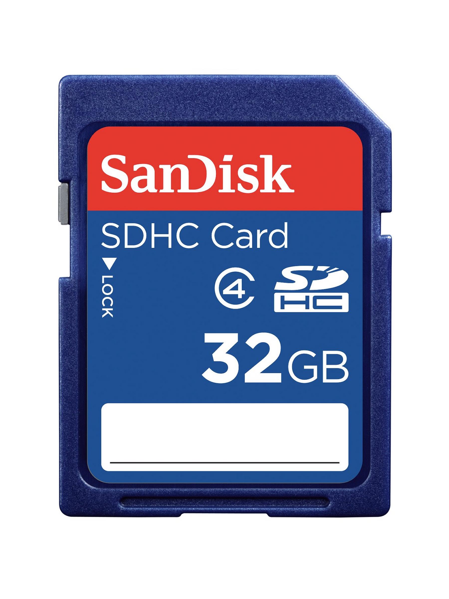

So i ordered this sd card and I'm hoping that it works in the 2ds I heard I have to make sure that all cards are formatted in fat32 so the sd can recognise the card itself
In still a little confused about how to back up all the stuff on my current SD like the NANDs and move everything over to the new SD card without having to go through installing CFW all over again
Use the 3DS Multi emuNAND creator to back up your emuNAND, inject it into the new SD card and move all the files over from one SD card to the other. That's all you have to do.
