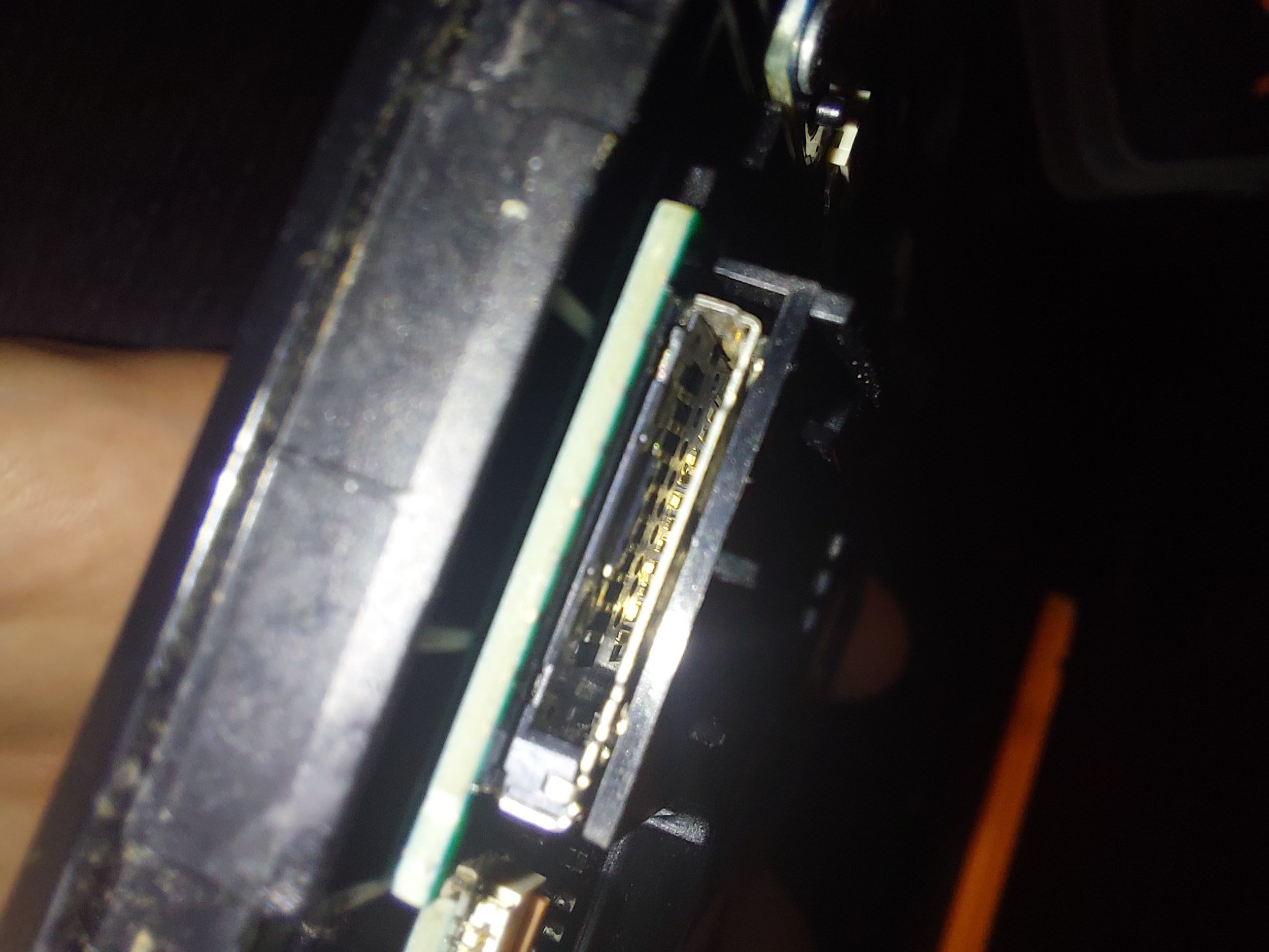

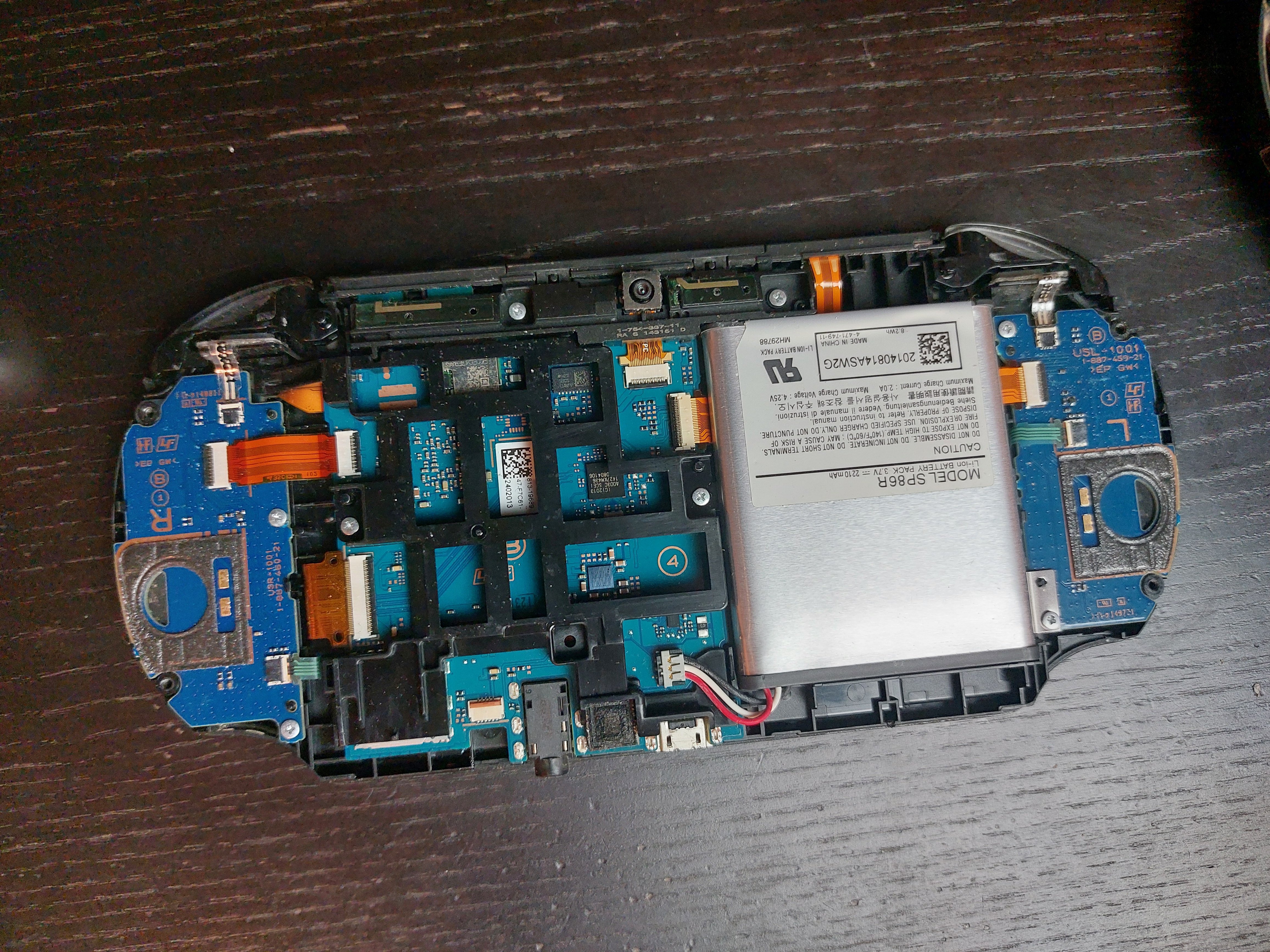

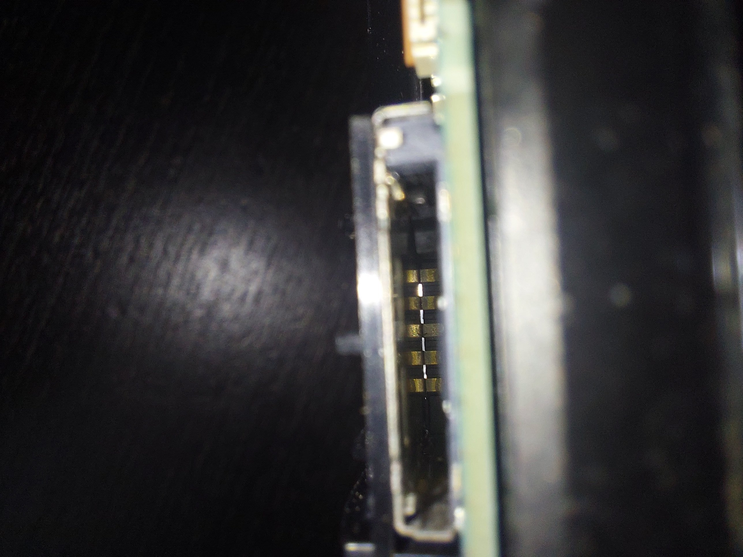

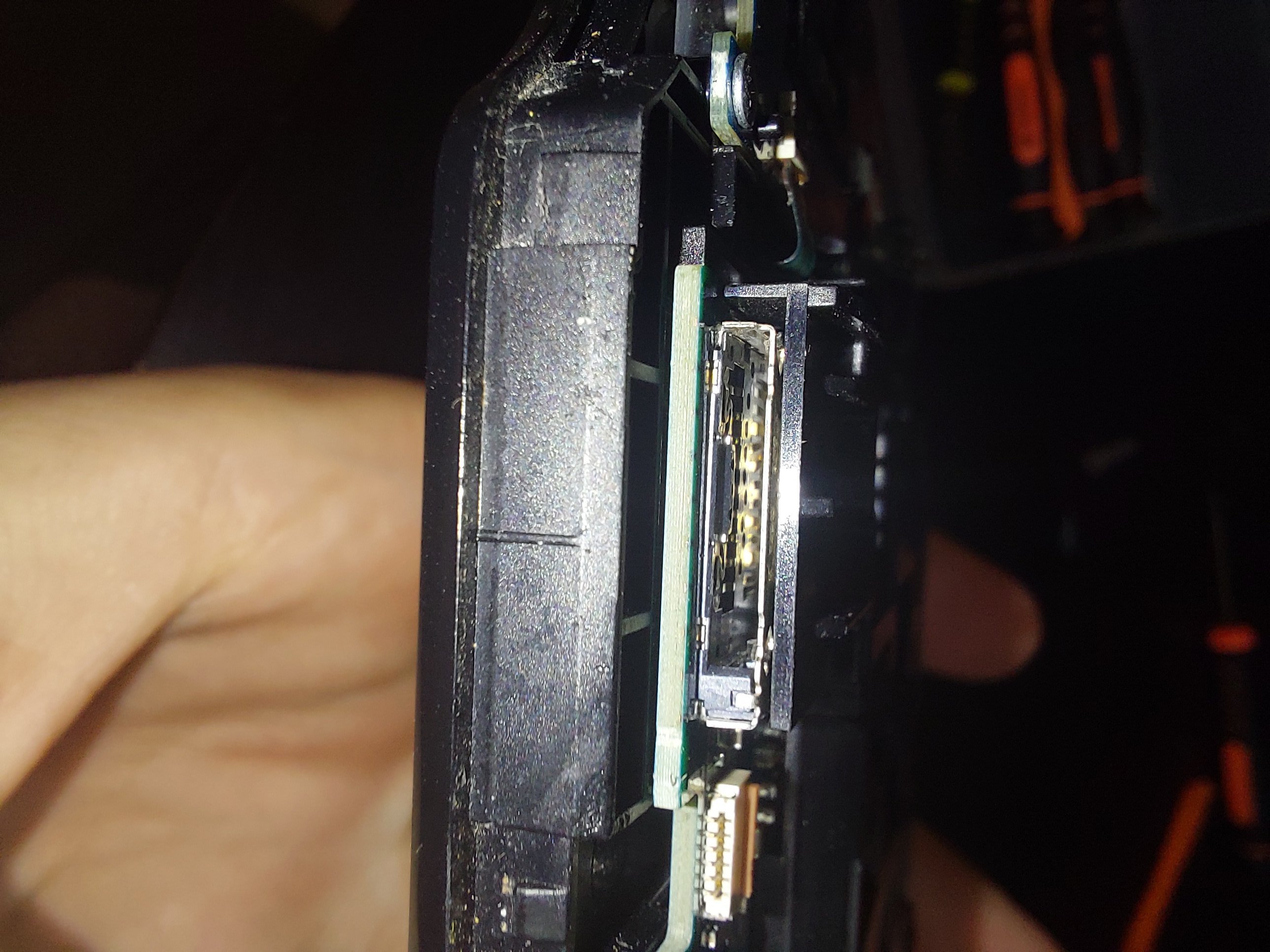

Update: today I took a picture of my ps vita and tried to take pictures of inside the memory card slot, I couldn't see anything that could hint at what the issue is and I don't know how chznging the joysticks could have messed with it but idk, any idea?

Hi Clemp, looking above, it seems like all of the errors and whatnot are all related to physical activity in your console, like:
Putting in a game
Putting in a memory card
Launching a game
etc...
Clemp, I'm assuming that NONE OF YOUR GAME WORK, CORRECT?
It may very well be that your memory card is faulty, I'd nab another one off of eBay (or your store of choice, of course), and see if that doesn't solve your problem. If it does, GREAT! If it doesn't, something comes to mind.
Here's a question for you: How are the DIGITAL functions of your PS Vita working? Can you save images to your Vita from your PC (or Mac or Linux or whatever)? Can you transfer images from your Vita to your PC? Can you use those images as a system wallpaper (forget about resizing the image, we're just looking to see if your Vita can do the normal things). Can you transfer .mp4 videos to and from your Vita? Can you transfer music to and from your Vita, and finally, do the images, videos and music work on your Vita without hiccups or errors?
If that is the case (but try a new memory card first), HACKIN YOUR VITA may be the best route to go. Here's why:
The hack means that you can use an SD2Vita as a memory card that is designed to work WITH the Vita Henlo/Henkaku/Enso hack, so that all of your interaction with your Vita (minus the SD2Vita of course) is all DIGITAL. You'll never need another memory card again, nor even your current card.
So I guess at this point we need to determine is whether or not your game slot works or if there is something wrong with it PHYSICALY. Is there any chance you can get a hold of a memory card quickly, so we can rule the idea of a corrupt card out? Finally, do you have some way you can "test" the cartridge slot out, maybe TRY ALL OF YOUR GAMES, or just get one cheap to rule that out?
I'd be willing to bet that if you threw an SD2Vita in that thing even when it's not hacked would give you an error of SOME KIND. What we're trying to do is to make sure that the cartridge slot is NOT DAMAGED.
