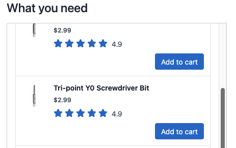

could you screenshot the ones that i'll need? as I'm kinda confused on which to get tbh unless i missed something.

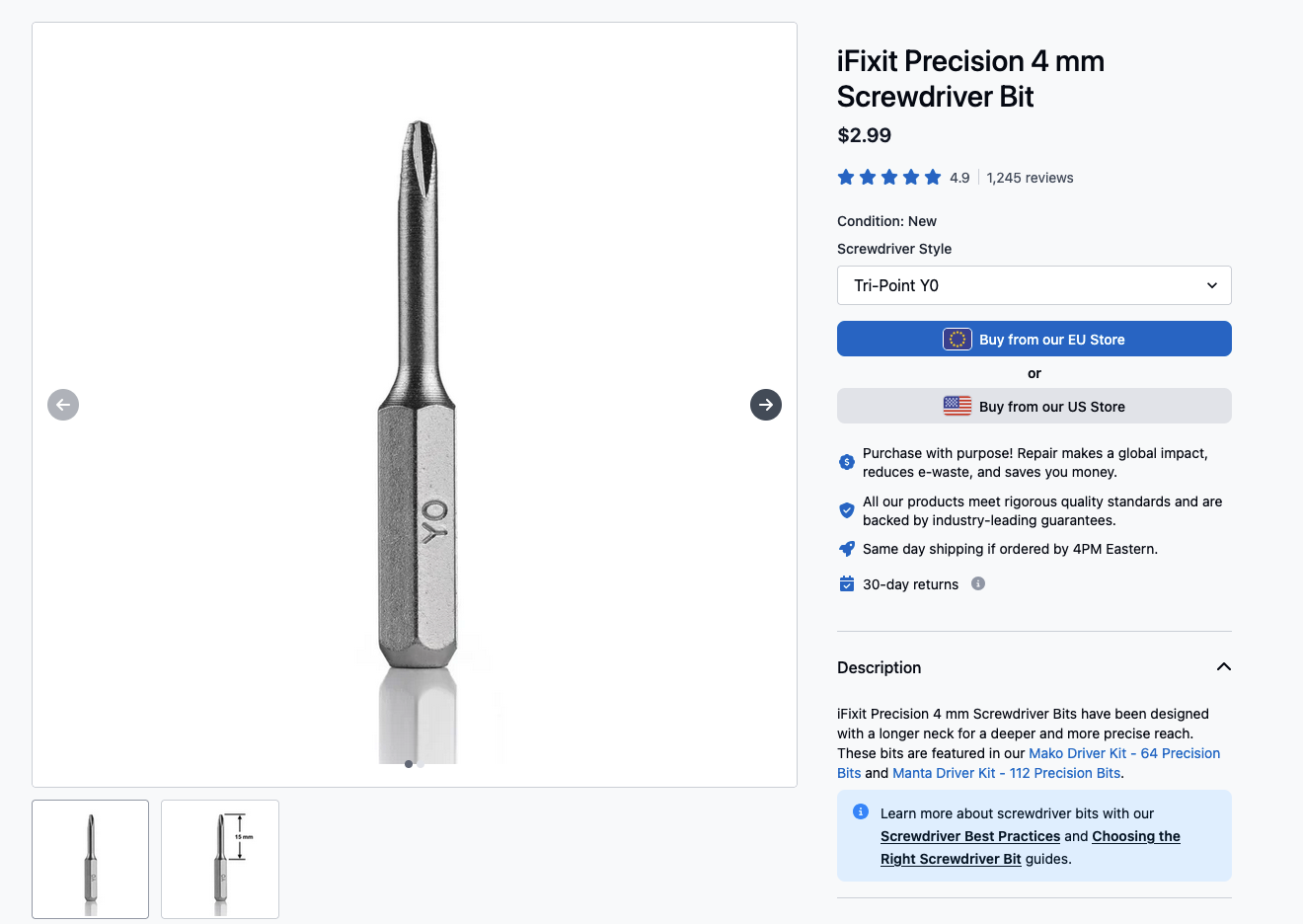

Are you on a phone? On computer it renders in the mid-upper-right hand side of the web page. The tri-point Y0 is the critical one:
