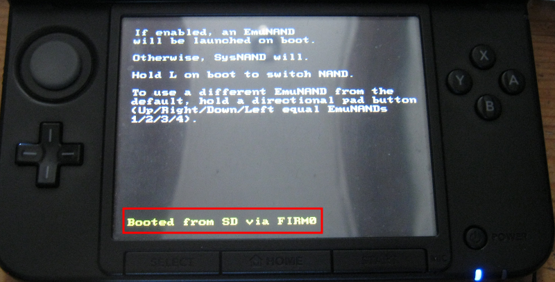

I have a problem with an Old3DS XL. It's from a cousin, and his parents installed B9S about a year ago. It has luma 9.1 installed, and I want to update it, but something happens to it that I have never seen before.
Normally, if luma is copied into sysnand, and you power on the console without SD, luma loads from sysnand. But if SD is inserted, luma loads from SD. That's not happening here. Luma ONLY and ALWAYS load from sysnand.
When the 3DS is on the menu, games from the SD appears, so SD is been read. I manage to load GodMode9, in order to see if there are luma files inside CTRNAND\rw folder, and files are there. In fact, I updated them to latest luma release. But when you power on the 3DS, luma 9.1 appears again.
I don't know from where it is loaded, I searched in every folder inside nand but no clue, I don't understand it.

But I can tell that I manually update boot.firm to the root of CTRNAND, 182kb, and the luma folder with payloads, etc. But it didn't matter, luma was still loading from sysnand instead from SD (at the bottom of the screen it was: "CTRNAND from B9S" or something like that, not from SD), and I tryed to erase the config file, but when I reboot, the config screen didn't popup.

If your 3DS has neither boot9strap or fastboo3ds, the last possible explanation for Luma3DS always booting from CTRNAND is that your cousin installed Luma3DS directly to FIRM0 and/or FIRM1. *
* See the post below.​
Luma can detect that as well and should not write Booted from CTRNAND via B9S in this case.
