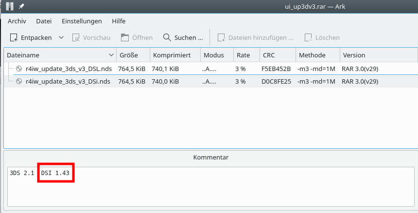

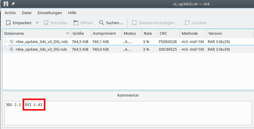

  • I have downloaded the file under R4i fw update for 3DS 2.1 on the r4ultra homepage and got this comment showing in my archive manager (so maybe it works for 1.4.3E – but do not update the DSi!):
For reference because @JaapDaniels mentioned this to be an AceKard clone: https://wiki.gbatemp.net/wiki/Updating_the_AK2i_Bootloader
I have no idea if flashing an official Acekard 2i update (which go up to 1.4.4) would brick the cart and I personally would only try the one from r4ultra.com
