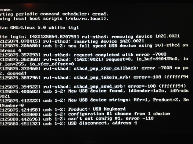

ok so I can't get my keyboard to work (usb debug attached) BUT!!! all 4 usb are accessible to the vwii in Linux. I'm thinking that's weird. I can plug a keyboard into each port, and while it does not WORK, I can see syslog noticing it and attempting to load drivers.
I followed the process that I linked to in our pm. 'white linux' theres 2 i's but autocorrect wont let me misspell it
