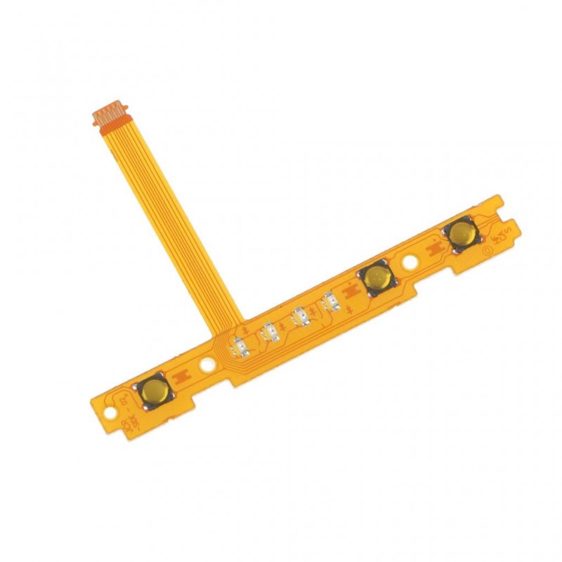

I had the same problem. I had to change the ribbon flex cable of the joycon to fix the sync issue. Be sure to get the correct ones (left joycon or right joycon)
I had this issue also! I got flex cables from AliExpress for like $3 to fix it
