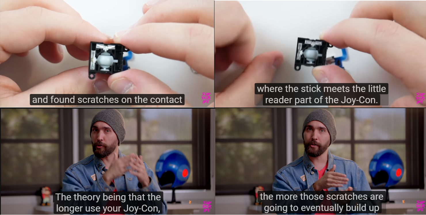

what i meant is that maybe there's a physical defect causing it and just cleaning it doesnt help, i watched about it on a kevin kenson video
correct, if its the standard problem caused by wear off, you can only replace the stick itself and prepare yourself to swap the unit again from time to time
