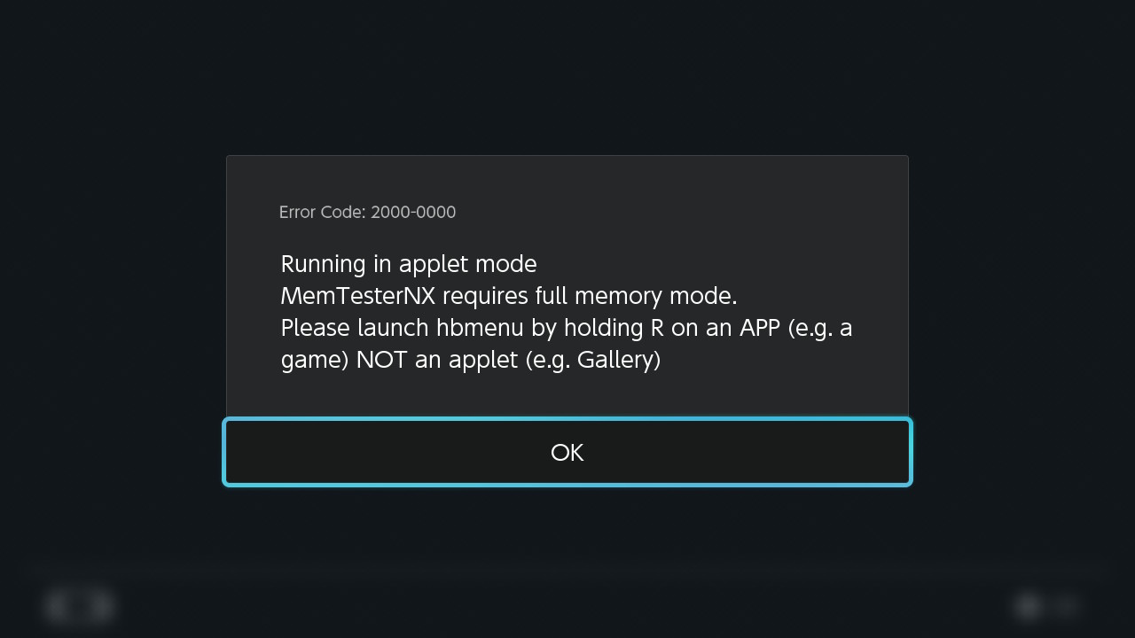

Maybe see what the programs posted here do, for good measure: https://gbatemp.net/threads/ram-memory-test-utility-for-switch.630805/post-10125991
Two posts after that, someone said one of the tests passed, but the other test showed a stuck address, so use both.
All I can say is to do it that way then. I just tried a fresh build, which is 14 commits beyond the latest release, and it still works in applet mode, without messing with the .cfg file first. Except now, it just warns me that it's in applet mode, and that certain functions will not work, and the title up top, right next to "JKSV" says "APPLET MODE" in a bold red font. No crash. I wonder if you would crash running skyrim with hi-res mods... it's almost as if one of your ram chips are faulty.
Honestly, this thread is cluttered enough and it's time I get to sleep. Sorry I couldn't find a better answer for you.
@urherenow ,this also doesn't work in applet mode
i don't understand how you can get the apps to work directly.
@Hayato213 ,can i ask you a question:does the use of RAM increase based on the OFW&CFW updates?
No, system update might increase the internal storage space usage. In applet mode you don't have access to as much memory as full ram mode, so certain homebrew applications might not run well.
