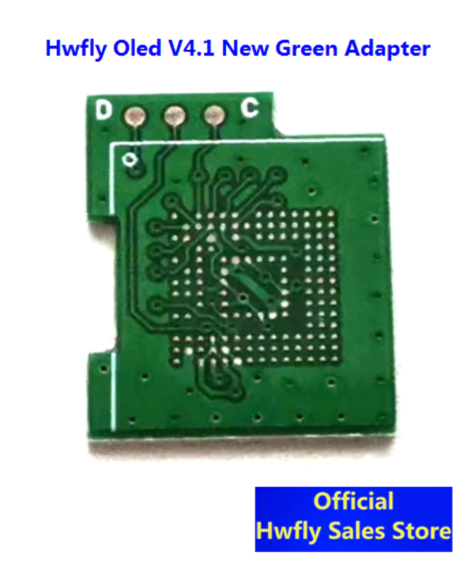

Are most people really lifting their emmc to fit the new dat0 board?
IMO friction fit should be secure enough, if it's installed properly. I've done like 20 installs on oled by now and only have to rework on 2 consoles. Also you don't have to completely remove the emmc chip to solder the adapter, apply some low temperature solder to the contact on the adapter then reflow the emmc chip, that should solder the adapter to dat0 solder ball. sthetix made a video about reflowing the emmc chip, you can check his video for more information.
damn those emmc adapters looks scary, but probably the best option
I think that green adapter is a total flop, they don't sell it in their taobao website anymore. Would be a fun experience trying to solder that thing in with bga on both sides. They only sell it on aliexpress now so I guess they are just clearing their stock. The purple adapter with the stupid ribbon cable is from another seller on taobao.
