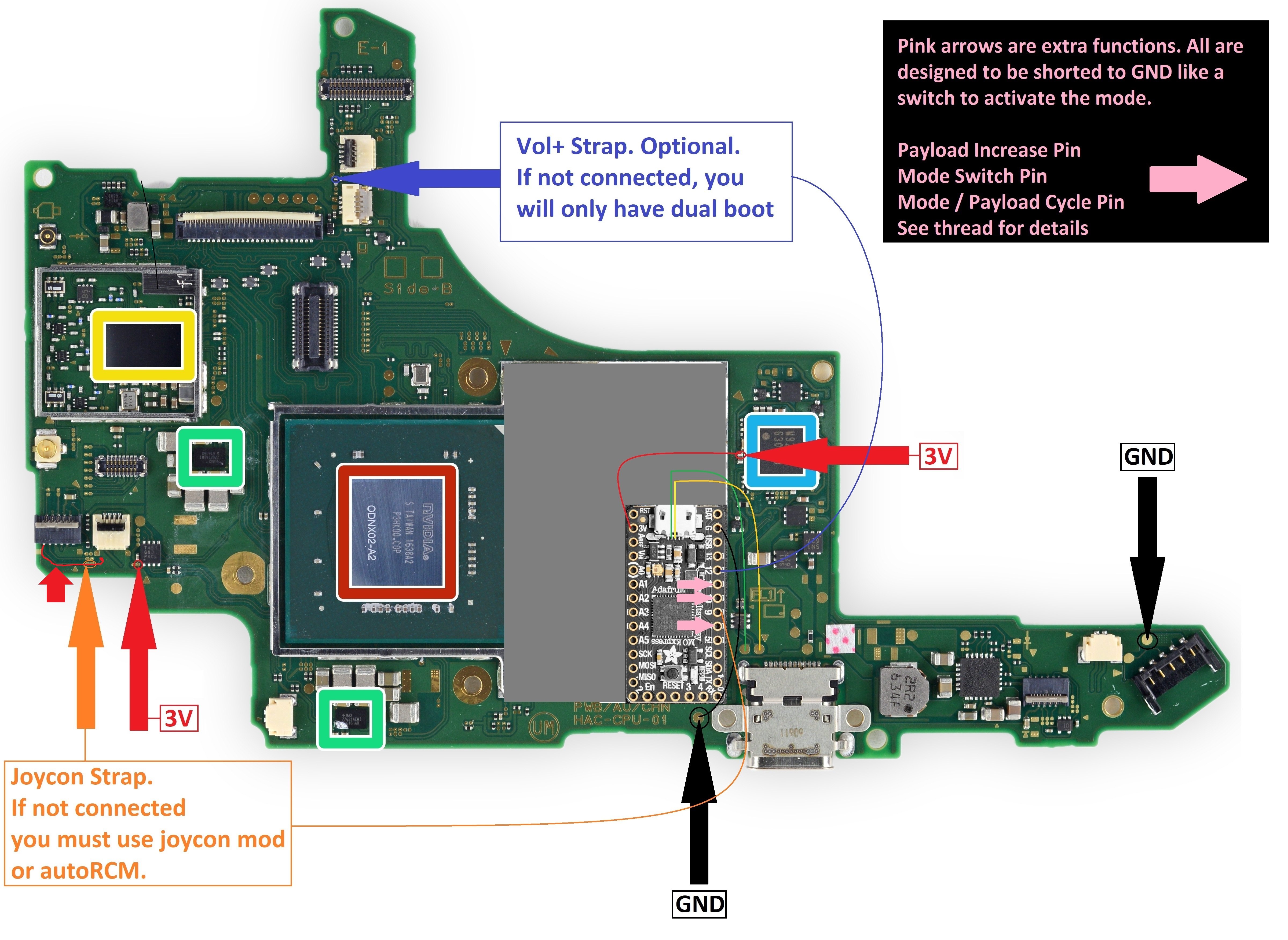

Section 3. Fitting modchip to your Switch.
New Universal Method. All SAMD-based internal chips. If your chip is not supported and you cannot work it out, PM me.
Trinket M0.
Solder as laid out in the following picture
Rebug SwitchME M0. Use Trinket files.
RCMX86 - Internal modchip version.
Gemma M0. Use Gemma files.
ItsyBitsy M0 Express. Use ItsyBitsy files.
Feather M0 Express. Use Feather files.

Alternative Solder Points
Credit to @consolex for original pic. I`ve added alternative points to solder to:
Credit to @pyorin for this much tidier version showing the same info as the above one!
